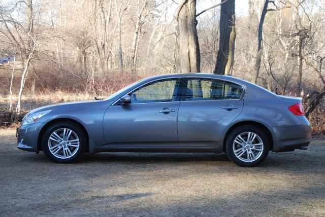

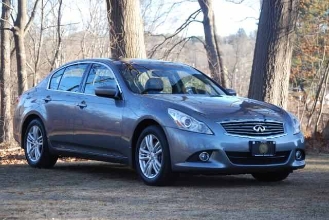

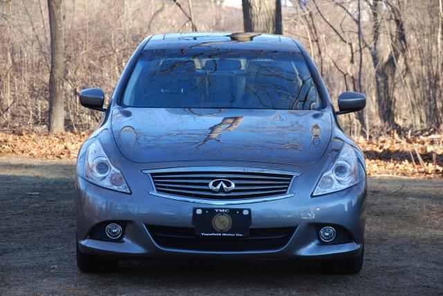

Ok guys how is every body doing I'm new to this forum and need some advice, I just got my self my first 2011 infiniti g37x sedan, I'm looking into lowering and putting some 19's the question is wich type of tires would be best for the rims and if I should go with lowering springs or with coilovers. If guys can provide pic's of your rides that be great..
Here are some pics of my ride stock....
