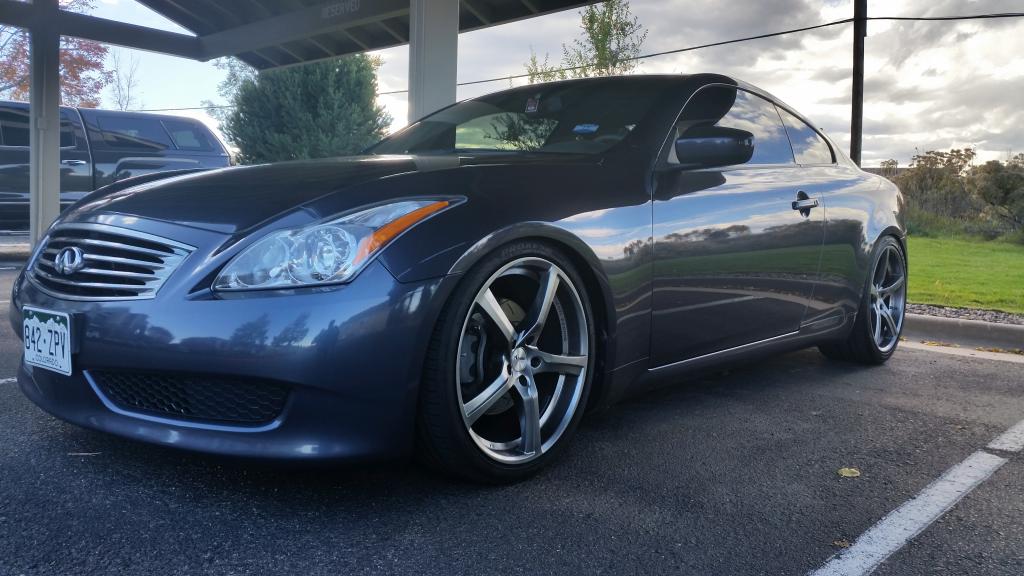

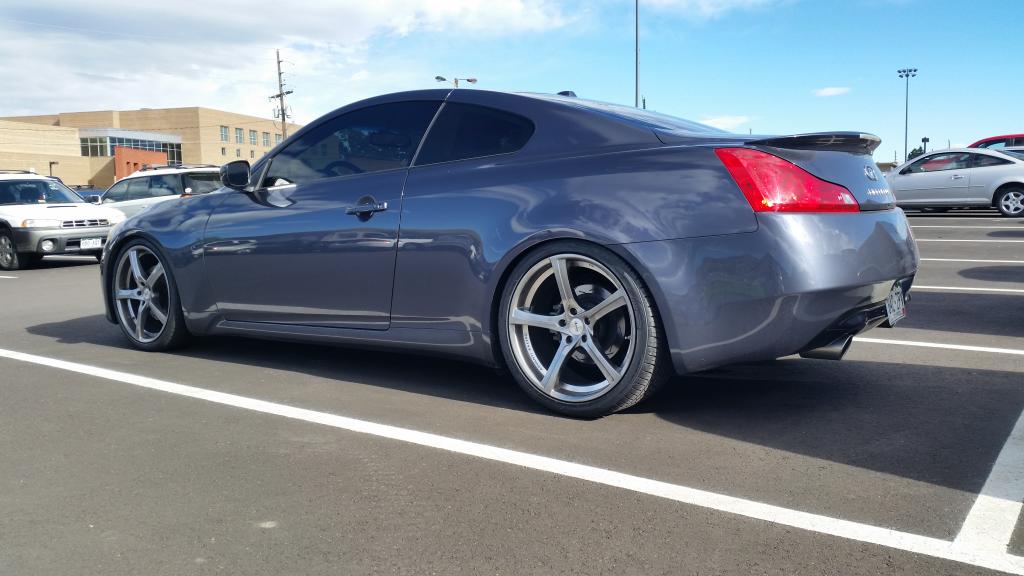

Yeah, that first setup I listed w/ the 8.5/9.5" rims would be the safest approach, the 9.5/10.5 will be very close in back, but a 275 on a 10.5" is still considered a standard mount. FWIW here's a 8.5 +35 on 245s (20") and 10" +35 running wide 295s so the 10.5 +32 would stick out 8mm w/ the rim but the tires would be narrower for essentially the same clearance inside the fender edge
