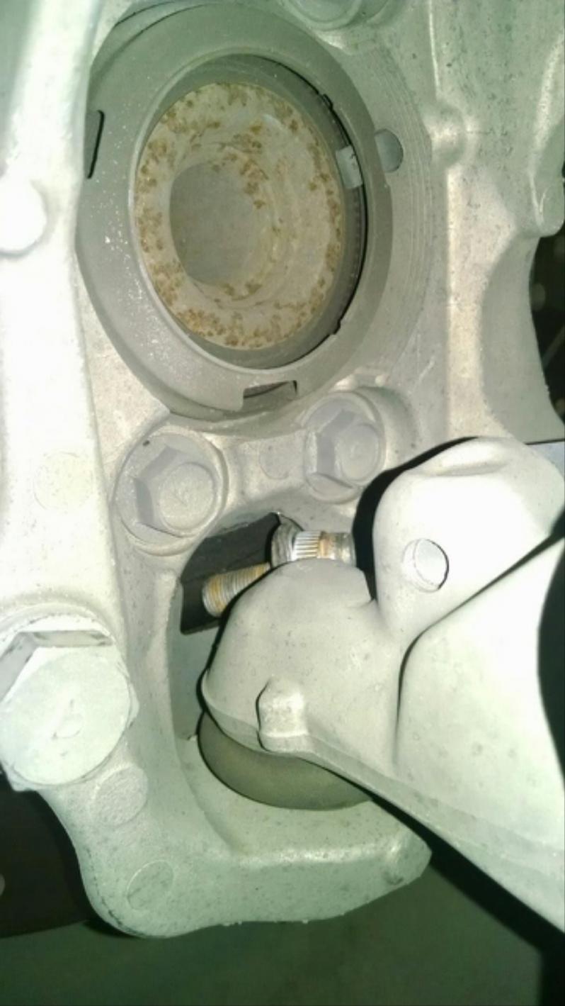

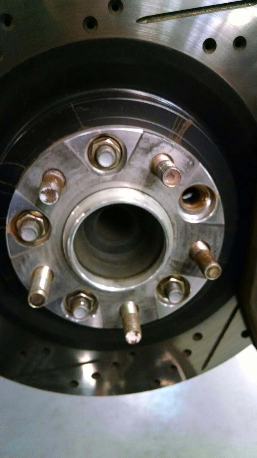

Originally Posted by Cwaligor
Hey pyramid falcon, what did you find out at the dealer?
So I went and picked up my car yesterday evening. The Service Rep did take pics as I requested. one of the pics showed a random nut that came off of my spacers inside the brake caliper. Of course they claimed to not be able to get it with a magnetic tool and had to take the caliper apart. I don't know if any of this was true but it cost me another $54. My car is no longer making the noise now and is ok. I suspect that plate was just bent and they found a way to squeeze some extra cash out of me. Its the risk we take when we go to any mechanic.
Attached Thumbnails Video 08 G37s coup metallic noise-screenshot_2015-01-21-16-57-43.jpg   Video 08 G37s coup metallic noise-img955201.jpg
