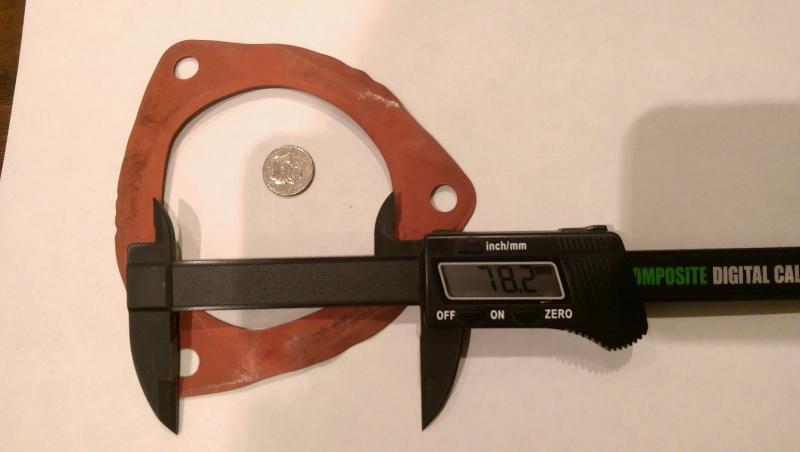

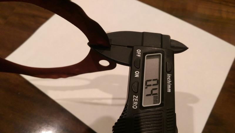

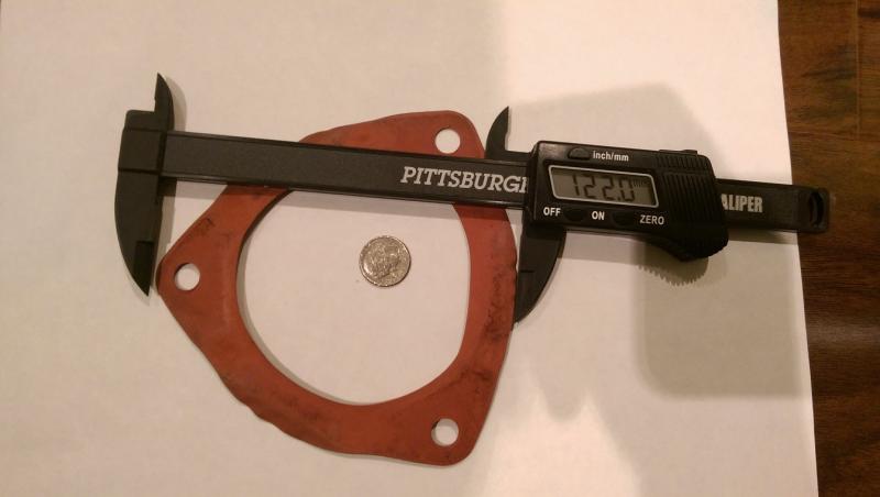

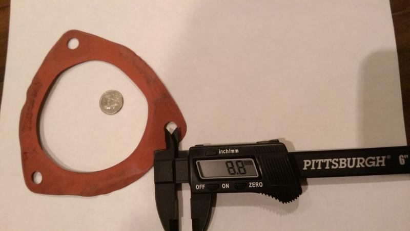

I pulled my beat up gasket out just for you. This is by no means accurate but at least you get an idea. Also I would like to correct myself on the thickness of the gasket. It varies from 0.3 to 0.4 mm instead of 1mm that I've stated. I put a dime for reference because I don't have a ruler...
Good luck
