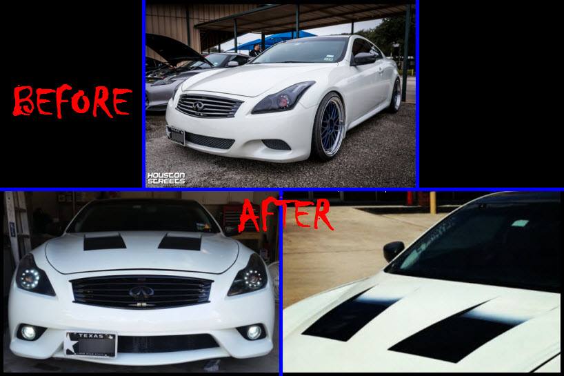

To be honest with you, I dont know exact mileage, but it's right around 20,000 miles. As for the condition, I have BC coilovers and im not too low, just tucking my tires and I avoid bumps lol. This picture is how I sit right now.
