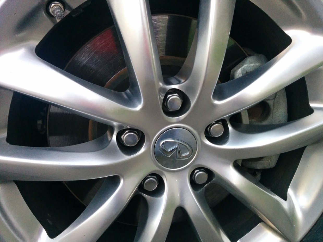

We've got a 2009 g37x, that since recently (well, a few weeks ago I guess) has been making a faint clicking/ticking/knocking sound when turning left. This sound I hear when I sit in the passenger seat, but you can't really hear it when you drive.
My dad went in for a regular maintenance today and asked them to check it out. The mechanic wrote this up:
"Noise appears to be from the corrosion of the inside edges of the front brakes."
Now, I'm no expert, but wouldn't that noise always be present if it was coming from the brakes? The rotors don't actually change position with respect to the wheel, when the wheel rotates to turn left (and no noise when it turns right).
Here is a picture of the wheel with the rotor in question:
The mechanic suggested changing rotors and pads, of course. (For $700 lol). Which we've declined.
To me the noise sounds more like a CV joint but very quiet.
What do you think?

Get another mech! It sounds like a wheel bearing.

If it only clicks when you turn the wheel while driving chances are its your CV joint. If the sound is faint now that's good because you likely have a fair amount of time, but I'd look into replacing it sooner than later. It's not a tough job if you have an impact gun.

My 2009 G37X was making the same type of noise, from the right front, sounded like an airplane engine. It was the wheel bearing.

Check to make sure the dust shield hasn't bent and is contacting the rotor
