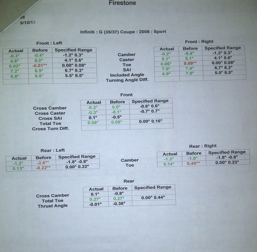

Here's an alignment sheet from another post, but lists the acceptable spec ranges

You can take caster to 7.
The only con with increased cater, is steering effort, but with power steering its moot.
The pro is that you wheel returns to center more easily.
