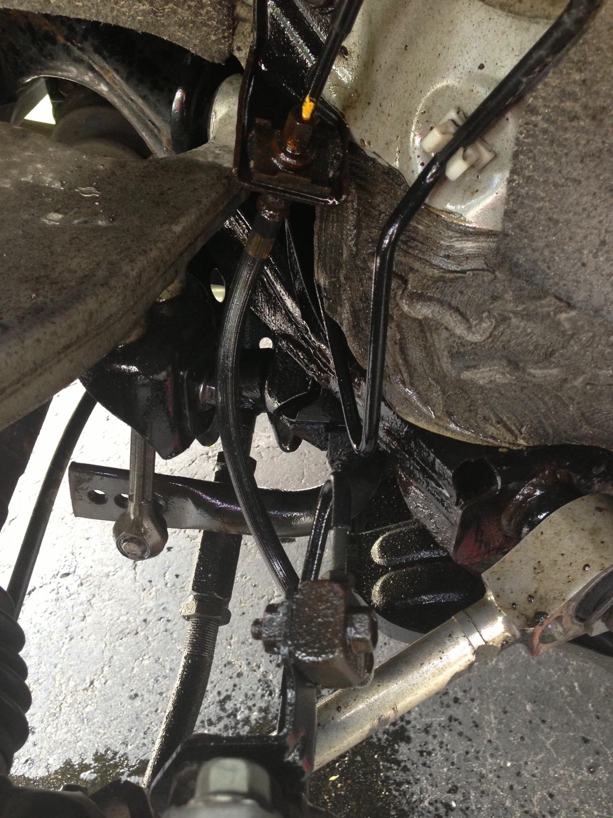

Last night I began installing Goodridge stainless steel lines on the rear. After getting the rear driver's side installed I noticed the potential for some serious rubbing between the radius arm and the new ss line (see Pic 1). Inspecting the rear passenger side, I found that there was plenty of clearance (Pic 2).
I could check the clearance through the range of motion by compressing the rear suspension. I used a floor jack to and raised the rear driver's spring bucket and then lowered it while watching the clearance. It got worse as the suspension returned to the uncompressed state and ended up touching the rear camber arm.
Not confident with the installation I removed the Goodridge line and reinstalled the OEM rubber hose. When put back in place the rubber hose had >1" clearance.
The differences between the OEM rubber hose and the Goodridge SS line are as follows:
-The OEM rubber hose can bend the close to the brass block.
-The Goodridge SS line has a 1.25" rigid straight piece that is between the SS braided line and the brass block, this prevent its from turning away from the radius arm.
Has anyone else run into this issue? Would someone mind checking their Goodridge SS lines and reporting how much clearance?
PS: what is regular name for the radius arm? traction bar, or camber arm?
Attached Thumbnails Goodridge rear line install, suspect rubbing on radius arm-img_20140604_222728.jpg   Goodridge rear line install, suspect rubbing on radius arm-img_20140604_224553.jpg

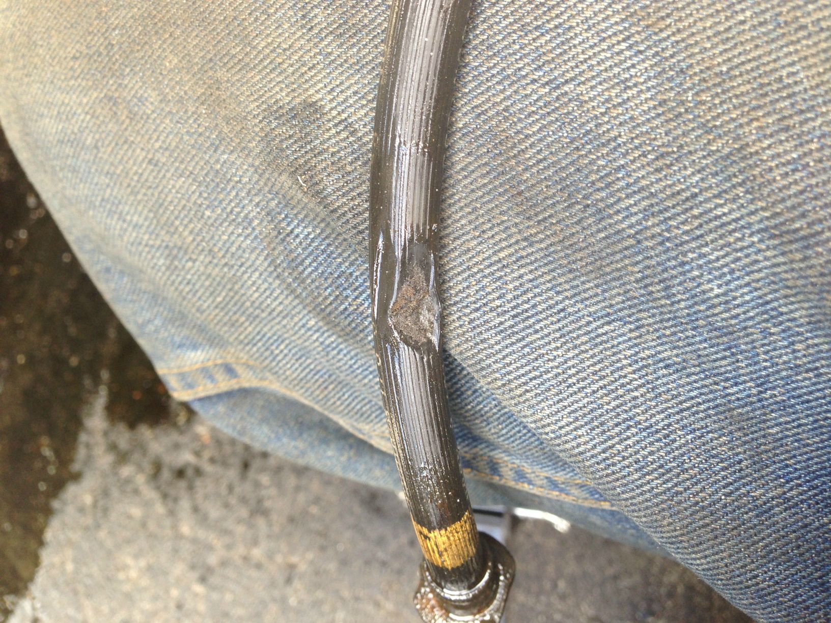

Ive had no issues to date with my SS lines from stop tech, but my previous lines actually rubbed against something in the rear and I lost all brakes in the rear.

Yikes, I'll take a peek at my old lines for any evidence of rubbing.
The Stoptech lines are quite a bit different than the Goodridge ones.

Got a response from Goodridge!
Originally Posted by Karl @ Goodridge
There are 2 things you can do. First try loosening the fitting at the block and rotate the line out if the way and re-tighten. This will in effect slightly change the position of the line to clear the radius rod. The other option is to put a protective covering over the line. hope this helps.
I'll be trying option 1 soon. I am not 100% confident it will be enough though.

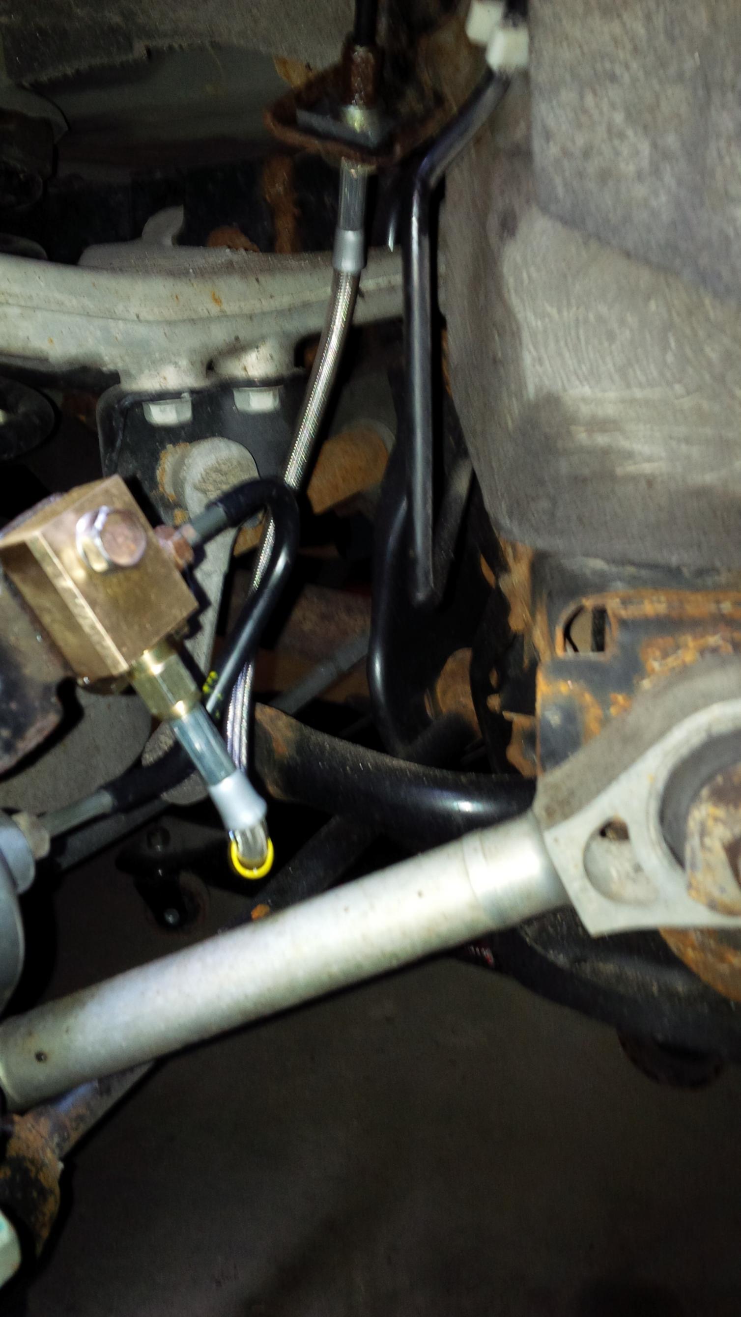

Okay, rear lines were installed with the line rotated to give maximum clearance to the radius rod. I also, bent the gently bent the bracket that holds the brass block to help with clearance.
Bled the brakes, minimum 5 cycles on each bleeder (rear only today). Surprisingly little air came out, looked like most of it came out on the first pump. Each caliper let out ~40 mL of brake fluid. Should I be bleeding even more?
Brake pedal feel is a teeny weeny bit more solid than with the old rubber lines. Honestly not as big of an improvement as I thought it would be. Also, initial bite isn't drastically different (new StopTech pads and rotors up front, no change in the rear).
Edit: Pics!
Attached Thumbnails Goodridge rear line install, suspect rubbing on radius arm-img_20140611_213447.jpg   Goodridge rear line install, suspect rubbing on radius arm-img_20140611_213636.jpg
