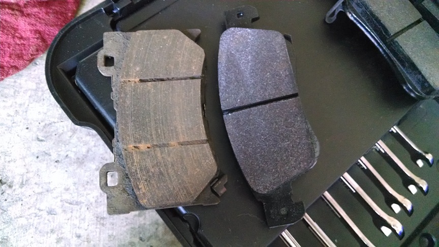

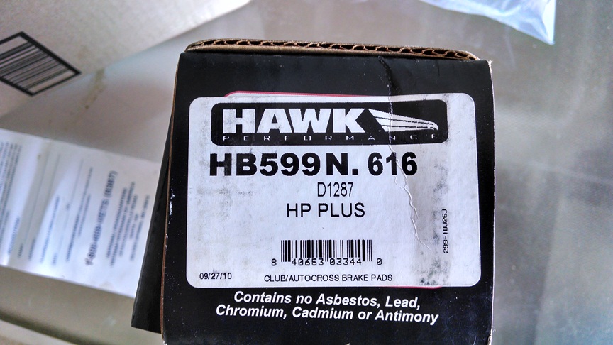

I just got these pads from Hawk but there's no way this fits, can anyone confirm this before I return them and get them from somewhere else or am I wrong and these should fit?

I guess I should have mentioned what I have- I have the 2008 Journey

According to their website it fits certain models - HB599N.616 | Hawk Performance
so that's the right part # for my year+specific model but as you can see that pad is no where near the correct pad?

do you have Akebono big brake or standard small brake?
Akebono brake:
Akebono brake:
That is similar to what mine looks like. Do the big brake have any distinct signs? like dual piston or the infiniti letters? How would I tell? or does anyone have a picture of the standard size brakes next to the big brake kit?

No, that right there in the picture is the Akebono brakes.
ok then that is most likely what I have. Does anyone have a picture of what the standard brakes setup looks like?
Similar to this, an ugly floating caliper rather than the pretty aluminum fixed calipers in the above pic.
ok yea then I def have the big brake kit. How would I go about purchasing pads for it? Where do I start looking since standard search generates the normal sized brake pads.

Just looked it up on tirerack. You bought the wrong pads. That part # is for 2008+ G37 base non-sport brakes.
Front fitment
Front brake pads.
Price: $102.00 (axle set)
Estimated Availability: In Stock
Shipping Cost/Delivery Date
Manufacturer Part #: HB599N.616 Qty:
Material: Composite
Rear brake pads.
Price: $98.00 (axle set)
Manufacturer Part #: HB370N.559
The above are for standard non-sport brakes which is what you have.
The ones you need are the following:
2008 Infiniti G37 Sport Model
Front fitment
Front brake pads.
Price: $160.00 (axle set)
Manufacturer Part #: HB601N.626 Qty:
ADD TO CART
SHIPPING
QUOTE
ADD TO
WISH LIST
Rear fitment
Rear brake pads.
Price: $110.00 (axle set)
Manufacturer Part #: HB602N.545

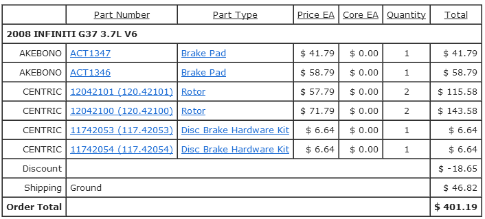

I've never heard my setup squeal... I can't stand brake squeal...

I have pretty much the same/opposite problem. Hawk sent me the square pads (pictured on the left of the OP's post), and I need the ones on the right. I'll trade ya. hahaha. I have a 2011 M37x, and I ordered the one that Infitini said would fit my car, and it doesn't... sooo.. I think Hawk needs to get their stuff together and figure out what fits what.
