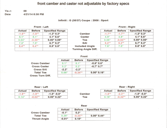

I just got my car lowered on eibach springs ~2 weeks ago and got an alignment last week. Here are the results. I was disappointed to be out of spec, but I have not ordered a camber kit for the front. I have about 50% tread on my tired currently so I'm just going to let things go for now. When I do replace the tires I intend on hopefully have extra cash to also get the camber kit. However, the specs arent insanely out of spec and I'd imagine it is more than manageable to live with.

You're not too bad and one side isn't off from the other by much so your wear shouldn't be too accelerated, and your F&R toe is very good. Sounds like a solid plan just riding out your tires and planning for arms in the not too distant future.

Exactly, Brad. I was kind of pissed about the alignment at first but I got over it after a few days for those reasons ^
Best advice to OP... eibach will likely throw you a little outside of spec. It isn't the end of the world, your car will still drive fine.... it just means your tires will wear a little uneven and possibly shorten their life span. I cant image less than 1degree outside spec will really have a huge impact, but just be prepared for the worst. I had my fingers crossed but oh well... things happen. If you dont get camber kit you may or may not have uneven tire wear. if you do get the kit it'll cost ya about $500 up front. Pay up front or gamble about paying on the back end of things.
**Also note, my drop on eibach springs went a little further than advertised (both good and bad I guess) with roughly ~1.4 in front and 1.0 in back.
