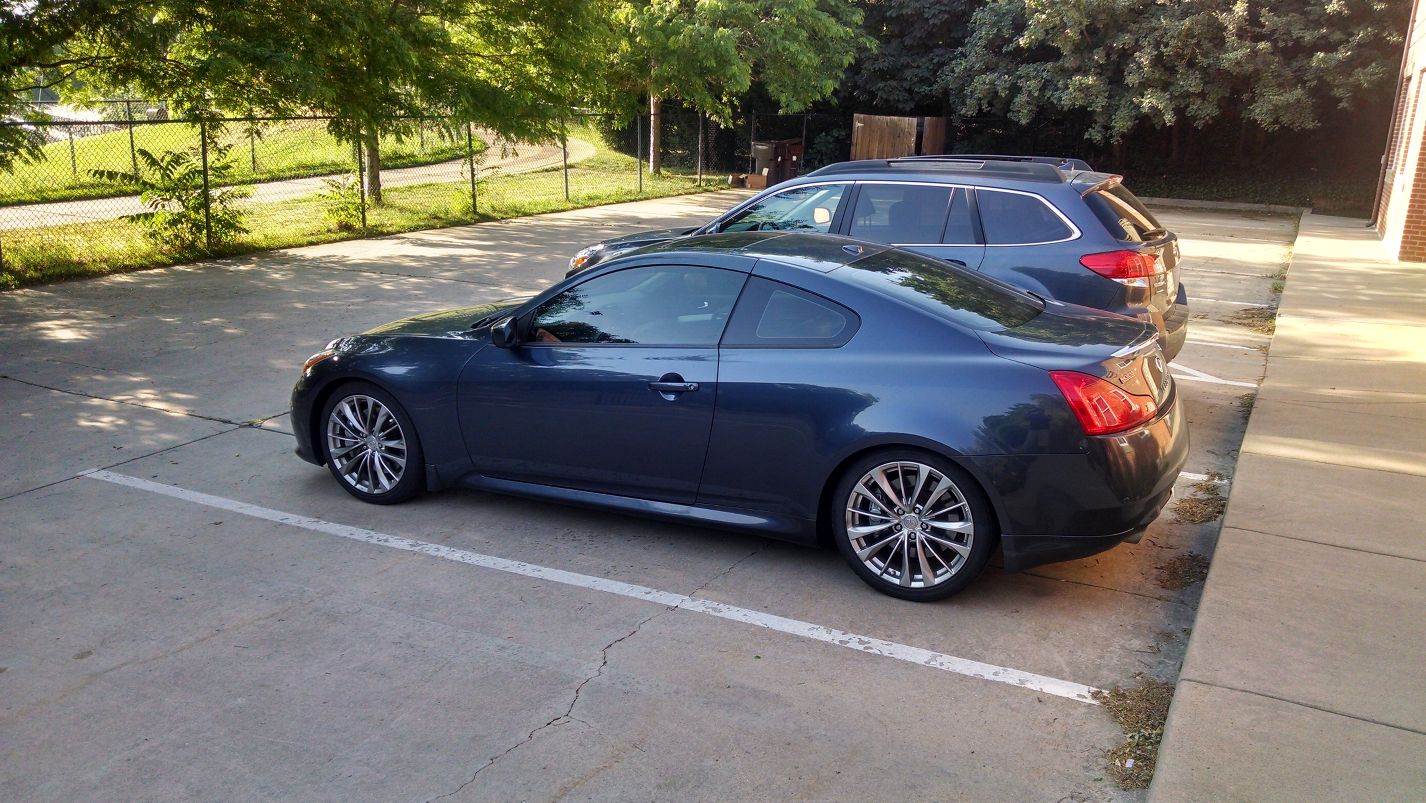

I was in a similar position recently. The limited options for the X make it a hard decision, but I settled on the Eibach springs. After looking at Tanabe's website, it appears that they have the same part number for EVERY TRIM of the coupe. We obviously know that the weight distribution of the AWD and RWD are different, so this makes me question how much R&D really went into these springs.
My 2 day review of the Eibach's are good. Ride comfort is maintained and overall handling is improved enough for a daily driver. The X from the factory has a very "floaty" feeling that the Eibach springs eliminate. Going over a bump is less of a "wave/bounce" and more of a "thud". There is not any noise or unusual quirks to this setup. Right now my car is currently sitting at 27" all around, so the drop is dead even. For reference, my X started at 29" front, and 28.5" rear fender to ground measurements. Eibach has an entirely different part number for every trim of the G37 which means they at least put thought into the engineering of the springs, and for this reason, I approve. I do need spacers pretty badly though...
Before:
After:
Before:
After:

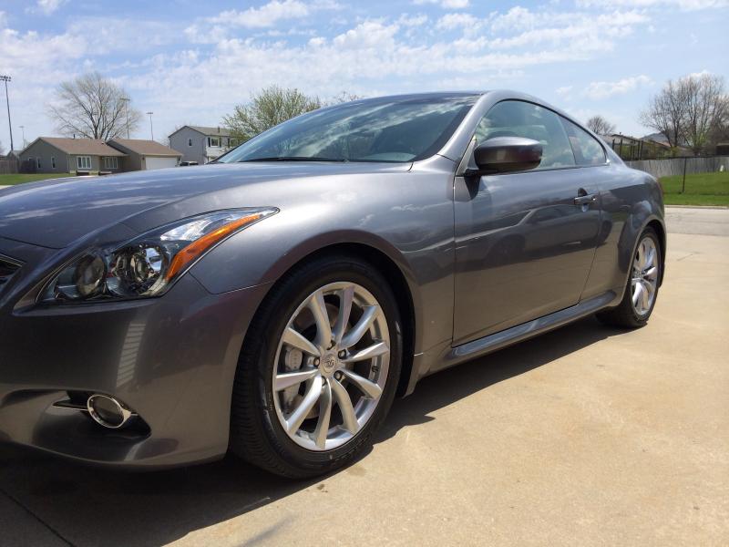

These pictures tell the story a little better:
Front:
Rear:
Note to any observant members: Yes, I know I didn't have to label front and rear but I have learned in life that you can never be too clear, lol.

So after much digging and researching, I came to the conclusion that the Swift springs were going to be too stiff for the front and most likely introduce understeer. As such, I ended up going with the Eibach pro-kit.
I like the stance, and the ride is pretty bearable on all but the worst of the roads. It does seem a little soft in the back until you really get into it, but once I get the ARBs on, I think this should go away.
One thing I do see, is the Eibachs definitely appear to drop a little more on the Sport model. Anyways....apologies on the crappy cell phone pics.
Before:
After:
A little better profile:
Before:
After:
