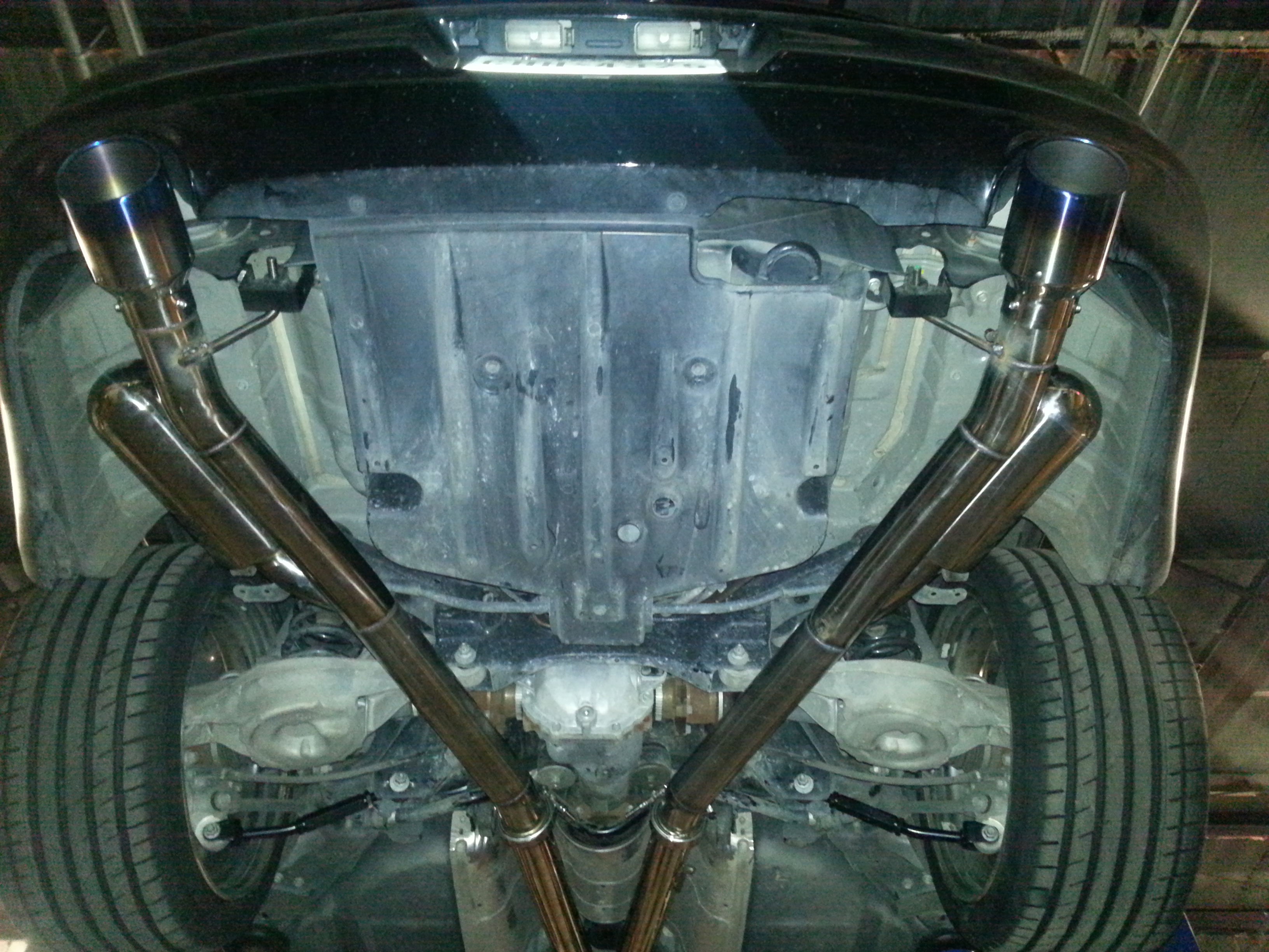

Thanks for the replies. Do you have a picture of this washer, blnewt? I'm trying to visualize what to look for, next time I jack the car up. I can just see the alignment shop telling me that they can't adjust the camber at all, so hopefully I'll be able to show them what small adjustment can be made.
It's encouraging to know that a small amount of camber can be adjusted - I think with the mild drop of the Eibachs, that small adjustment might be enough to get me close enoug to specs.

Here's a pic of some SPC camber arms, the new black arms on each side, so rather than an adjustable arm the OEM arms are solid non adjustable, the inner washer mount is what you adjust. That's the best I could do on short notice, but you get the idea

Thanks for the picture blnewt, that helped me out this weekend.
