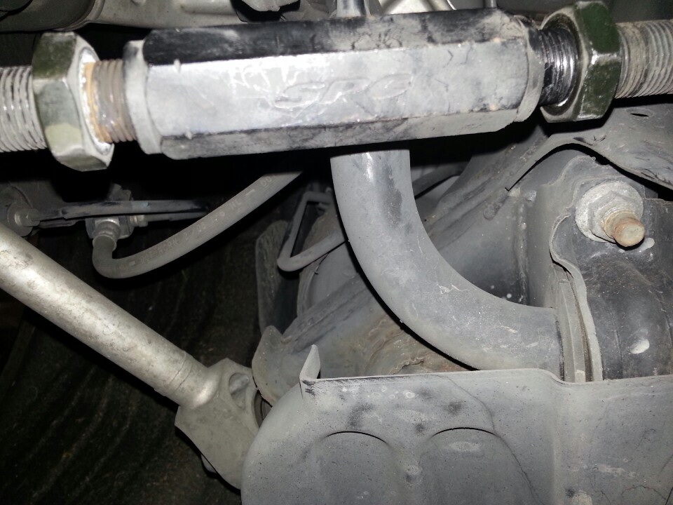

Alright guys so I've tried to add a 20mm spacer on my rears. My existing set up is 20x10.5 +15 so it'll be a -5 offset with the 20mm. Problem I ran into is it seems I maxed out on my spc camber arm. And I need about half a inch of more camber. What are my options? Shorter control arm? If anyone can send me a link to what I need or anything is appreciate it.

SPL may be an option, not sure how much range they have What camber are you currently running, about -4?

I'm about -2.7. What about these? https://www.splparts.com/store/produ...hp?pid286.html

Those would be the ones. Might send a PM to "TVPostSound" he runs them and might have a better idea of their range. I'm very surprised you've maxed out the SPCs at -2.7 though, something doesn't sound right

I'm not maxed out at 2.7 but rarely close. The pic shown was as far negative I could go safely. Thanks for the help
