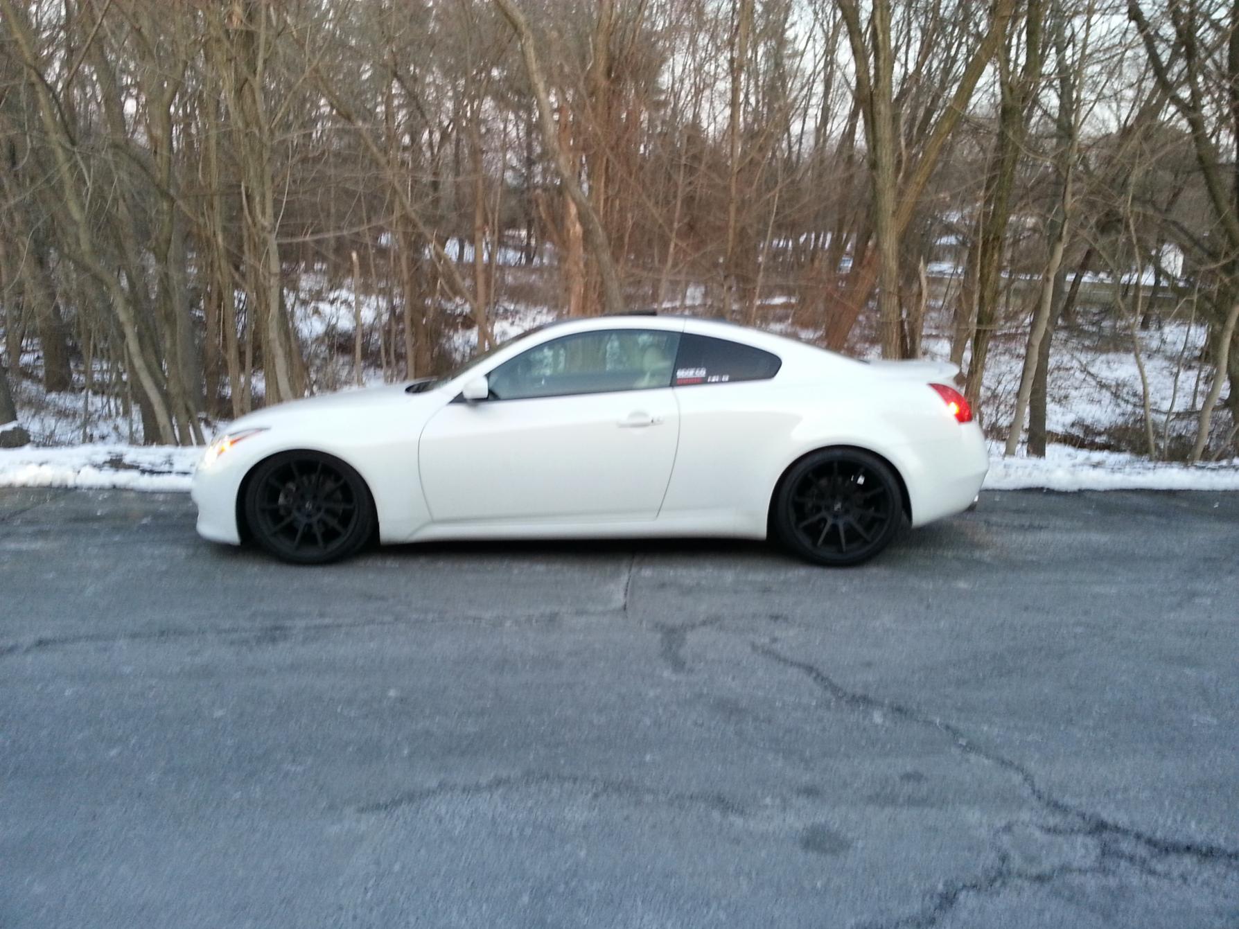

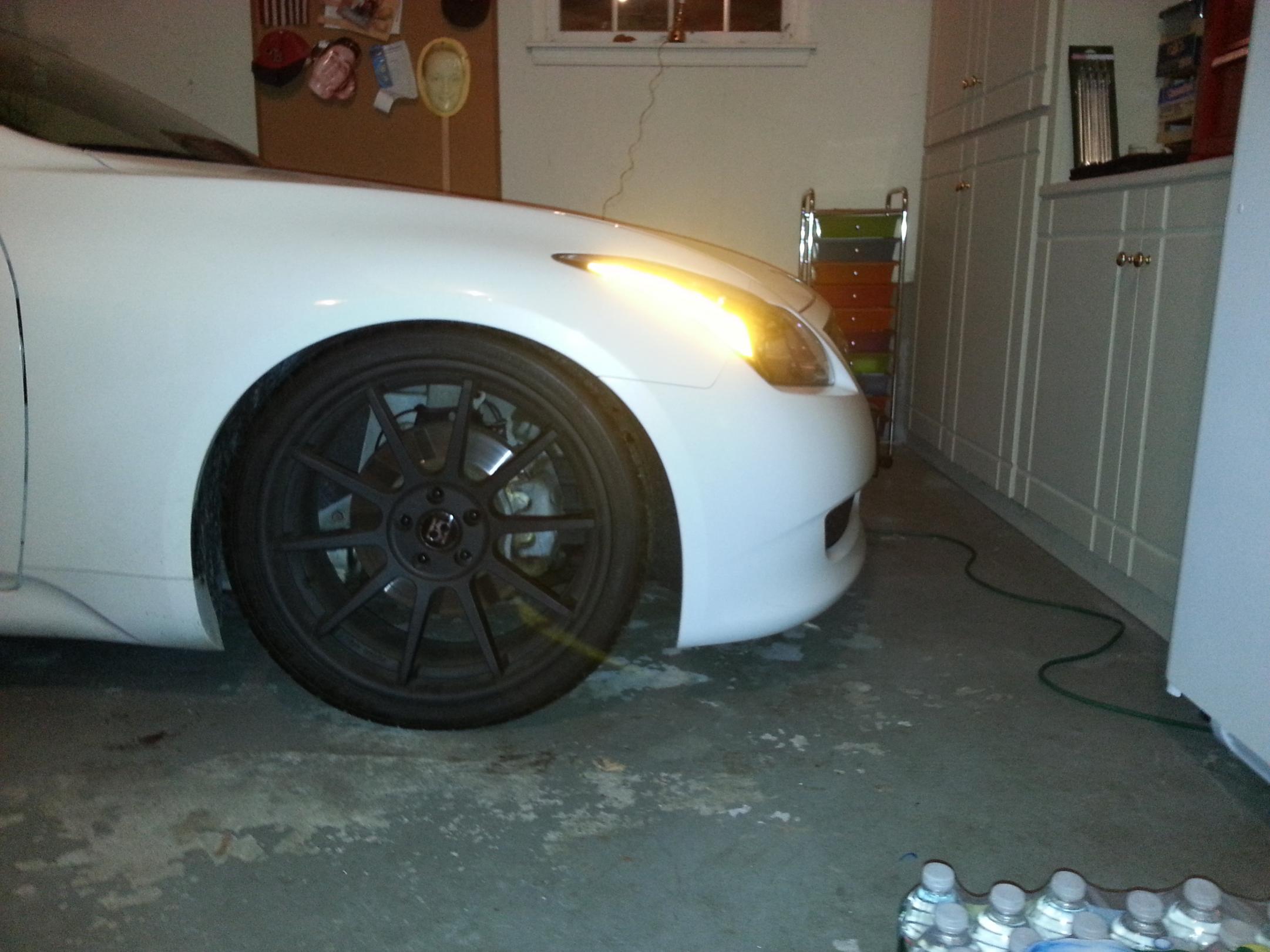

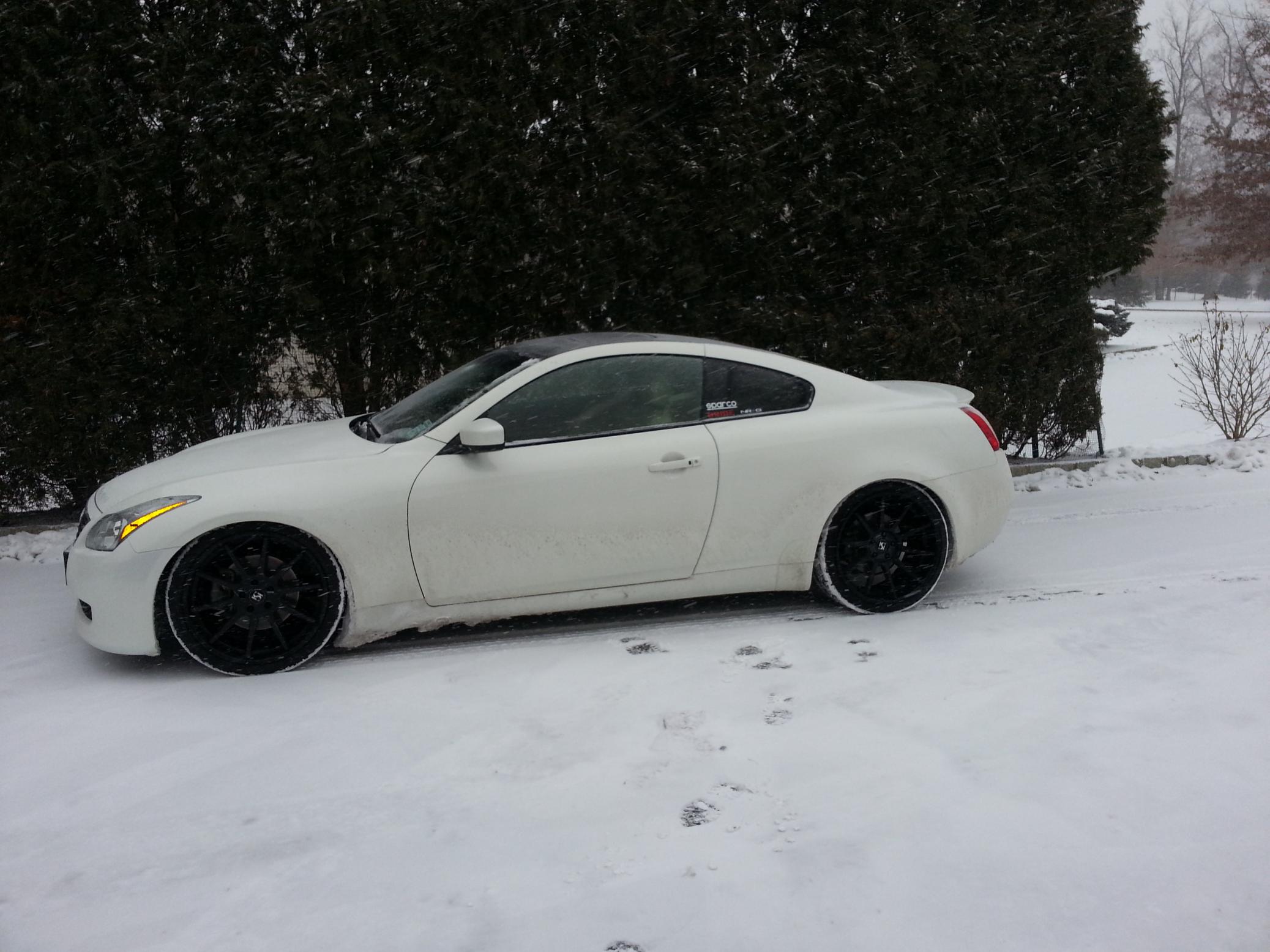

Just lowered the car ob BC coil overs for the X to get rid of that awful wheel gap. I still haven't adjusted the heights yet, so the front is a little too low and the rear is a little too high. So far so good except for the clunking noise in the back right. Every time I go over a bump there is a noticeable clunk noise. Could this be because of the preload setting?

I may need a camber kit in the front, but it depends on the height/camber after I'm done adjusting them. I didn't align yet, but still drives perfectly without a new alignment. The wheels are Giovanna Lindos 20x8.5 & 20x10 with BF Goodrich A/S 245/35/20's all around.

Looks good man! Nice to see another X coupe coming together!
