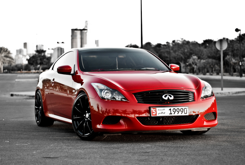

Once my car is lowered, I'd like to get some 20mm spacers as well, as I'm going for a look like this. As far as the brand of spacers, does it really matter as long as they're hubcentric and have the studs built-in? I was looking at Ichiba V2 spacers, but I've seen some people claim that H&R and Eibach are better. I'm already aware that the Ichibas have a vibration issue, but it sounds like the solution is pretty simple by just making a crush washer with copper wire. Thoughts on this?
Ultimately, I'd like my car's stance to be like this when all's said and done:

you'll have to really call around for the spring install, the price can very a few hundred dollars between shops. The install is pretty simple and strightforward w/ the spring compression being the toughest (and most dangerous) part if you've never done it before. Expect to pay somewhere in the 300-500dollar range. If you can remove the front springs, take them to a shop and have them switch out the springs that should save you all but about $100. The only tools you would need if you sent out the springs would be a 2 ft. breaker bar, some PB blast (to make the bolts loosen easier), jack/stands.
If you go as low as the pic you posted you may need some camber/toe kits, really depends on each vehicle as some do & some don't, and also the shop doing the alignment. Some shops that deal in lowered vehicles more often are usually able to get to spec easier than shops that deal primarily w/ stock vehicles. If you do need camber/toe kits expect a minimum of $60 for the rear toe bolts, another $130 for the rear camber arms, and another $300 for the front arms plus installation.

Sounds like exactly what I just did last month with my car haha. Definitely call around and find a local shop vs a big-box type which likely won't charge you by the hour and can give you a price up front to do the job. I paid $600 total but that included the eibach spring installation, mounting and balancing 4 new wheels/tires and also an alignment.
A few weeks later went back and had 20mm H&R spacers and rear camber arms installed (and another alignment) for $250 plus the ~$150 for arms (stillen) and ~$180 for spacers. I did experience vibrations after spacers were installed, but it was due to improper hub ring size and got that replaced right away. It's amazing the difference a few mm can make!
I couldn't be happier with this setup, and below is a picture which hopefully shows the ride height and flushness of wheels (awd coupe). Good luck!
