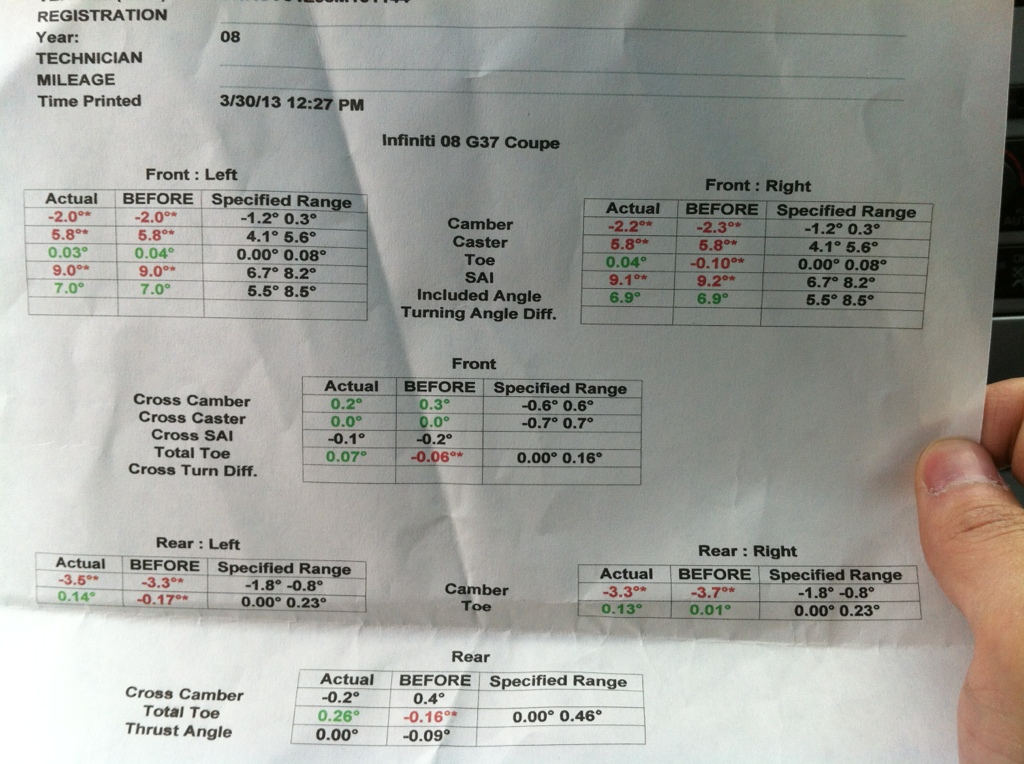

Sup guys. So I recently got my s-techs installed on stock struts. Based on this alignment setting do I need a camber kit?

IMO, definitely. Both front and rear.

Holy **** yes.

Especially the rear, with frequent rotations you can live w/ camber in the -2 range but in the 3s out back you'll be wearing the outer tread pretty quick. At least the real tire killer (excessive toe) is in a happy place
I'd at least get the rear arms for the short term and Like BB mentioned, pony up for the whole set down the road.

Thanks for input guys. I'm getting innner tire wear rather than outer tire wear

Inner wear is correct not outer. I think he just stated it backward.

My bad, yep that's what I meant.
