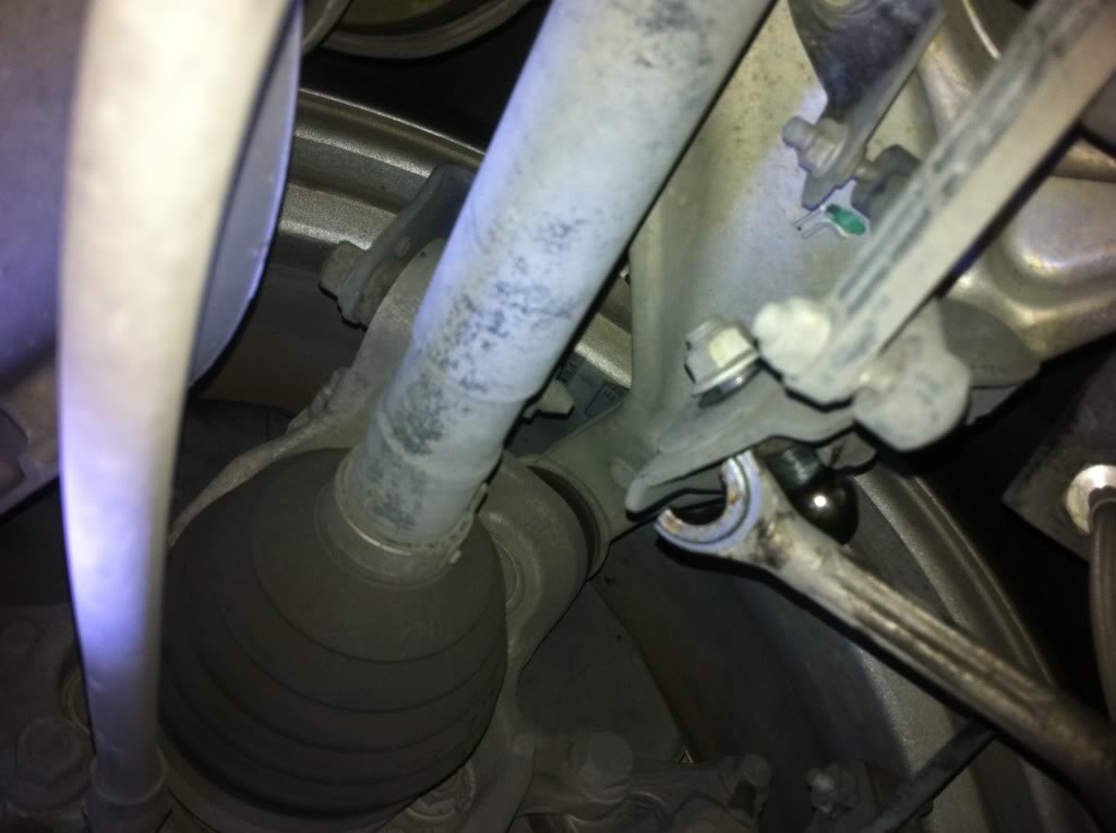

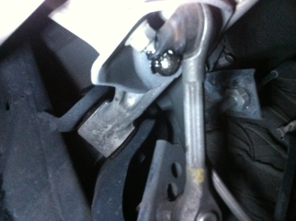

I am only mildly lowered on Tanabe coilovers, definitely not slammed by far. I don't remember exactly but above 27" ride height. Yes, there is some amount of play but not much. This doesn't happen to everyone who doesn't have adjustable links. But it certainly can. No abuse, no great number of potholes or curbs or such, no track day.

Top photo shows the end link broken where the shaft of the link meets the ball on the end of the stud at the upper attachment point. Bottom photo shows same thing on the other end link, only the rubber boot is still slightly attached. The main shaft of the link is completely detached from the stud where it attaches to the car.
