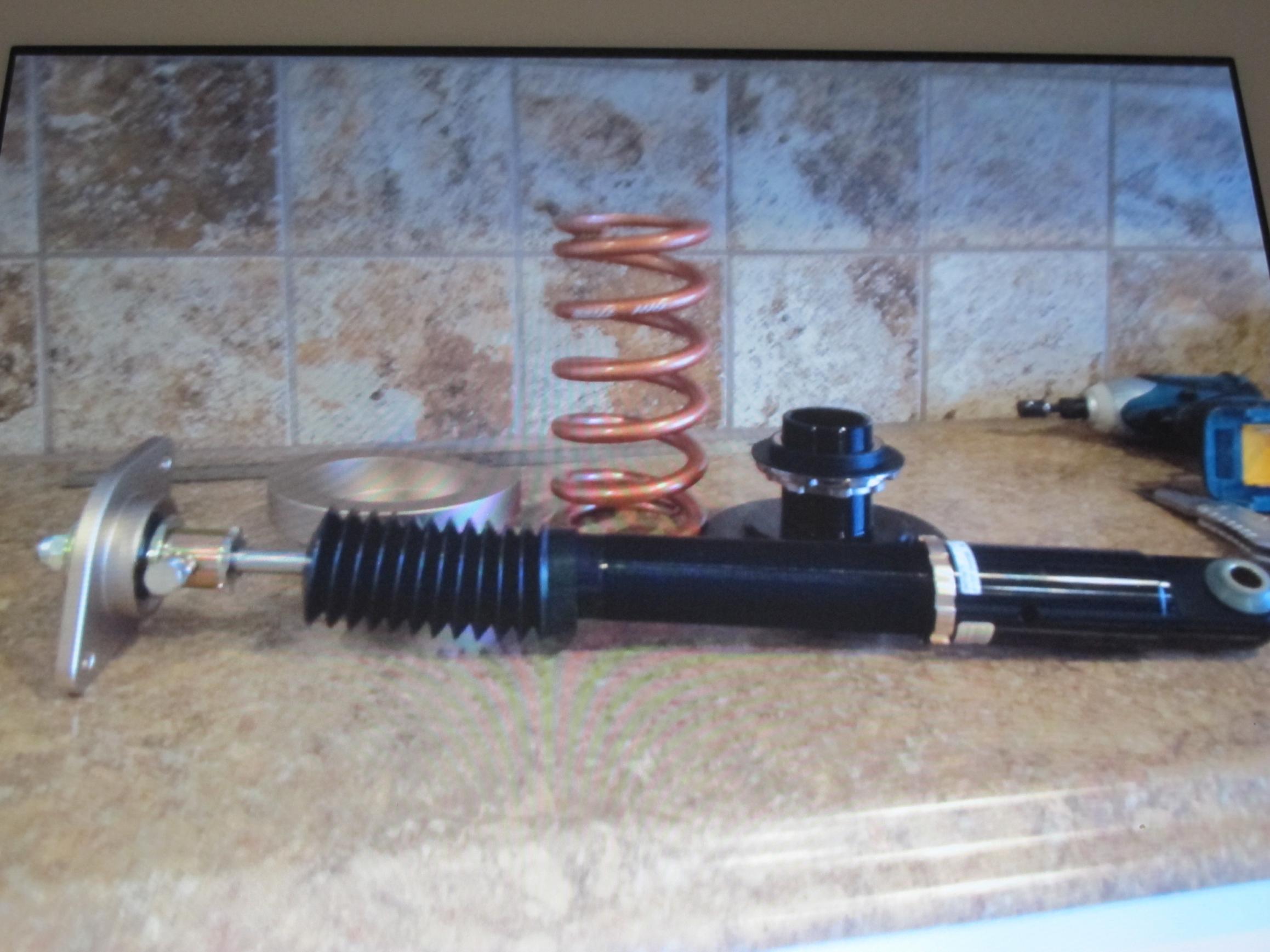

I installed the BC coilovers with Swift springs a couple months ago.The kit came with 12K Front 10K Rear spring rates.The install was a piece of cake.
The rear shock has the damping adjustment **** on the upper side of the shock.You still have to remove the tire to adjust.

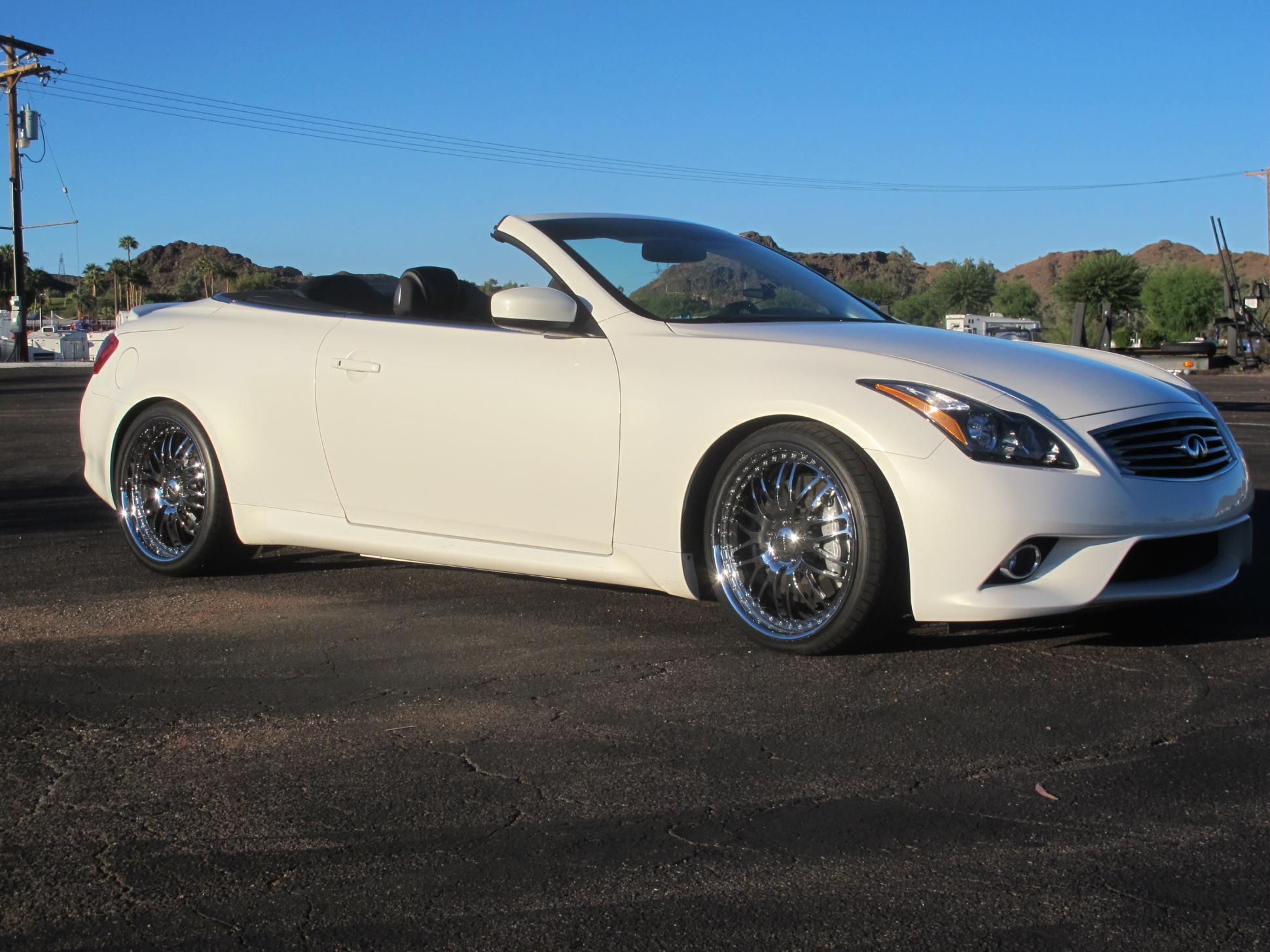

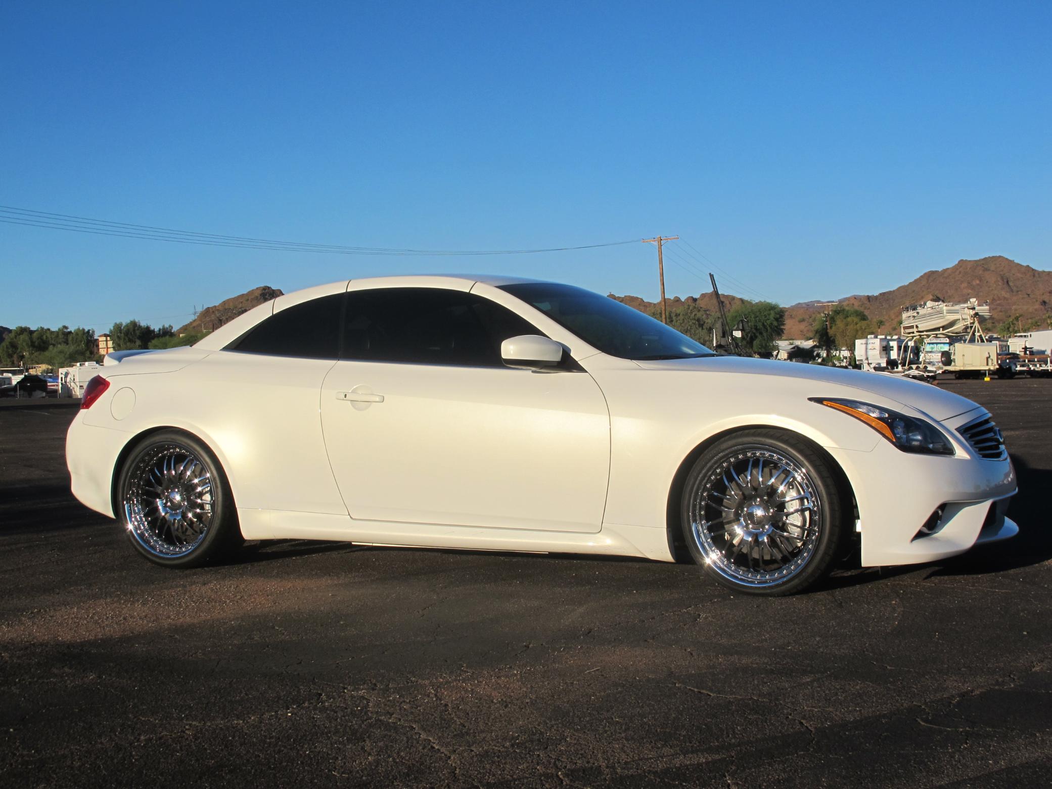

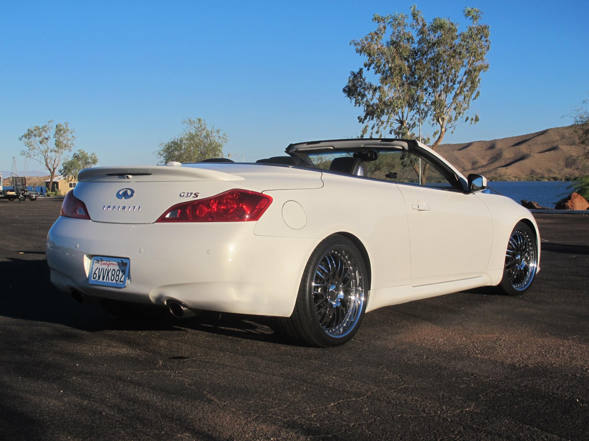

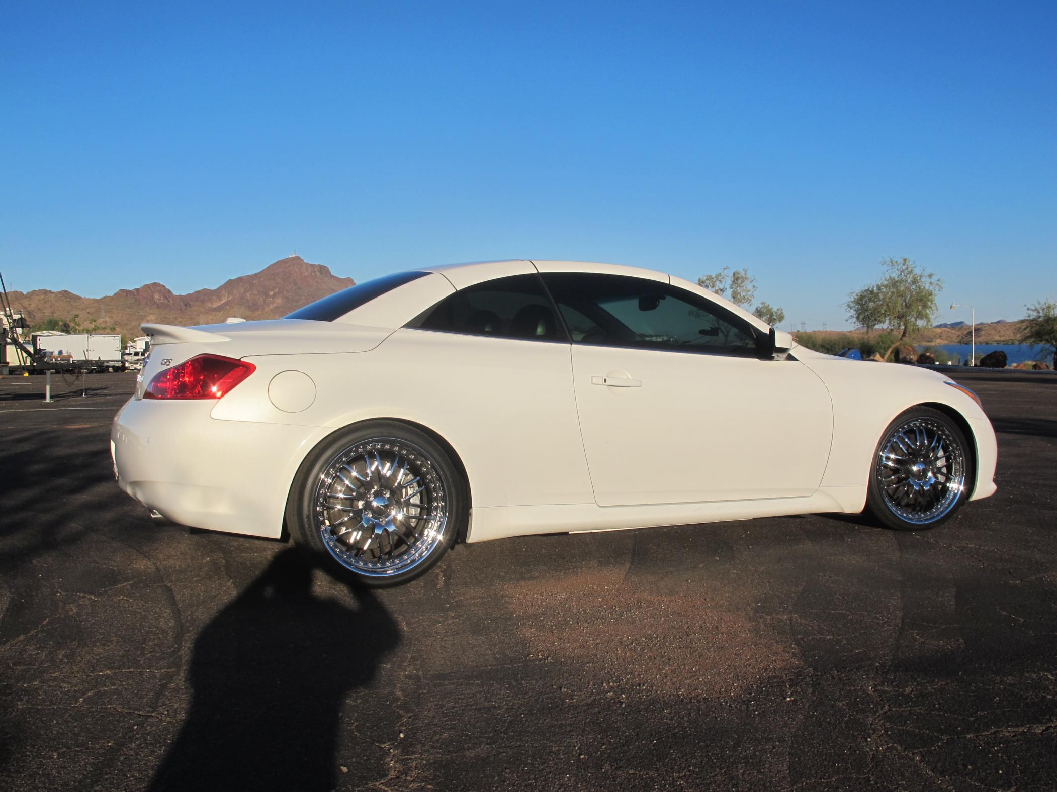

My drop right now is 1.2"rear/1.6front.There is adjustment in the rear for 2" more drop and about 1" to go higher.I am on Ifordged 20" wheels 8 1/2"Front 10' rear.Tires 285/30/20 Rear 245/35/20 Front.Ground to fender rim is 26.7" Rear 26.3 Front.

Here are a few pictures of the drop.
I am also thinking about removing the centers of the wheels and getting them powder coated gunmetal or matte black.What do you think? The price I paid for the wheels was 0,so i can't bitch about the finish.
