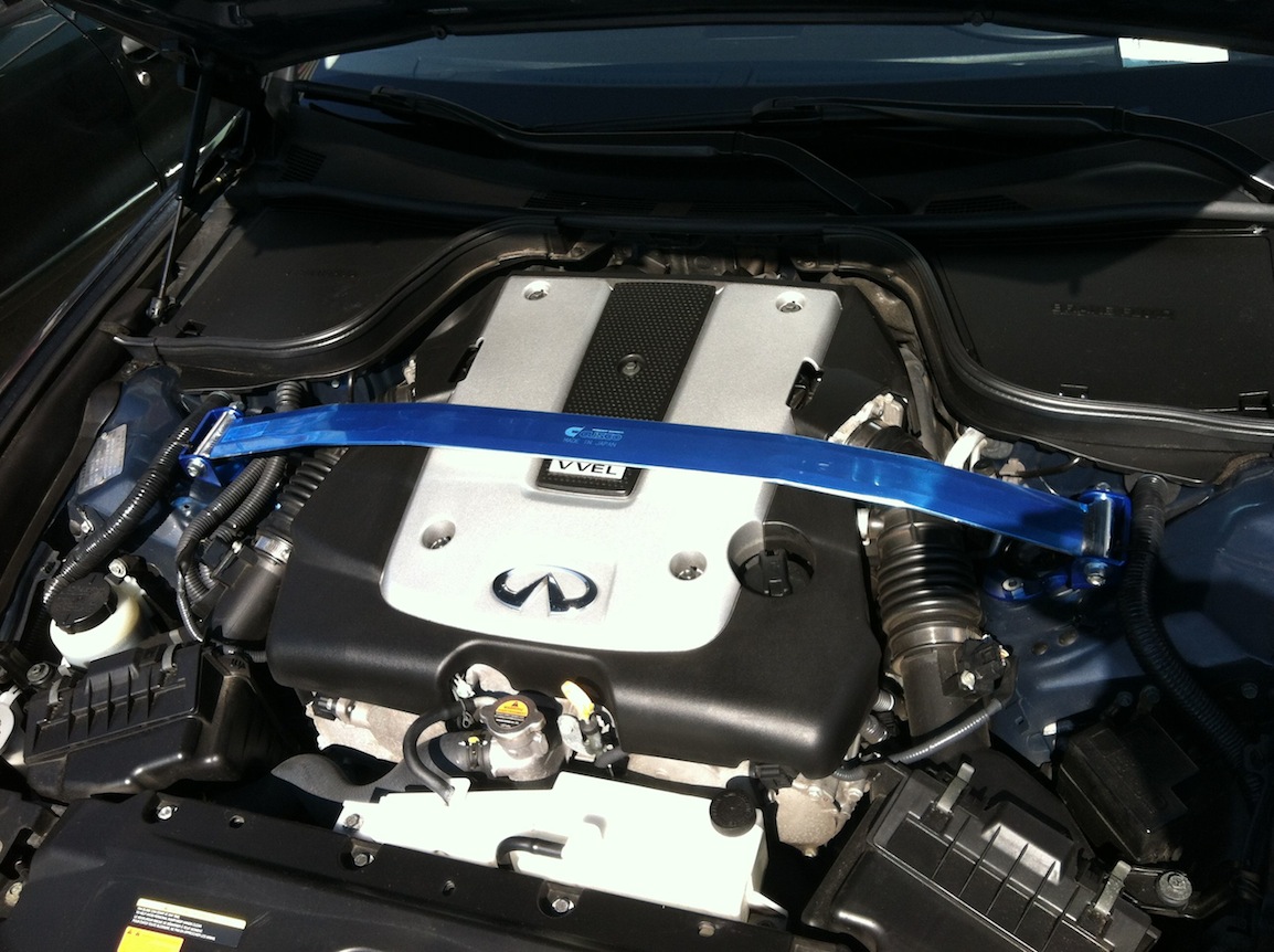

The brace arrived about two weeks ago, but I wanted to stay in the D-Stock class for the Autocross I did last weekend, so didn't install it until now.
The instructions were in Japanese, so I just had to go by the pictures. The installation is pretty simple though, so that wasn't entirely necessary...
You need 3 sockets, 12, 17, and 19mm. An 8mm Allen wrench, and a 17mm box wrench. A pliers will help pulling out the cable ties that hold two cable bundles that need to be moved.
I took some pictures in the garage last night, but the flash on my phone wasn't up to the task. These are from the parking lot at work this morning. Excuse the shadow of my hand holding the camera...
I haven't removed the blue plastic protective layer yet. I left it on to see if anything rubbed, but after the drive in the morning, I see no evidence of rubbing.

Mine didn't seem to rub at all either at first, but after a very spirited drive all day a little while back I can see where it has rubbed on both sides.

Looks good....I have these marks on the top of the bar that match up to the padding on the underside of the hood.

Nice, looks good. Throw some painters tape on the top of the bar so it wont get scratched up.
