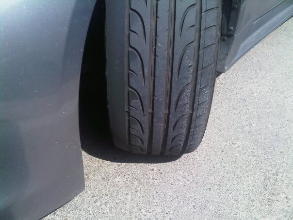

My previous dunlops before they were shot
Looks like toe wear to me, is this with the kit?
Old Jun 3, 2012 | 04:05 PM
  #29
G37Sam's Avatar
G37Sam
Joined: Aug 2008
Posts: 12,173
Likes: 244
From: Doha, Qatar
Nope purely OEM, I had my toe adjusted to 0.1 on each corner but my camber's at -2.3ish on each side
