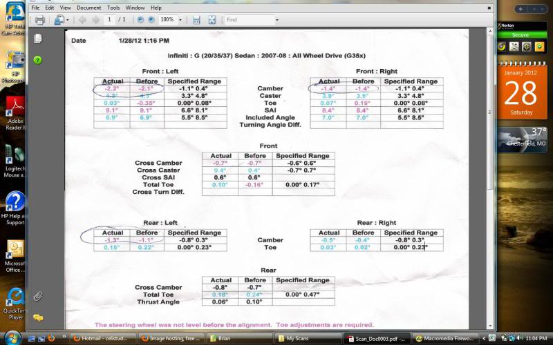

just got an alignment. got everything almost to spec with front camber being slightly off. Its not horrible and if tires are rotated properly, then no camber kit is needed. still super happy with the springs.

What were your actual specs+do you have any wheel well measurments? gettin mine on monday and having them installed next weekend-can't wait!

Originally Posted by bat6wc
Does it pull/drift to the right??
Specs say it should.
I would get the front camber arms to adjust camber and caster.
As for the left rear, I think the alignment guy could have tweaked it closer.
Old Jan 29, 2012 | 11:52 AM
  #65
bat6wc's Avatar
bat6wc
iTrader: (31)
Joined: Feb 2009
Posts: 1,494
Likes: 38
From: St. Louis, MO
those were my thoughts as well actually but the car actually drives better and straighter than it ever has. These guys are very well known for the alignments but I do have some concerns as well. may to go another place in a week or so to see what they can do.

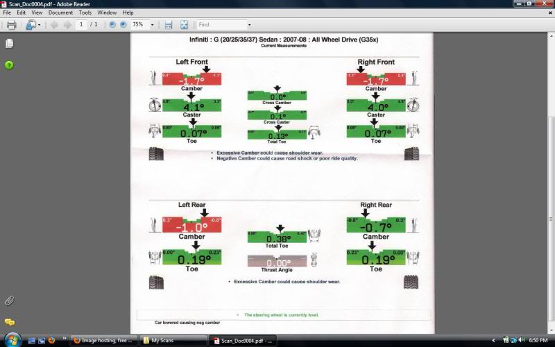

my new alignment with Swift Springs...

bat, is that with the alignment kit?

That's without camber kit

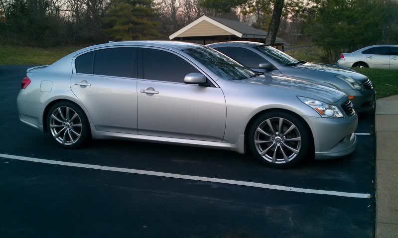

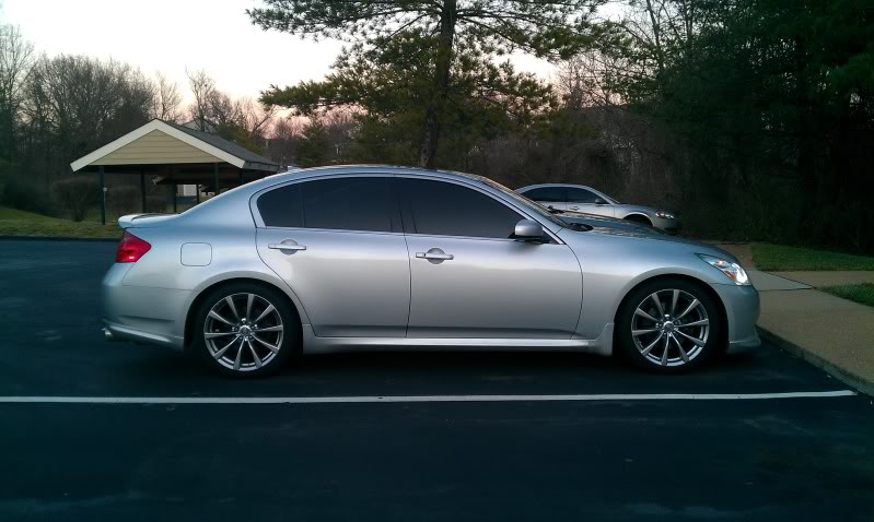

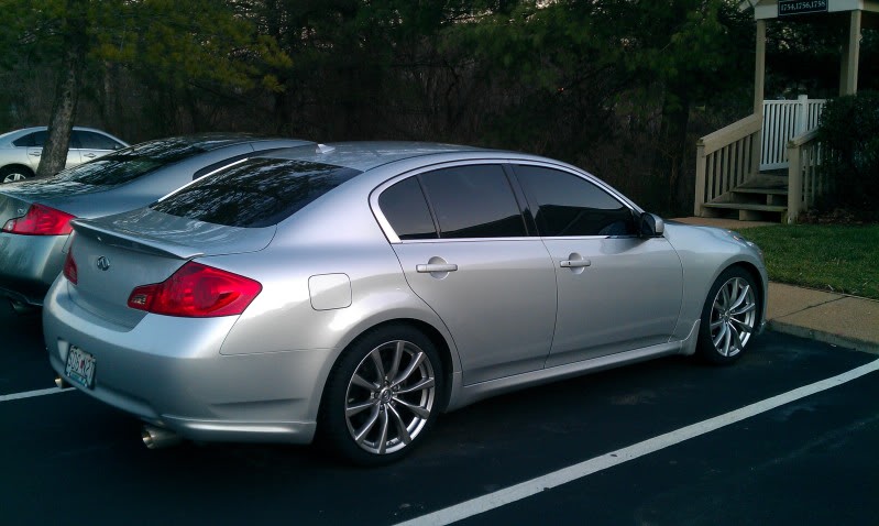

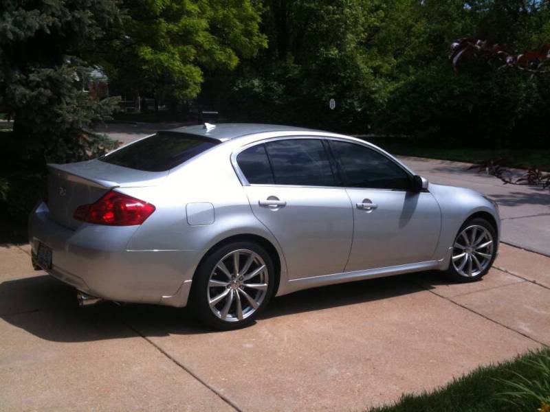

finally some decent pics.
BEFORE
AFTER
