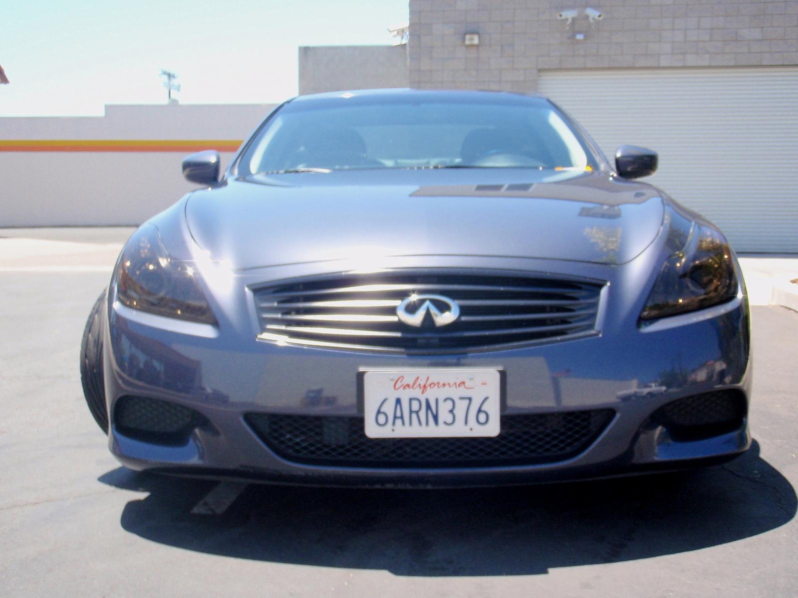

I have the Eibachs in the front and rear and I'm riding on 20's and I love it. It looks sexy and the ride is still real smooth. The springs are stiff enough that my large rims don't rub, even if I hit a bump at high speeds. The clearance gets a bit annoying with some curbs and speed bumps, but all in all it is worth it. Here is a few pics of what my G looks like with the Eibach kit.
car looks nice. what spoiler is that?
