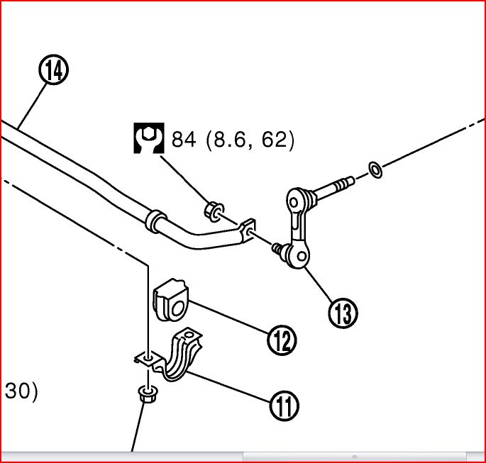

Originally Posted by kkokko
hm.... the manual says like 40ft/lbs
simply incorrect.
see attached.
Attached Thumbnails Hotchkis Installed but.. rubbing/clunking sound from front?-capture.jpg

Ok, so for future references if anyone else is installing the sways, here are the factory specs:
Front
endlinks = 84ft-lb
bushings = 50.5ft-lb
Rears
endlinks = 55ft-lb
bushings = 33.5ft-lb
I'm not sure why, the instructions say to only do 40ft-lbs for the hotchkis sways??
Front
endlinks = 84ft-lb
Rears
endlinks = 55ft-lb
Ft./lbs. are the last number in parenthesis, not the first number which is Newton meters.
i just read that part in the GI PDF. looks like i've been over-torquing bolts!
oh well, better to over torque than under torque.
