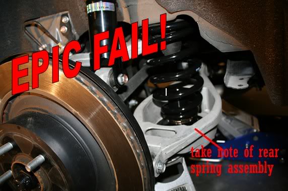

Old Jun 4, 2008 | 03:14 PM
  #75
Blackjack's Avatar
Blackjack
Joined: Jan 2005
Posts: 9,923
From: The ATL
Given what we know now... I think this is a more appropriate:
