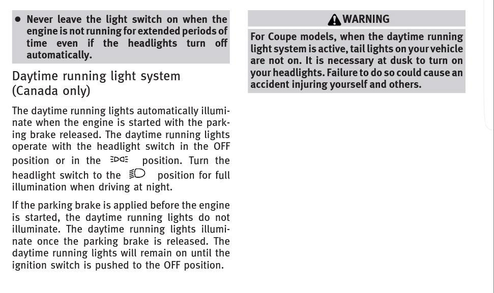

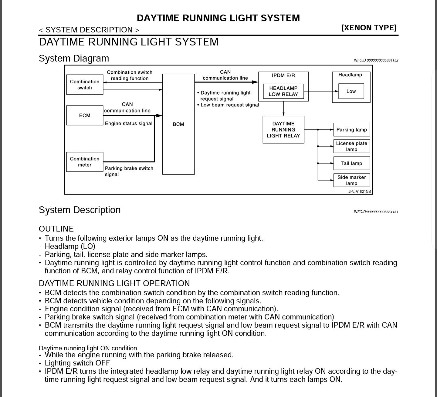

From my reading, 2010+ models added two (2) different indicator lights on the gauge cluster as follows (taken from 2010 Coupe Canada Owners Manual):
Thankfully I do not have this damn DRL crap (plus mine is a 2008).
