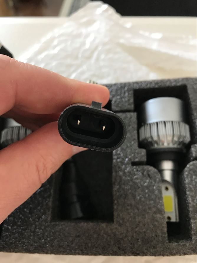

However, on Amazon I can get D2S LED light kit for $38!
https://www.amazon.com/MOSTPLUS-LED-TX1860-Headlight-Conversion-Warranty/dp/B07KP9RFPZ/ref=sr_1_4?keywords=d2s+led+bulb&qid=1570383951&sr=8-4
So I bought one! Last night. After beer. It arrived today.
However, I don’t think it will fit for two reasons (see pictures too!):
I’d prefer to know they will/won’t fit prior to loosing an afternoon stripping the front end down….
Any comments welcomed!
Thanks
- the plug may not fit the OEM wiring loom. Can anyone confirm if it will fit?
- The lead for the bulb with end plug is very short – I suspect this won’t allow fitment through the light casing in lieu of the ballast to the OEM loom. Any comments?
Thanks
You have cleared my mind from the fog of the task of removing the front of the car to replace the headlight bulbs/ballast.
In the clarity I now see, yes, why mess with cheap components in a hard to access place. Crazy, especially with winter coming.
OEM it is!!!
Thanks!
OEM it is!!!
Thanks!
It’s one thing for fog lights where they come on at your request (or DRL in Canada) but a main headlight is something I wouldn’t mess with. I’d say your doing yourself a favour getting OEM, last thing you want is to rip the bumper back off cause a Chinese bulb **** the bed!
