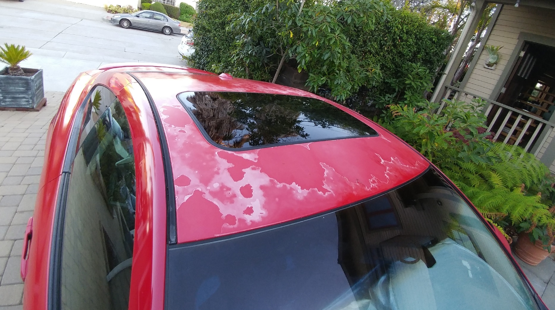

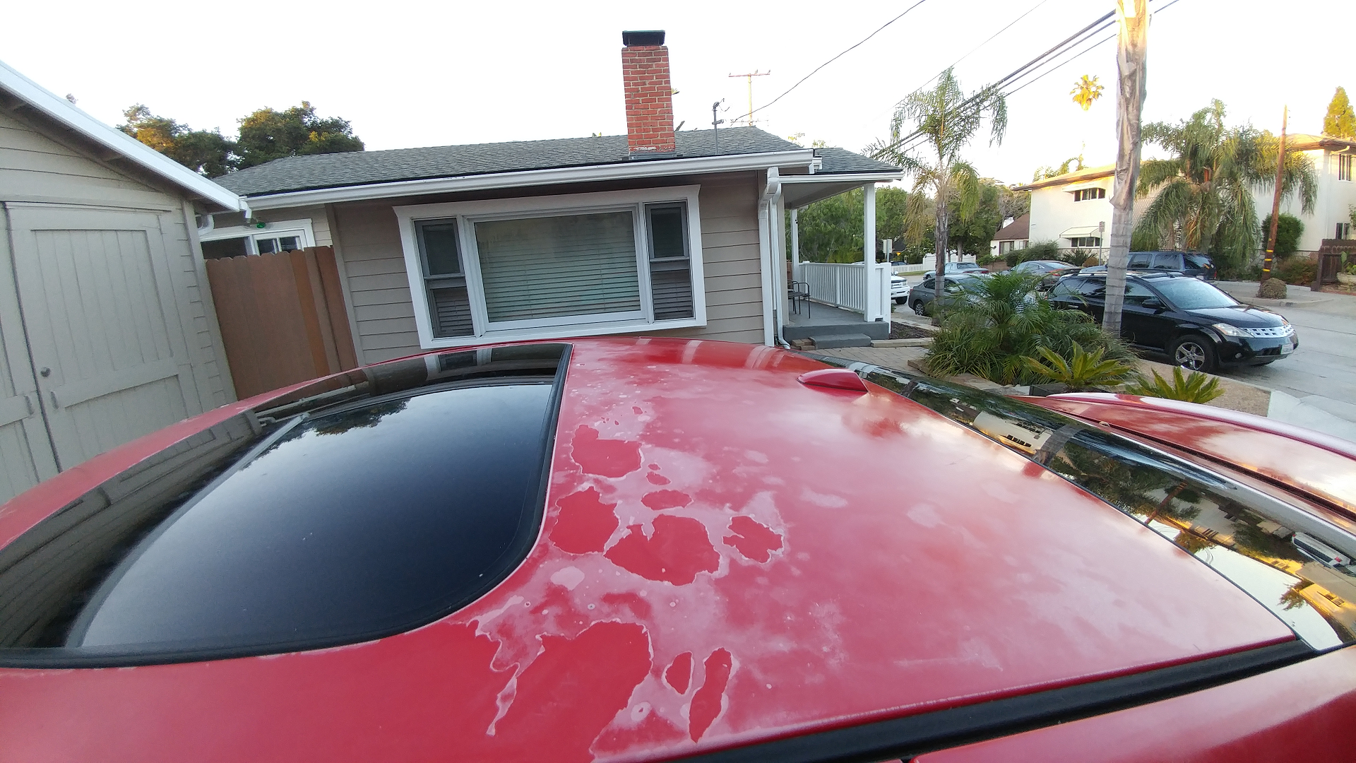

First and foremost the CLEAR COAT on the ENTIRE CAR is failing and peeling off. Before talking about accidents let me put some facts:
1. The failure of the CC is on all of the panels which get sunshine. It is symmetric on both sides of the car.
2. At the time of the purchase I checked every panel with a paint gauge and the Paint was around 4.5 EVERY panel, even the neighboring panels had the same thickness. Now this is very thin (as reference a nissan altima is around 5.5-6 range) but the consistency suggests that it is the original paint.
If this was a wreck which was repainted I don't think the 2 thins I wrote above would have been true.
I will post pictures but it is so bad that even taking pictures is annoying as hell. The plastic trims on are of different colors (because of the failing paint the metal panels become faded, the plastics such as window frames , bumpers, mirrors (again both sides not just one side) seem to have a richer color at least where there is still CC)

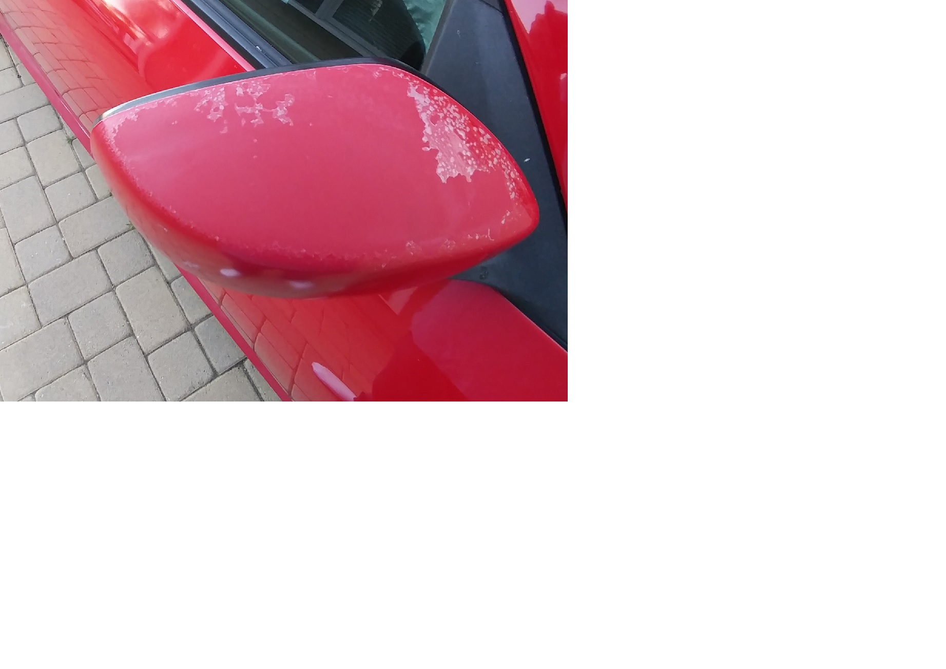

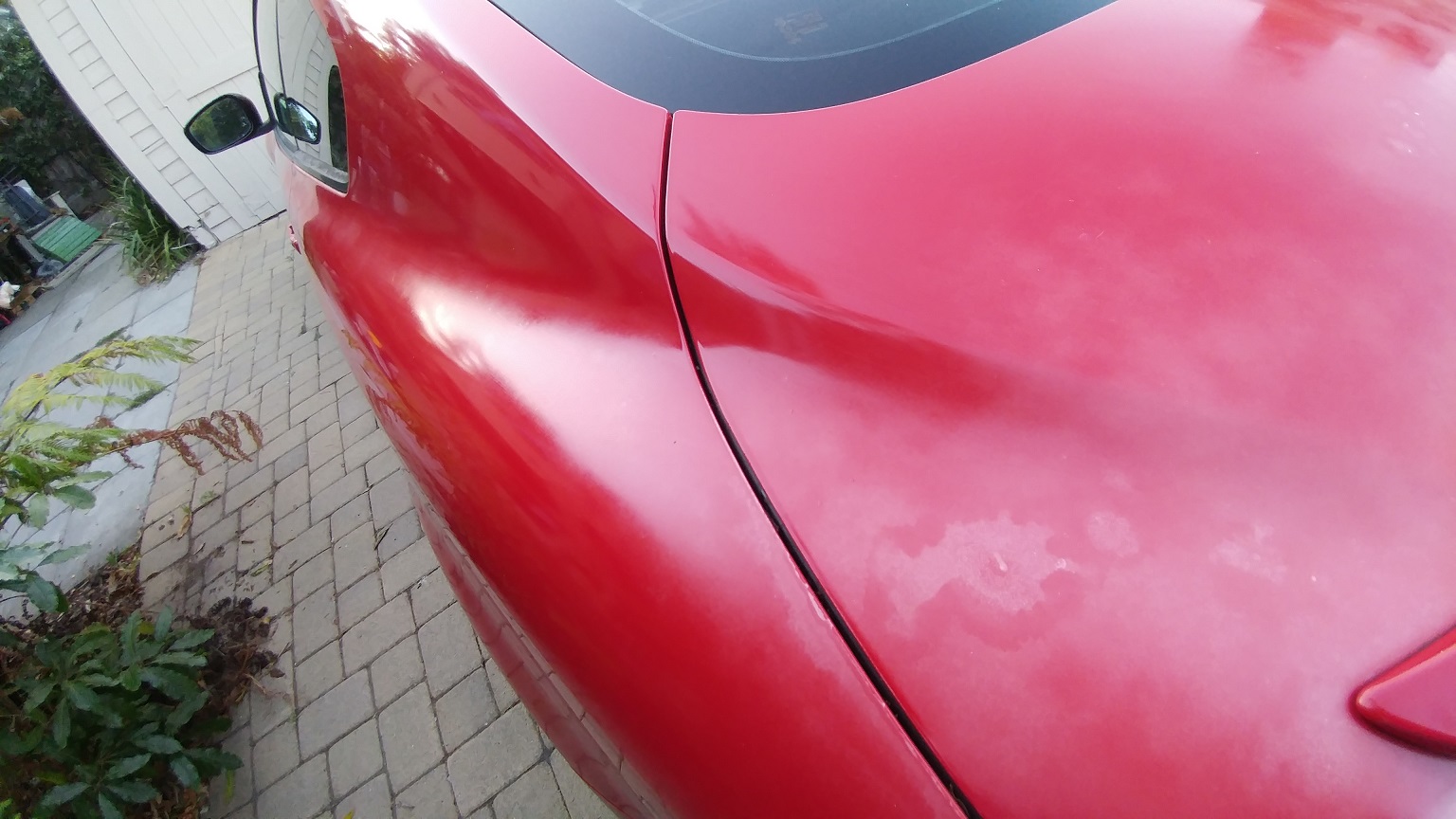

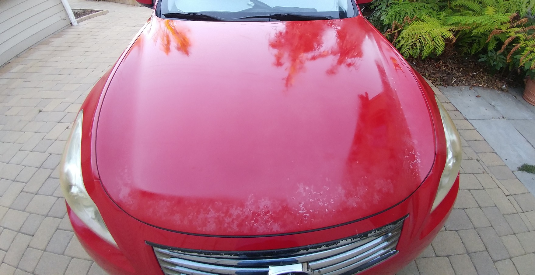

Ok I uploaded the pictures. And some of these are after clay. 105,205 so there is no hope of saving the paint.
@kidjai: Are you sure it is single stage? I mean it gets cloudy like one and since fading occurs just like the 350z so now I am confused.
Also skirts are entirely without any CC as if they never had and CC to begin with. They buffed it so many times that you can see the white patches. Btw these are all symmetric, so if one side fails the other side also fails.
The paint underneath the clear is mostly quite thick but without clear your buffer gets a litte paint transfer.
Idk , is it possible that the previous owner realized that this was single stage and decided to put a CC on it ?
