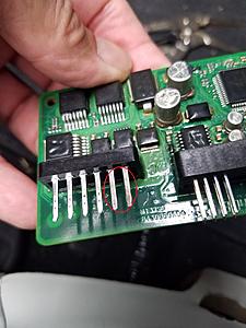

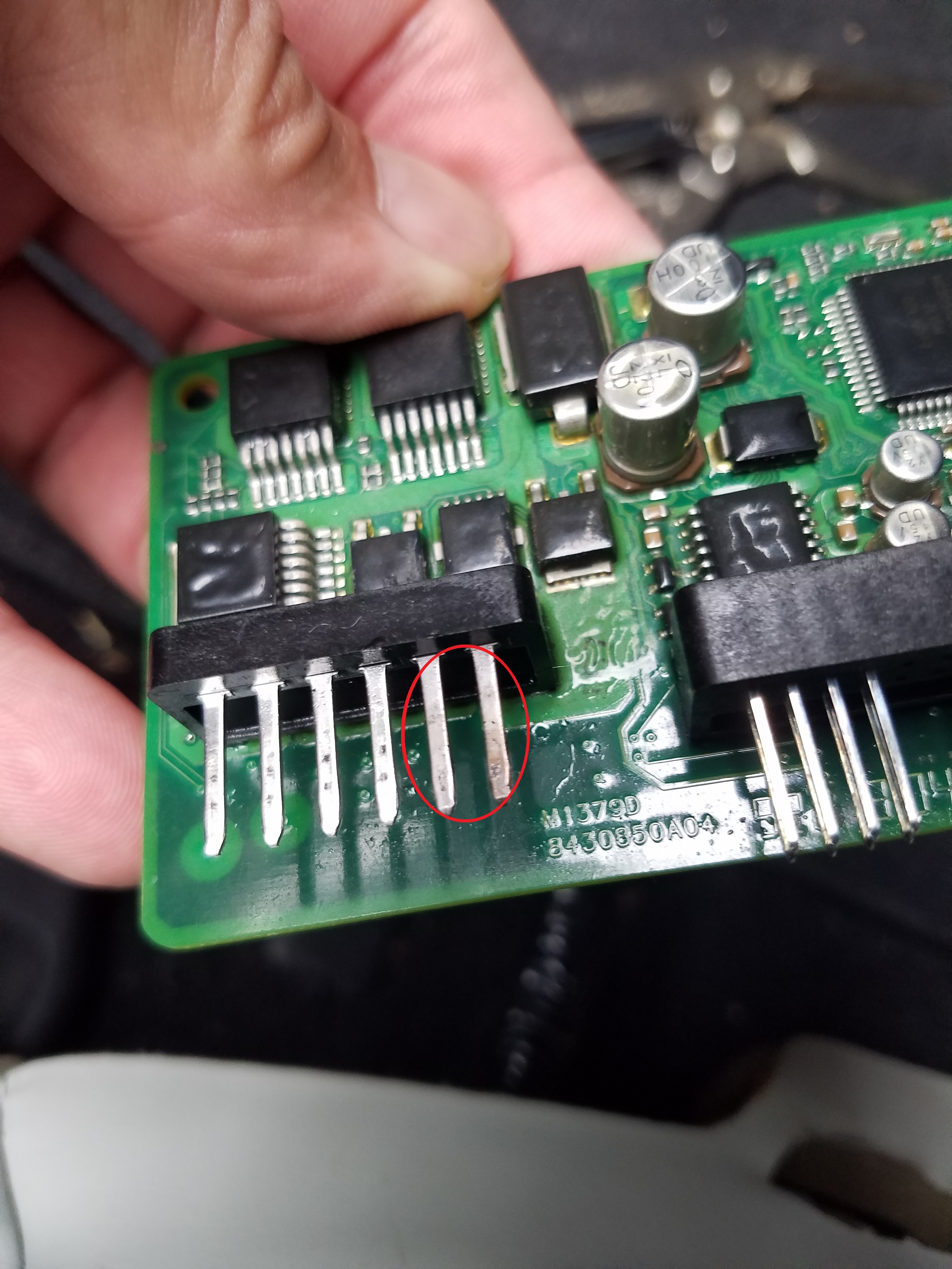

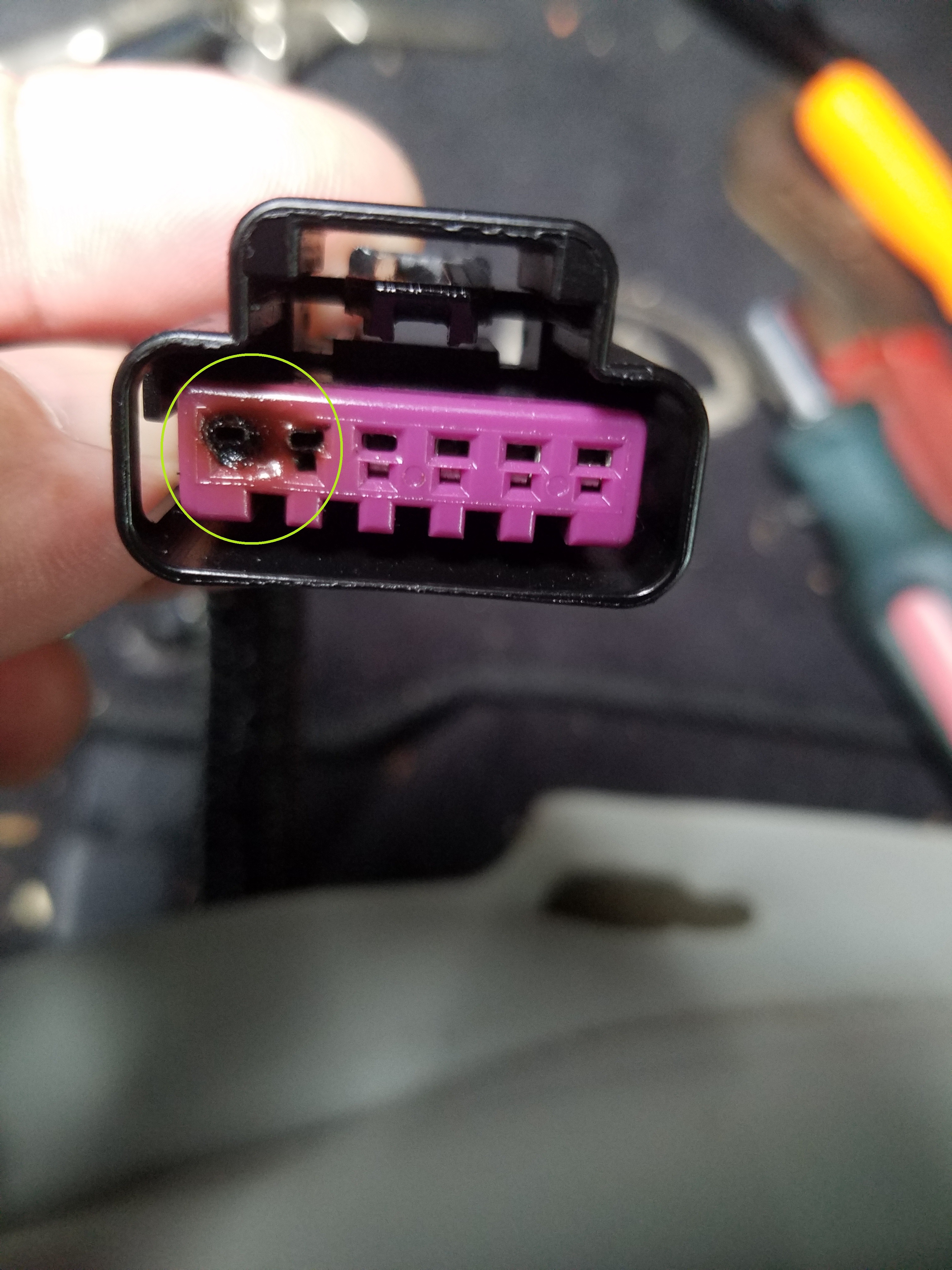

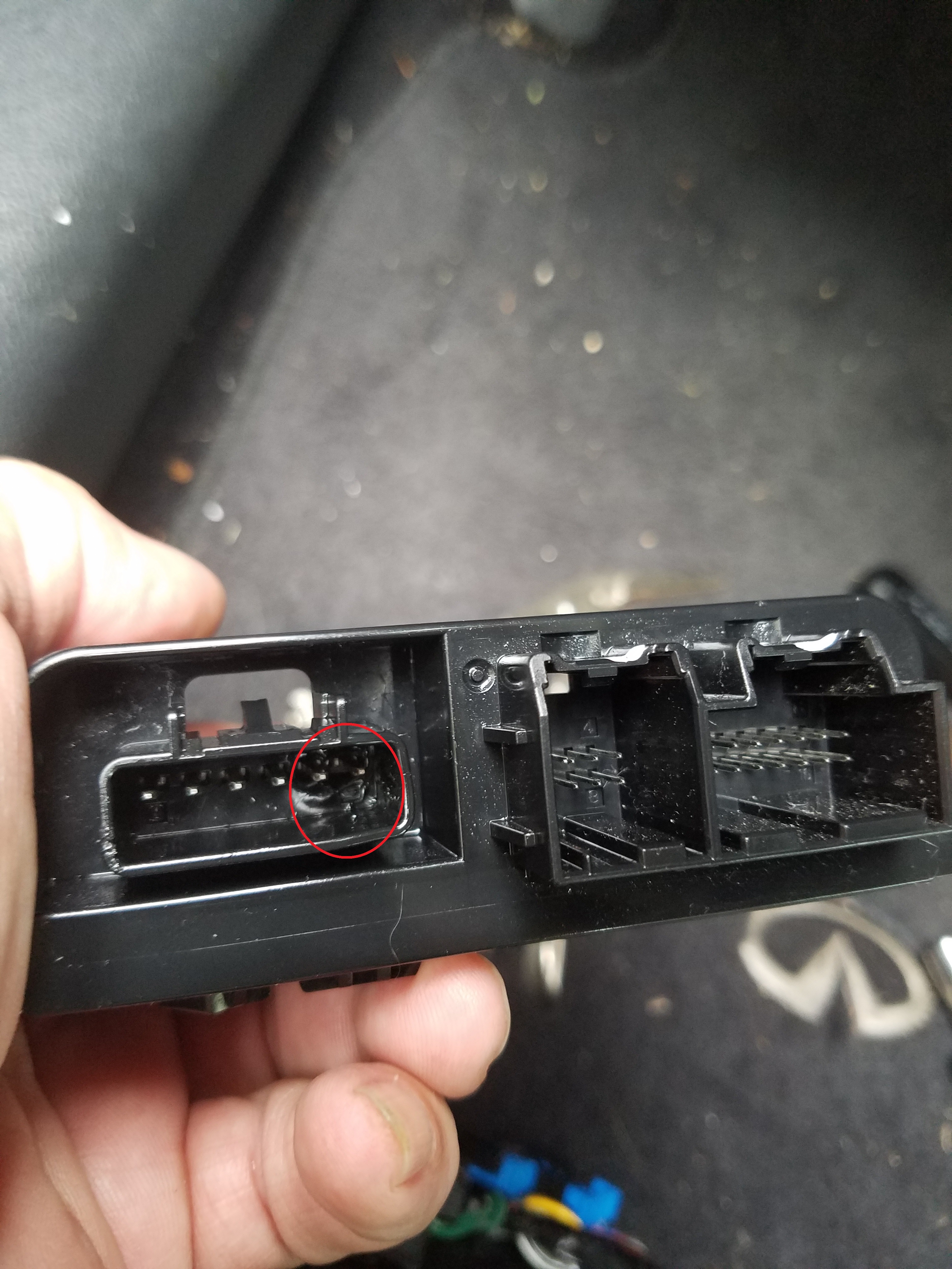

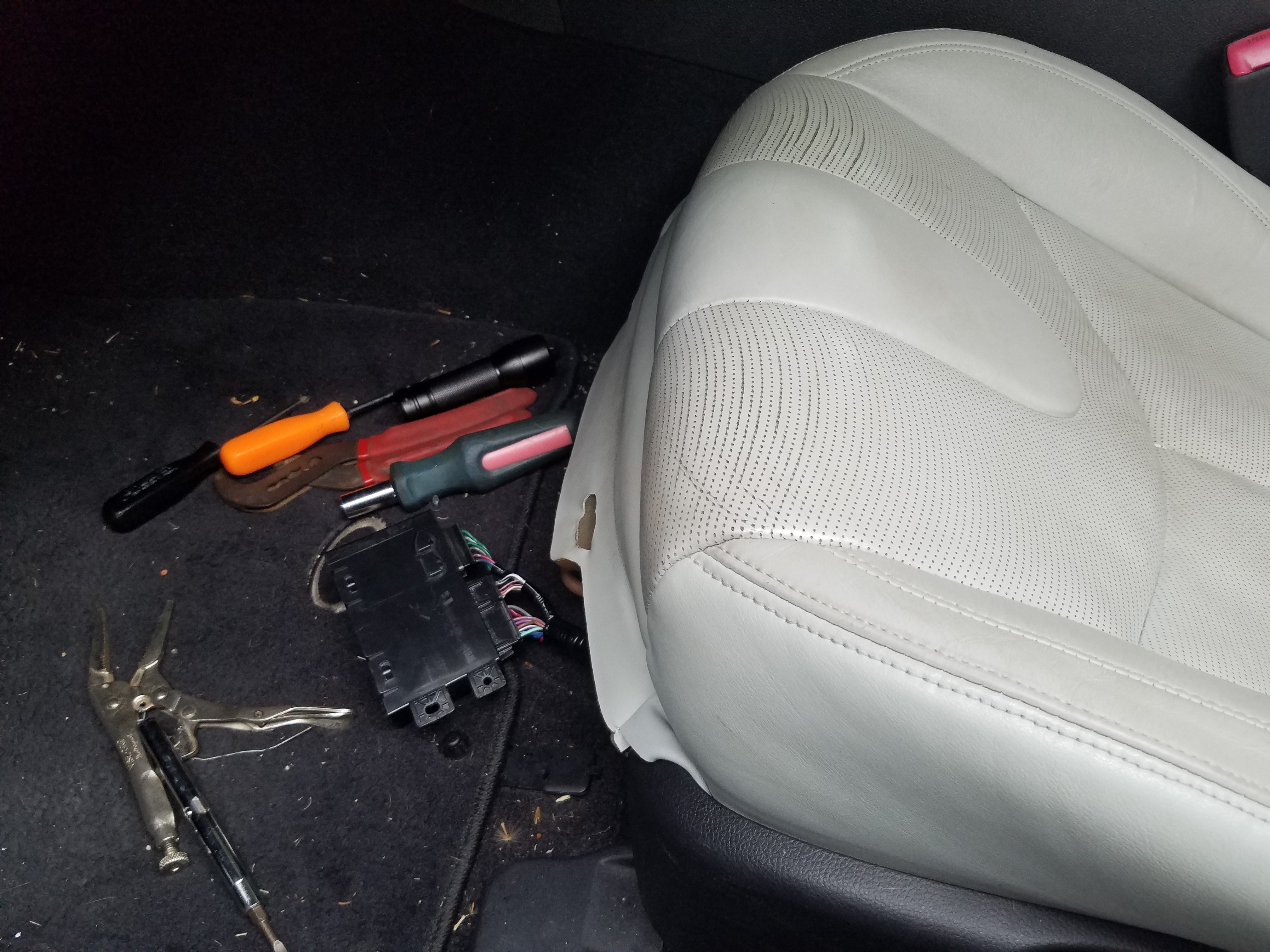

Climate controlled seats not working?
check the control unit under the seat
if the connector is hard to get apart it may be burnt

Did you end up replacing the connector?
Thanks for the pics!
Old Jun 20, 2018 | 07:56 AM
Warpig's Avatar
Warpig
Joined: Jan 2016
Posts: 9
No I just cleaned up the connector put some dialectic grease on it it's working now I know it will have to be replaced or modified
