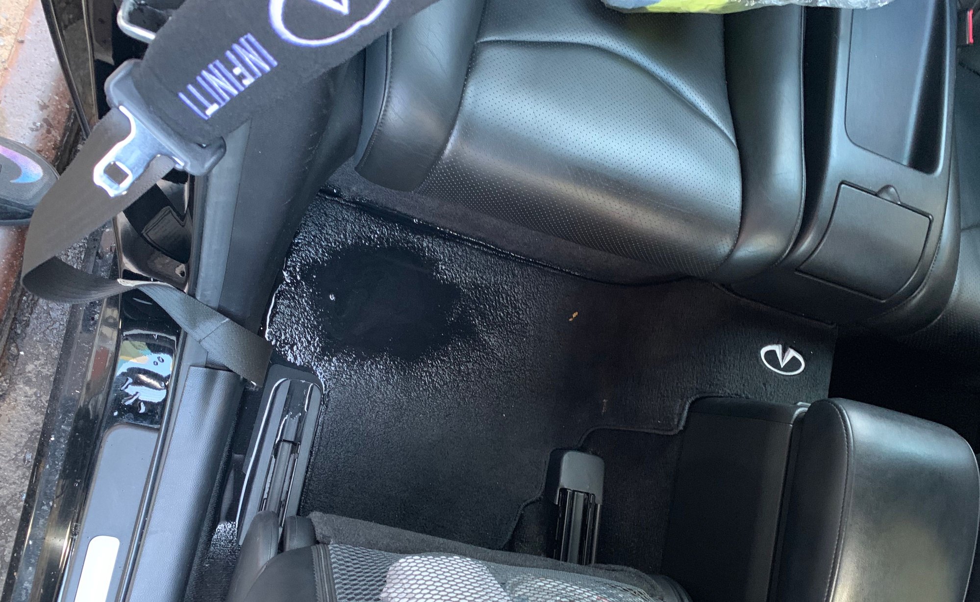

Old May 27, 2020 | 08:32 AM
  #60
Rozayy_23's Avatar
Rozayy_23
Joined: Aug 2019
Posts: 3
Water leak in 2014 Q60/G37

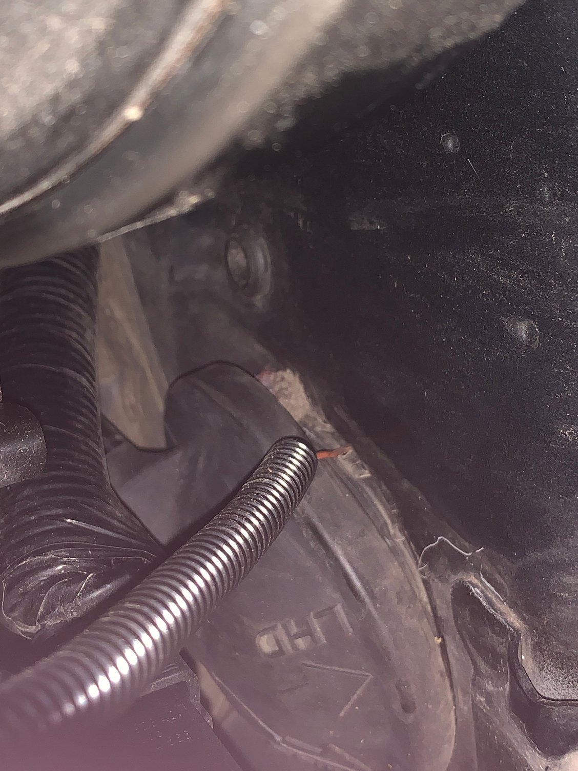

Hey guys sorry to bring up an old water thread. I wanted to share my issue with water on my driver side floor! A couple days ago it rained pretty hard here in Chicago. I noticed a humid smell coming from my car. I decided to remove carpet and what do you know!? Water! And lots of it. After doing extensive research. I found decided to check sunroof drain plugs. They seemed fine. I ended up popping out the small grommet that leads to the drain tube clean it out and installed a .25 inch tube for better water flow. I then put everything back and called it a day. A few days later, more rain. And more water!! I was getting ready to take it in to the dealer to figure it out. Then I read about a rubber grommet that holds wires on the firewall. So a few months back I got the illuminated Emblem installed on my grill. I followed the wire and guess where it went through? The grommet on the firewall! It was popped out about 50 percent. I popped it back in. I’ll be back with an update for water!
There you can see the wire running through the grommet.
