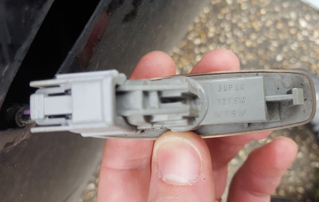

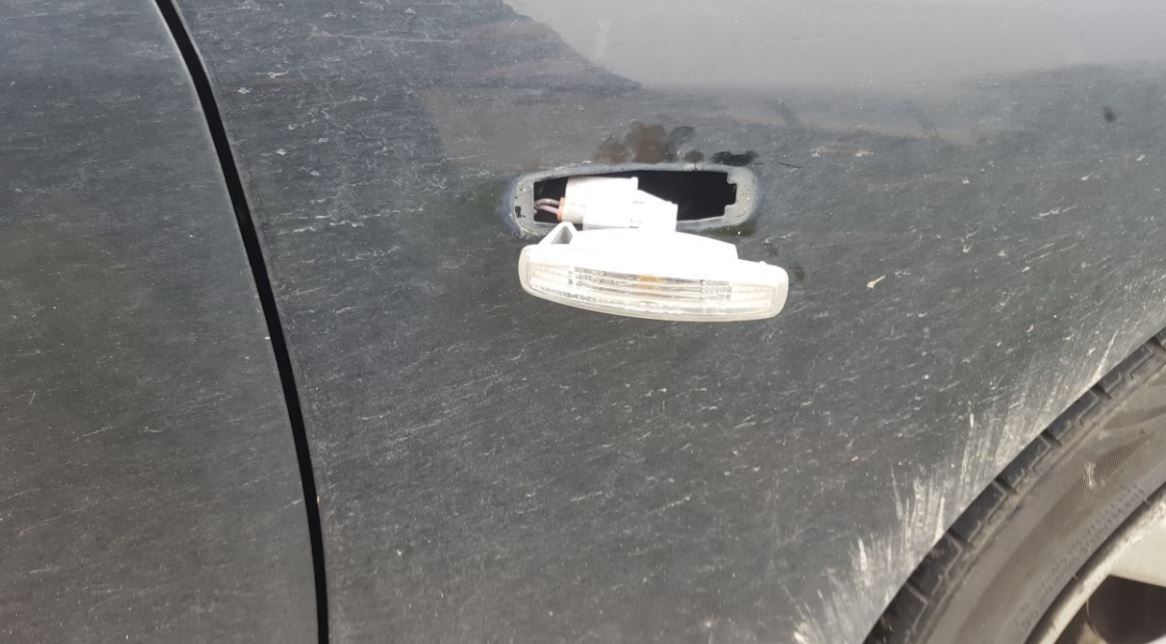

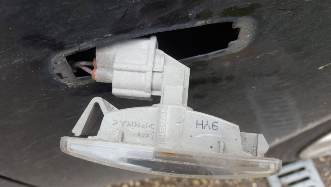

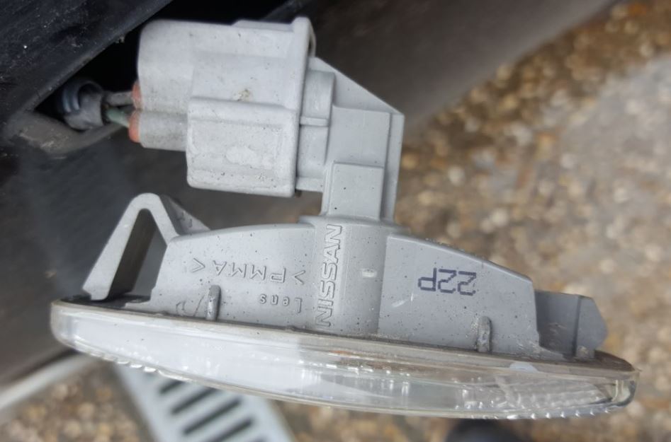

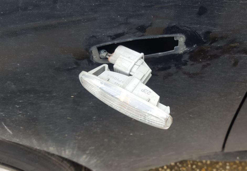

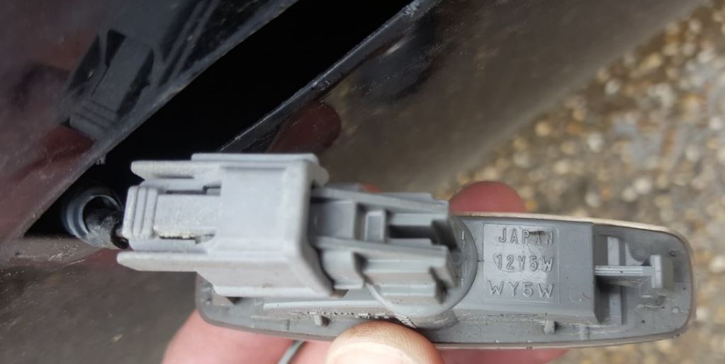

Here a a few pictures to show exactly what I am talking about. The first 3 are from the right side, the last 3 are from the left side (should it matter).
Right sidemarker pulled off
Right sidemarker (top)
Right sidemarker (back)
Left sidemarker pulled off
Left sidemarker (top)
Left sidemarker (back)

wow that thing looks like one piece to me

They appear to be one piece unless you're able to pull the clear plastic off somehow but like you said it's likely glued on. They probably just replace the entire thing if the light goes out. The bulbs you got were indeed side markers within the headlight housing, not for the ones on the fender. You can contact Diode Dynamics, they probably know if it's possible to replace those.
