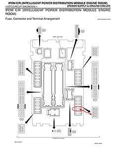

OK, take a look at fuse 59 in the IPDM - that one supposedly sends power to the DLR relay, which is located somewhere near your intake tube.
I'm not sure you will be able to simply add lighting without fuses complaining because each circuit is only set up to see certain loads and the more bulbs or LEDs you add the more it looks like a short, electrically. You may want to run another power source to the strips. Others here should have experience with this so maybe somebody point you in the right direction.

I've checked all those fuses. They were all fine. How would I check if it's a short?
