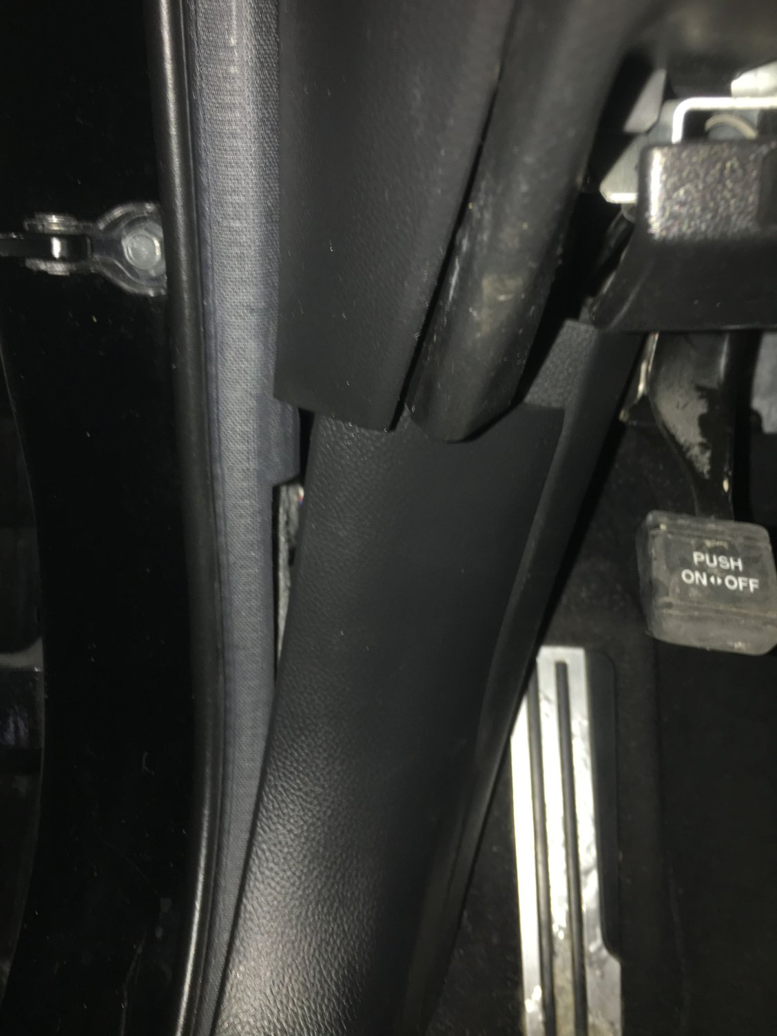

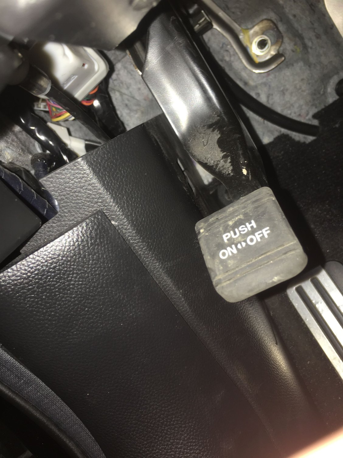

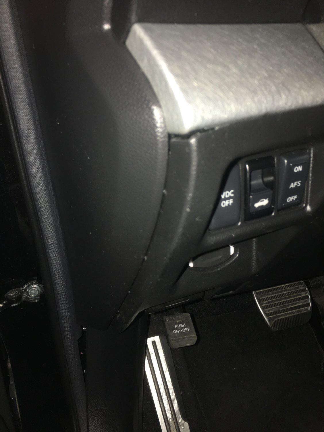

Hi I wasn’t sure we’re to put this but for some reason on the driver side my interior trim is falling part.any way of fixing it

pull the trims off and clip them back in. its either not clipped in or missing the clip. the side panel u can pull out and bend it so its more flush when u reinstall it. ive done it a lot of times. it jus easily deforms when uninstalling

thank you. Would you recommend I use something to pull it out or just pull it out

Pull cautiously with ur hands

Or just push the panels in

Pull the weatherstrip in the area where the kick panel goes. That area is two pieces. Pull the rocker trim then pull the kick panel. There is one push pin on the firewall and several on the rear of the trim. Inspect the pieces to insure that all internal push pins are captured. Install in the reverse order. https://www.ebay.com/itm/2008-Infini...5XMVQa&vxp=mtr
