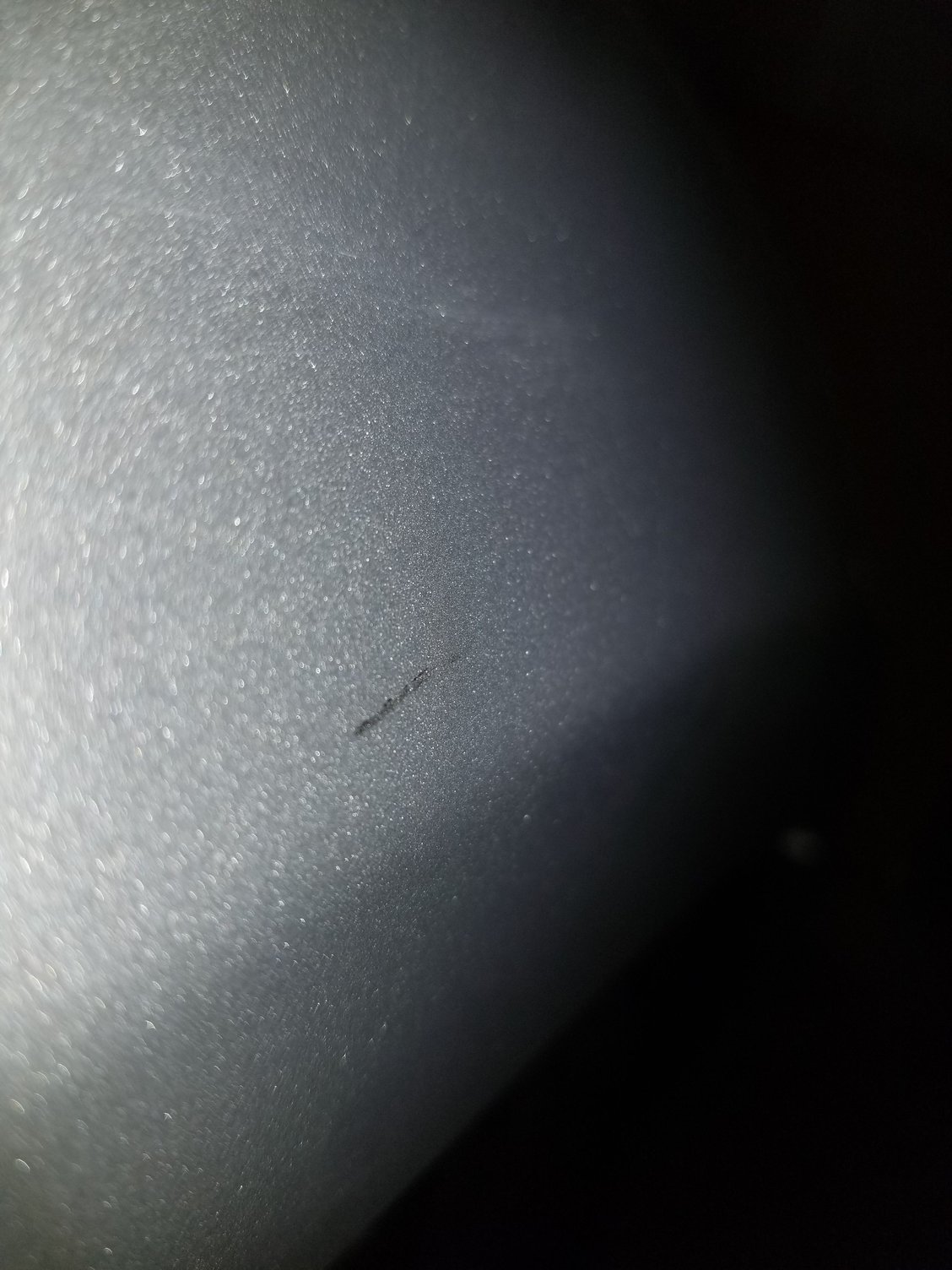

A Couple months ago I discovered two scratches on top of my G's trunk when I was washing it. The scratches were fairly deep and came to the conclusion that some low life had some thing to do with it. Earlier today I noticed scratches on my passenger side and it seems like someone side swiped it with their car or hit it with a shopping cart. Either way I pray for karma for the perpetrator. I always park far away from other cars. My car is always garaged kept at home, so I know for a fact this happened in a public parking lot. No matter how careful I am there is always that one person who some how finds a away to damage my car for no reason. I was thinking of taking it to the shop to have an estimate, but do you guys think it is worth fixing? I feel like people now a days are just careless and disrespectful. Something is telling me it can happen again. Any of you guys have stories or experienced this?

post pics. If its not through the metal could be fixable.

Not bad. Sandpaper and a high speed polish can go a long way on those scratches however if your nail can catch them good, no matter how good you sand and polish it's too deep and will still be there.....but less visually disturbing. Try that method and then some some pin point touch-up paint if needed and call it a day.

Looks to me that it's just the clear coat. Give this a try:

Thats just in your clear, some 1000 grit - 1500 - 2000 and a polish and you are good as new! I've fixed worse

That looks like a scuff that will easily polish right out.
Get you a orange pad and some Meguiars m105 or m205 or any consumer grade compound like Meguiars compound and it should come out easily.

You don't need freaking sandpaper! OMG. These suggestions are crazy. That is simple paint transfer. Plain and simple. A very small amount of acetone on a rag and that will wipe right off. Re-wax immediately. Done this many times.

Hey guys so I used Turtle Wax rubbing compound with a micro fiber towel and it did remove the majority of the scratches. I could still see small dents and slight scratches but I can never keep my car in perfect condition and I am learning to come in terms with that. Here are pics I wanted to share.
