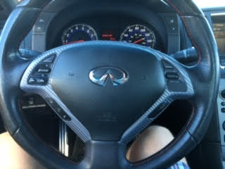

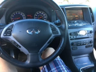

Visor recovering-steering-wheel-trim.jpg   Visor recovering-wheel-and-stack.jpg
