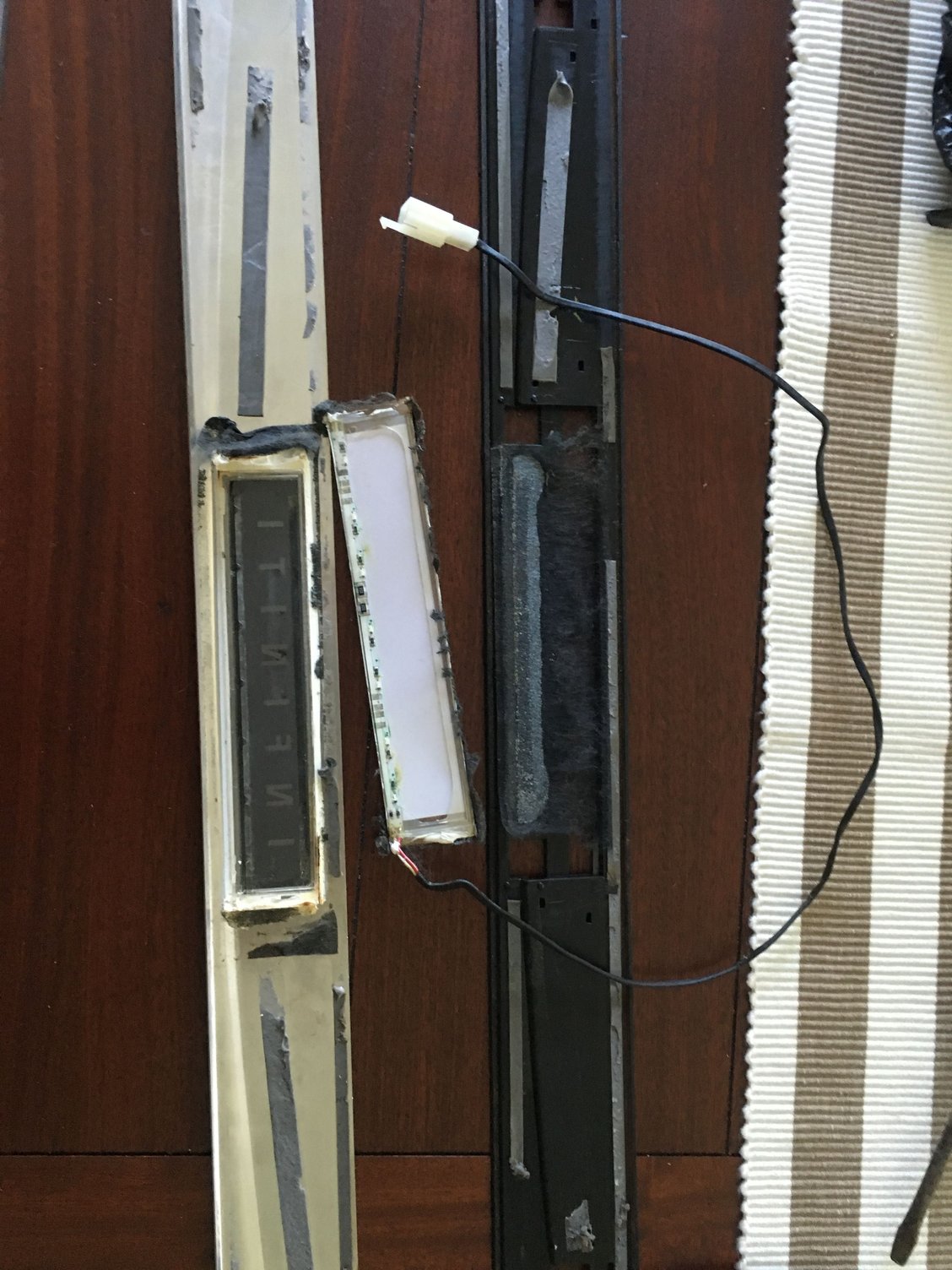

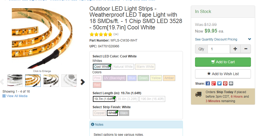

I am attempting to take the door sill apart and replace the LED with the items below. Im not sure how common this issue is but would anyone be interested in a write up?

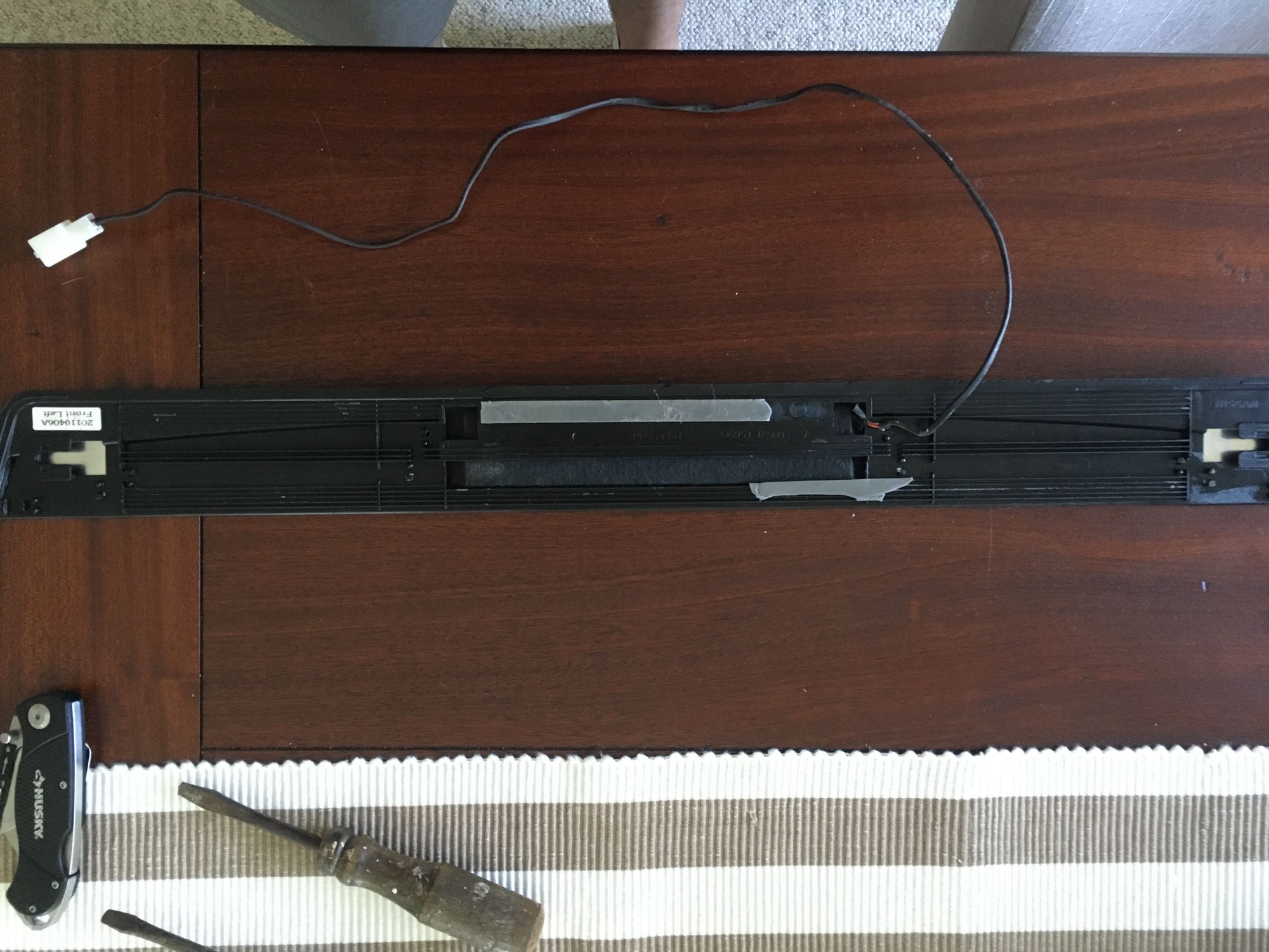

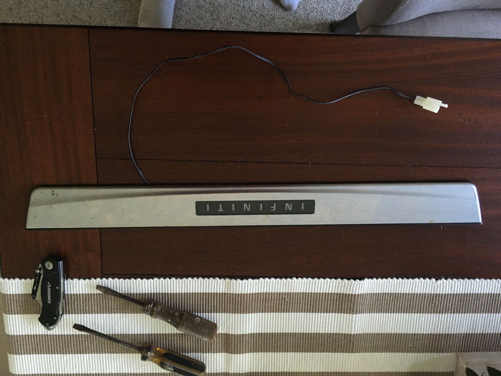

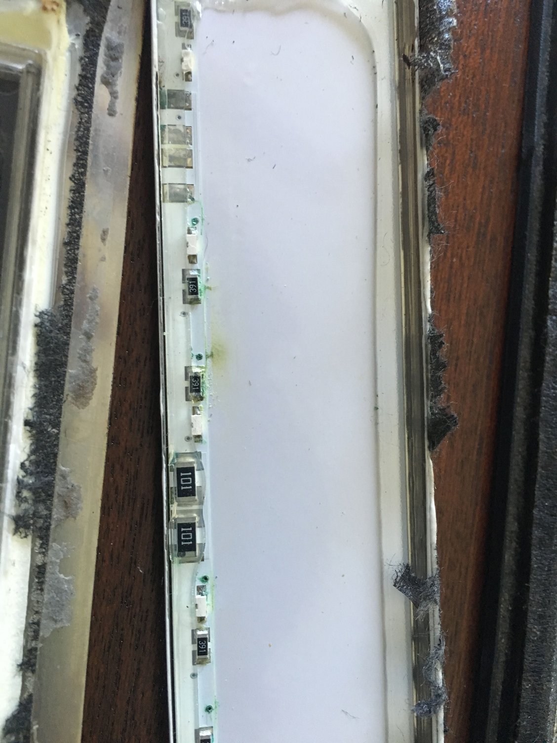

Looks like the LEDs i ordered should work perfectly. If they look too different or better/worse than the passenger side, I have enough extra material to change that too. And here is the guts....
