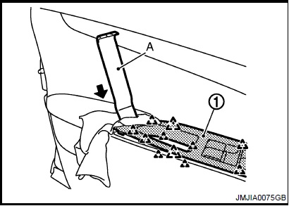

I had the same problem with driver door window switch.
It toke me about 15 minutes to solve the problem
Remove the switch (no need to remove the door finish)
Disansemble the switch, remove the electronic PCB from the switch plastic case, clean the PCB using brake cleaner spray, let the PCB dry for 5 minutes, reassemble the switch and install it back into the door. Problem solved.

Can the switch be removed by removing the panel on the drivers door and pulling out the switch?
Old Jan 12, 2017 | 01:15 PM
Elco's Avatar
Elco
Joined: May 2010
Posts: 307
Likes: 37
From: Romania
Yes. You only need to pull out (up) the switch assembly.
No need to remove the entire door panel.
Check the service manual for more details.
