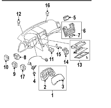

Replace Cluster Lense
Has anyone here replaced or know how to replace the instrument cluster lense? The previous owner must have dusted it with steel wool, it's all scratched and a replacement is under $30. Part #3 in the diagram

what about using one of those headlight restorer kits? The ones where you use a drill and progressively lighter sand paper?
I have a feeling that even if you get the cluster out that the lens is prob glued somehow to the binnacle itself and would require some surgeon like precision to replace without Fing up your gauges.

The fact that they sell the replacement cover would seem like it would be something that could be R&R'd without too much trouble, but the million dollar question is how ????

I've taken apart my old Altima before, the cluster is not glued on. They are just clips holding it in.

I think it's just clips. However, try reaching out to botlfed98. He had a listing in the FS section for a modified gauge cluster. Probably knows how to remove it quickly and easily.
