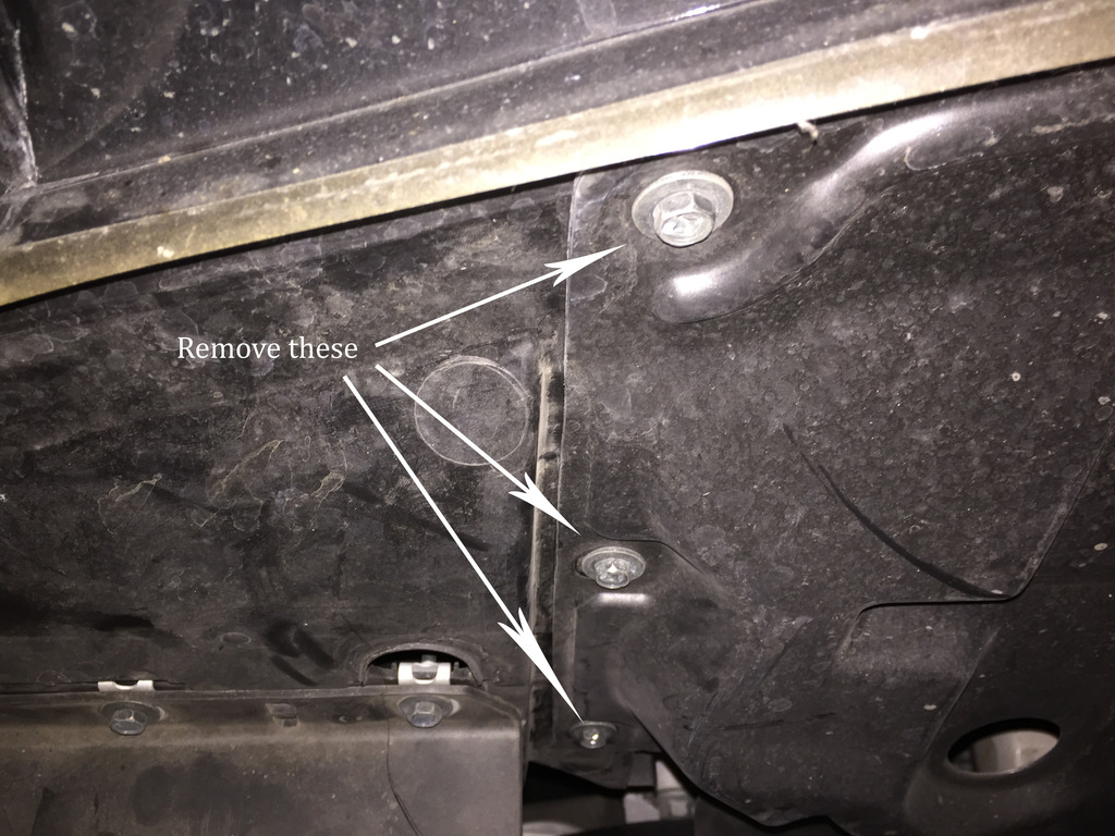

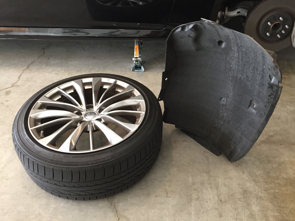

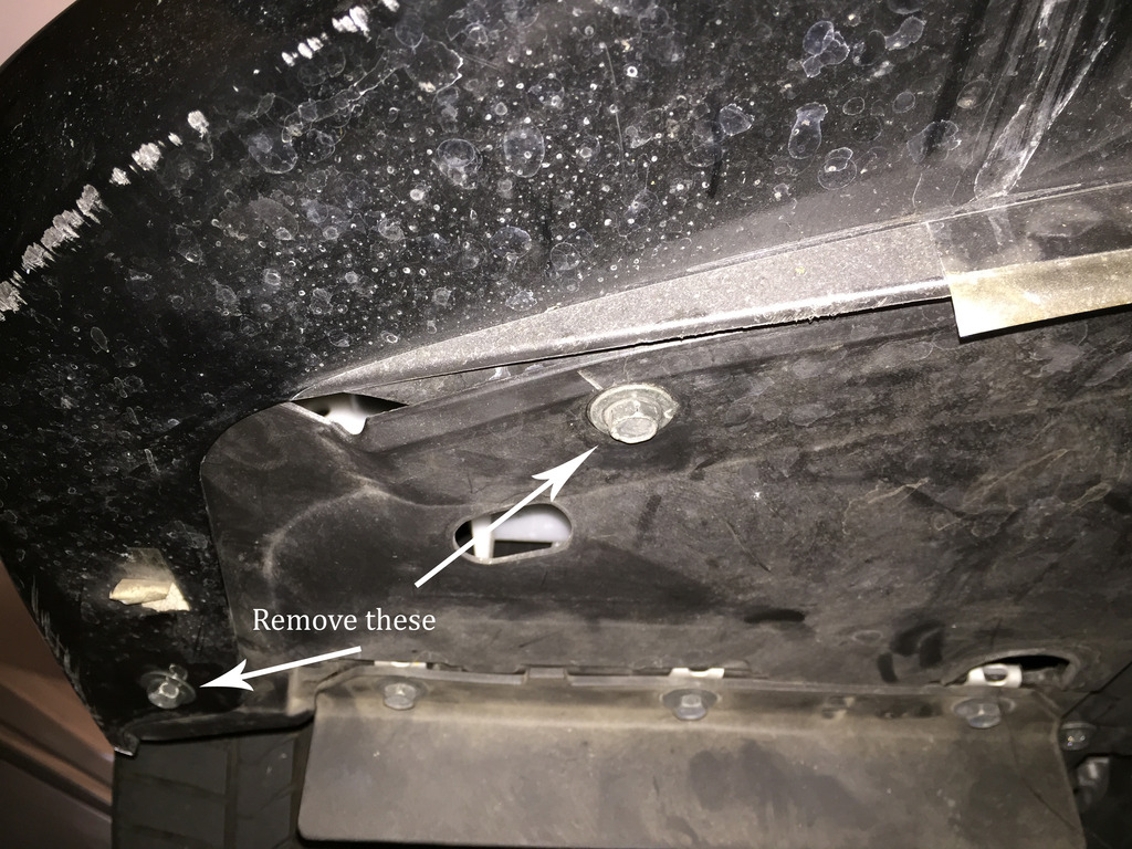

If you want to swap out the fog light bulb on the passenger side of your G coupe, you’re going to have to get under your car. I actually took off the wheel and removed the entire fender liner. Not only do you have to unclip a bunch of clips on the inside of the liner, but you will also have to unscrew five 10mm hex screws under the car.

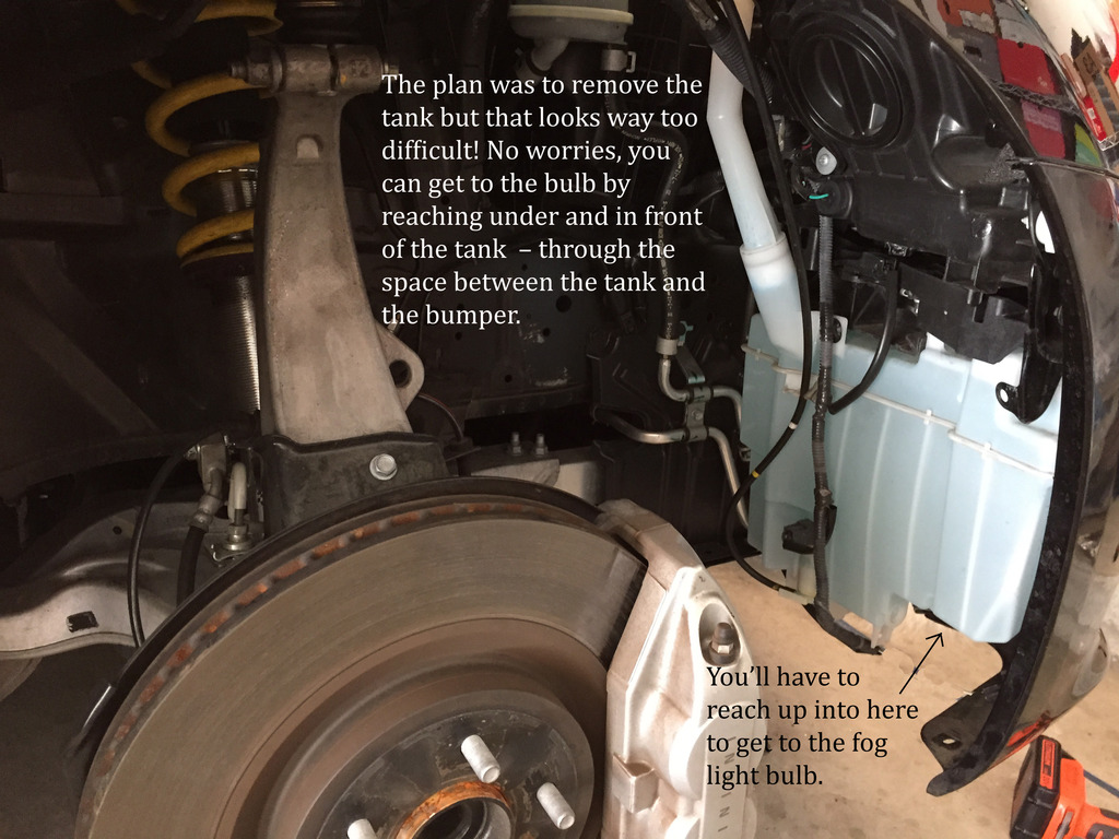

I did this because I was planning to remove the window washer fluid tank and wanted plenty of space to work. But once I saw all the wires and other parts in the way, I nearly gave up.
Then I stuck my head under the bumper and looked up into the space between the tank and the bumper. From there I saw the plug for the fog light and there was enough space to reach up and pull it out. So did I really have to take the entire liner off? Probably not.
Now I know that you have to just unscrew the hex screws from underneath the car and enough clips on the inside of the fender so that you can slide that liner back to get your hand up in the space between the fluid tank and the bumper.

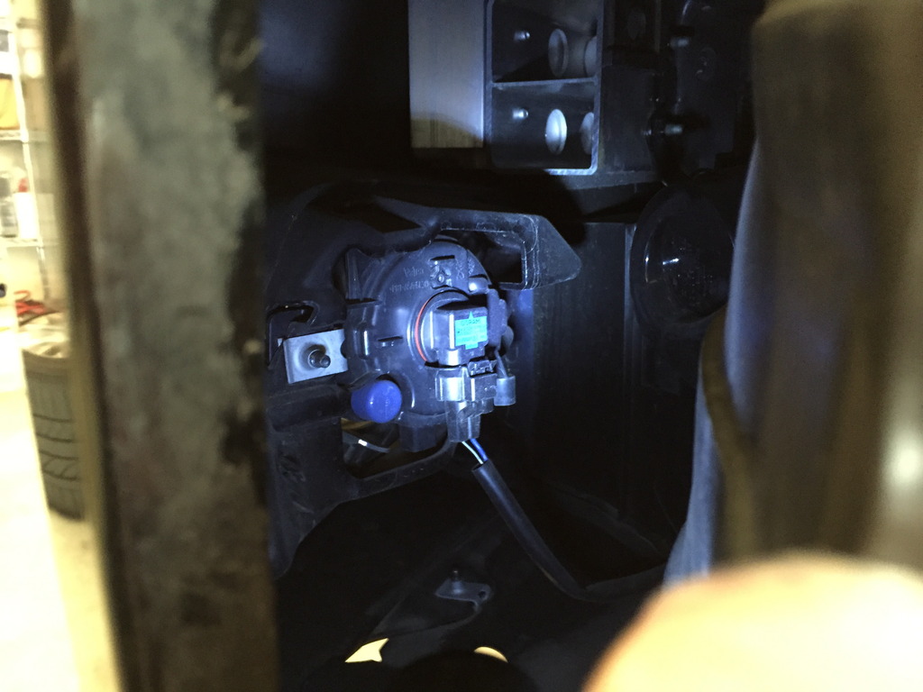

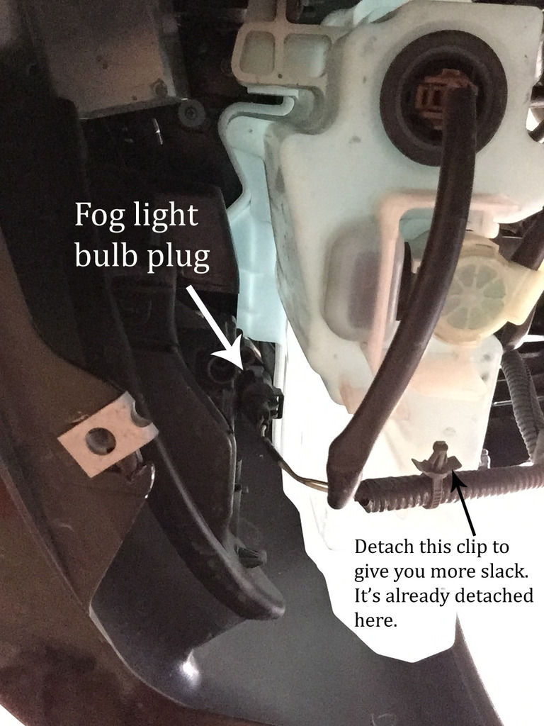

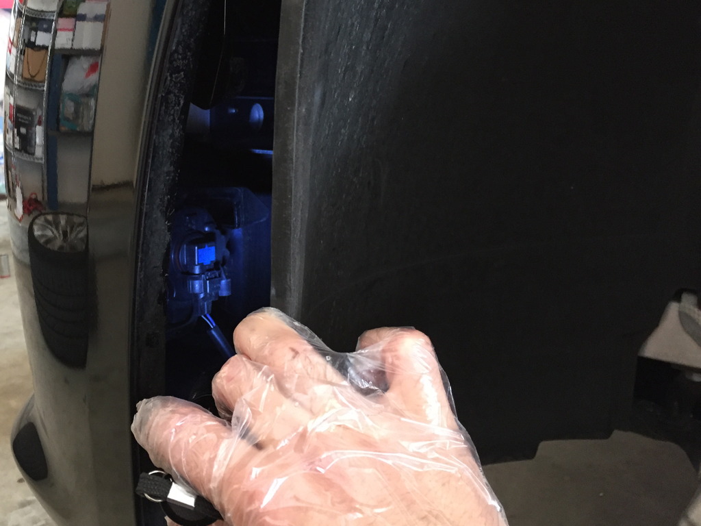

This is the view of the space between the tank and the bumper as viewed from under the car. So imagine you are on your back looking up with the top of your head pointed towards the driver’s side. The two skinny wires lead to the fog light bulb plug. In order to turn the bulb to get it out, I popped of the little clip holding the wires to the bottom of the tank. That gave me more slack so I could turn the bulb. There’s just enough room to reach up, turn the bulb about ¼ counter clockwise and pull it out.

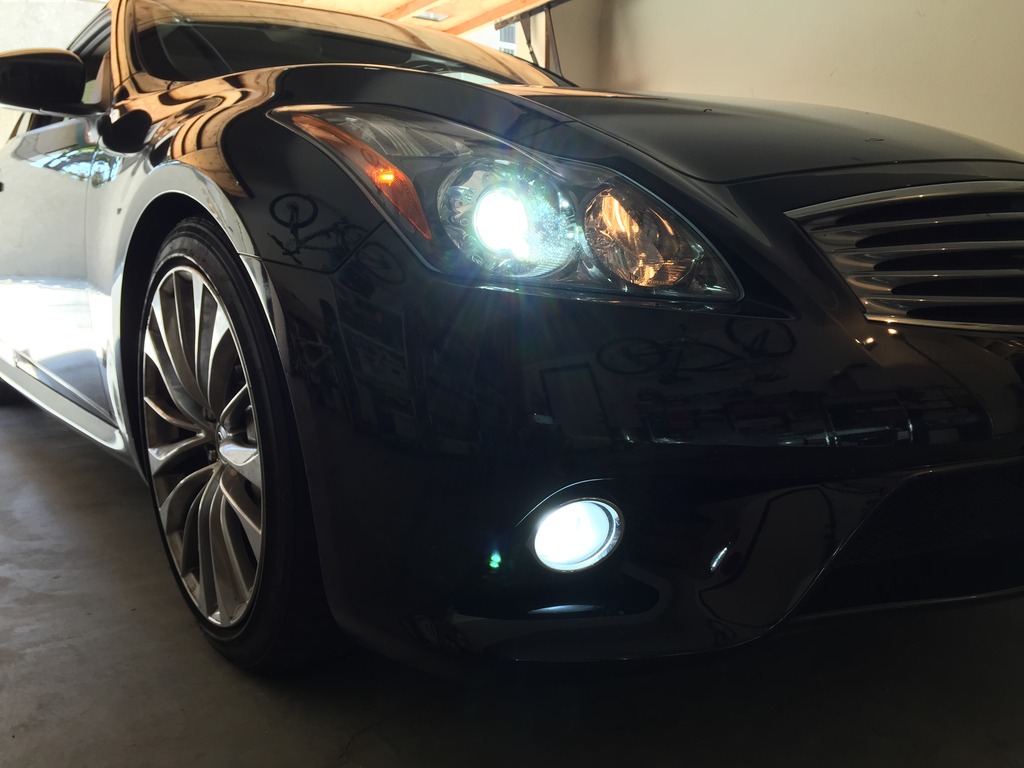

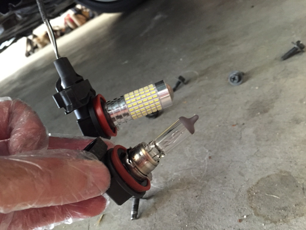

Once it’s out, swap in the new LED and test it. Here is the new LED bulb (plugged in) compared to the old halogen.
Putting the new bulb back up in there was a little challenge. You have to align the tabs on the bulb housing to the slots on the fog light housing. But because you can’t see from this angle, you just have to go by feel.

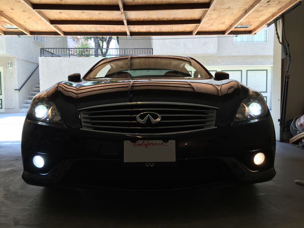

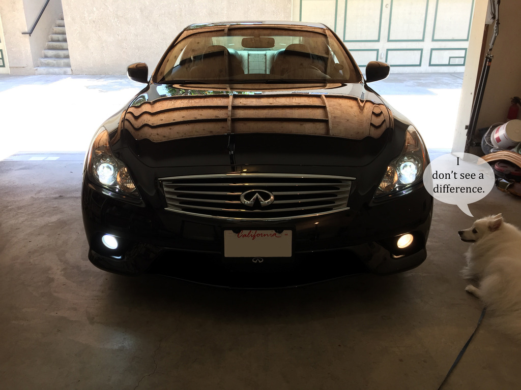

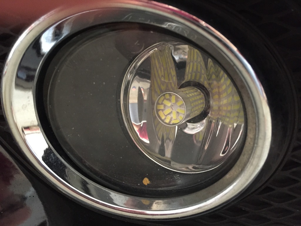

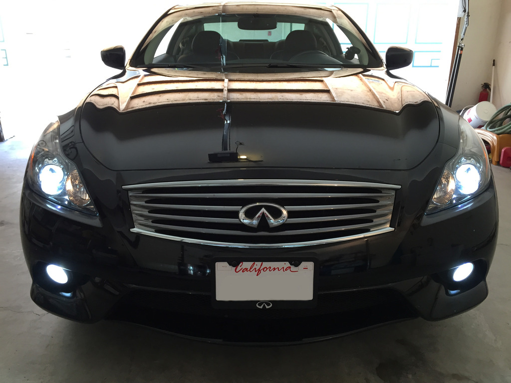

Passenger side installed! Pretty good color match!

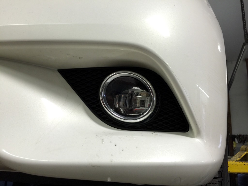

As for the driver’s side, it was much easier. I still lifted the car and took off the wheel just to give myself more space, but you can just try turning the wheel in all the way. Pop off a few clips, peel back the liner, and you’ll see the fog light plug.
Reach in, turn it, pull it out, swap, test, reinstall, done!

The headlights are stock. I haven't seen any document with the actual color temperature of the stock HIDs, but I've read threads that say they are 4800K. The LED bulbs I installed are 6000K according to their description on Amazon.
Amazon.com: JDM ASTAR 1200 Lumens Extremely Bright 144-EX Chipsets H11 H8 LED Bulbs with Projector for DRL or Fog Lights, Xenon White: Automotive Amazon.com: JDM ASTAR 1200 Lumens Extremely Bright 144-EX Chipsets H11 H8 LED Bulbs with Projector for DRL or Fog Lights, Xenon White: Automotive
They look pretty close to me.
