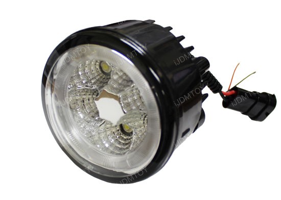

Are these the ones you bought?
Nissan Infiniti OEM Fit 18W LED Fog Lights with Angel Eye Halo Rings
I've been on-again, off-again interested in those since I first saw them online. Can you describe the outer lens please? Is it smooth, or sculpted? Does it fit flush with the assembly at the edge, or is there a gap? I'm asking because I like having amber tint on my fogs, and am wondering if that's still feasible with these.
Also, if it were me, I'd pass on the stand-alone halo, and prefer it be wired to go on with the fogs themselves. I'm guessing that's easy enough to accomplish, yes?
Hoping you take pics off the car and on the car.
Hey Rochester,
I actually have these installed, its kind of what started me on this unparalleled personal path of modifications I've been on for almost a year now. They're of reasonable quality, the surface is smooth glads, I've had them on for a year in October, and they've held up very nice. They do fit flush for the most part, however I remember one fitting a little loose (it wiggled a small amount) in the plastic fascia so I believe I tucked a piece of folded electrical tape underneath the bottom and it's been fine ever since. The other side fit spot on! I hardwired them in with my fog lights so when you turn on the fogs it is the main high output led (like your regular fogs). Then when you switch the fogs off it is only the halo that lights up (yes the halo is always on then, this is the design of their unit). I went in through the back fender using just rhino ramps, however that was a pain in the a**, but I was to nervous to take the bumper off back then... lol ohhhhhh how things can change in a year. Anyways with the halo I was hoping it would be bright white like the main led, unfortunately it appears more of a bluish tone, but I actually still like it quite a bit. I'll attach a pic, not the greatest, but it's what I have.

Oh and you will need to buy extra wiring as the wire you see in the pic is all you get, I think I used 22 awg if I'm not mistaken. Any questions I'm glad to help, as you have helped me numerous times already

Old Jul 23, 2015 | 09:34 AM
Posts: 19,846
Likes: 5,143
Extra wiring if you want to wire the halos... is that what you mean? Pretty sure I'd just tape them up and ignore the halos. Not a halo guy.
