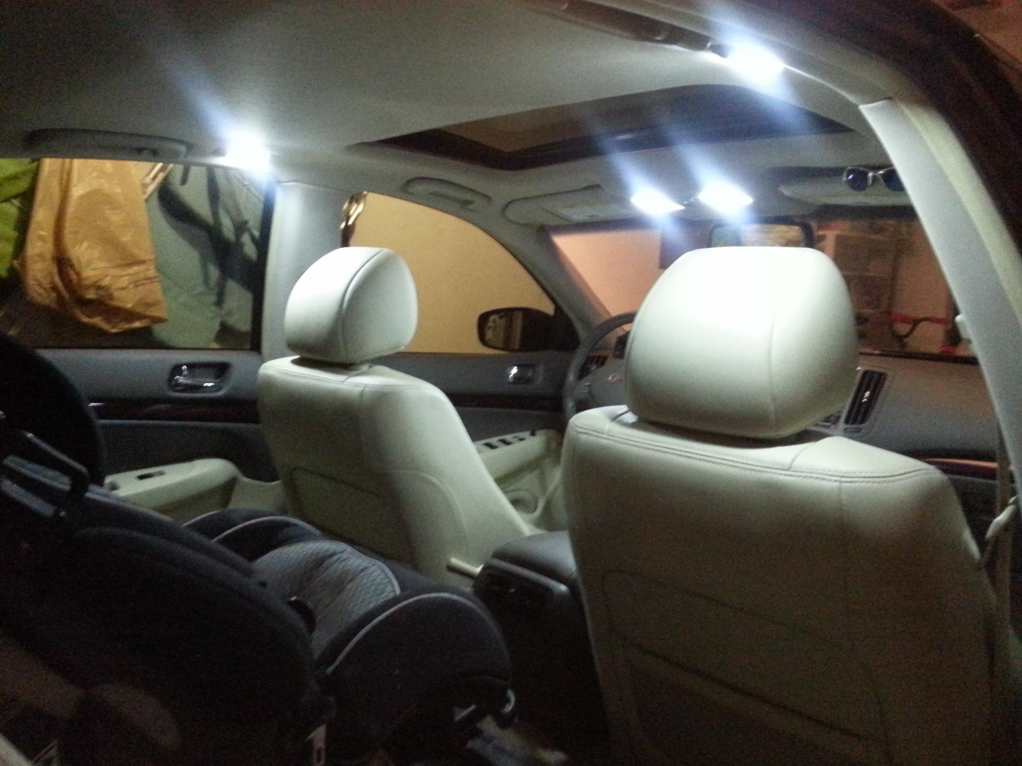

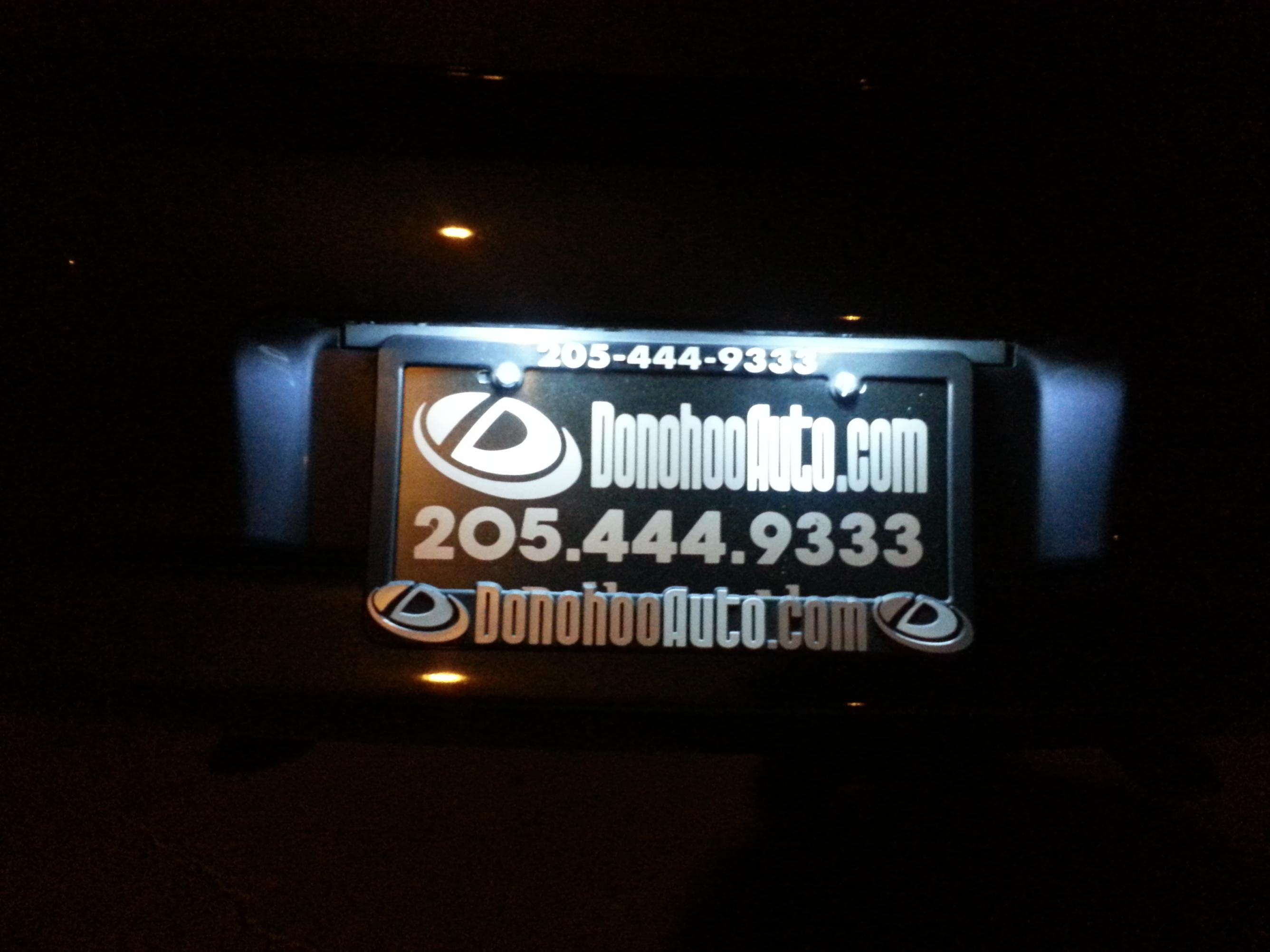

interesting.......Never had that happen. Sometimes you have to flip the LED around.
Attached Thumbnails Interior LED, license plate light-20150330_214858.jpg   Interior LED, license plate light-20150330_214918.jpg   Interior LED, license plate light-20150330_214202.jpg
