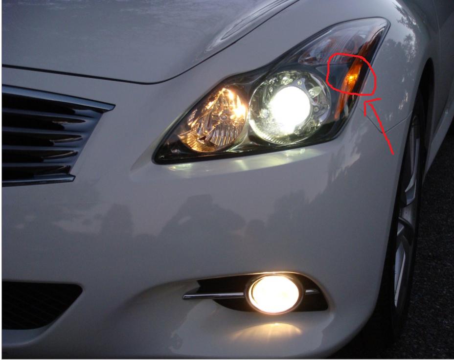

Sorry guys! I have been searching online and on forum but I don't see anyone asked or review how to change this light bulb. I tried going in from top, I cannot even see or reach anything close to that bulb. When I pull off the fender from wheels, I won't be able to see that bulb too...I had access to turn signal, hid, city and drl...but not that reflector light bulb....I really need help...anyone has experience?
Please click and enlarge the picture below if you are unsure which light am I talking about!

i have changed this light.. but i had the lights out when i did it..
if you look at the headlight as it's mounted, look for the guide pin in the fender.. you should see a gray plug with a green and green/yellow wire coming out of it.. this is the blinker.. the side light is lower, and behind (towards the fender)
you have a few options as you can't really get a hand in there to access it..
1) remove the intake filter boxes to give you some room to get a hand in and try and reach under and behind the blinker.. it has a tab very similar to the city light.. so feel for that and twist
2) remove the wheel well plastic and access the back of the headlight this way
3) remove the headlight entirely
