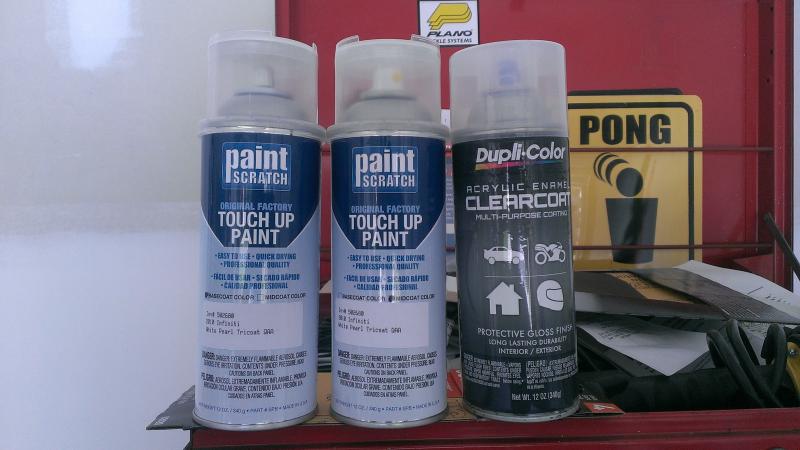

So I decided to paint my non sport front lip myself, seeing as Moonlight Pearl is very expensive to have matched. I went with Paint Scratch for Factory OEM color match. The kit comes with Basecoat and Midcoat(Pearl) roughly $80.

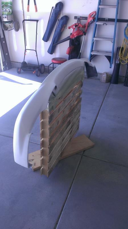

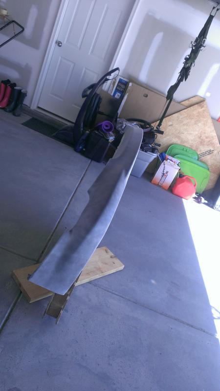

Started by prepping with 600grit on the bare piece, followed by adhesive promoter and white sandable primer.
Now onto Basecoat, I wet sanded first with 400grit and then 600grit before the base went on.

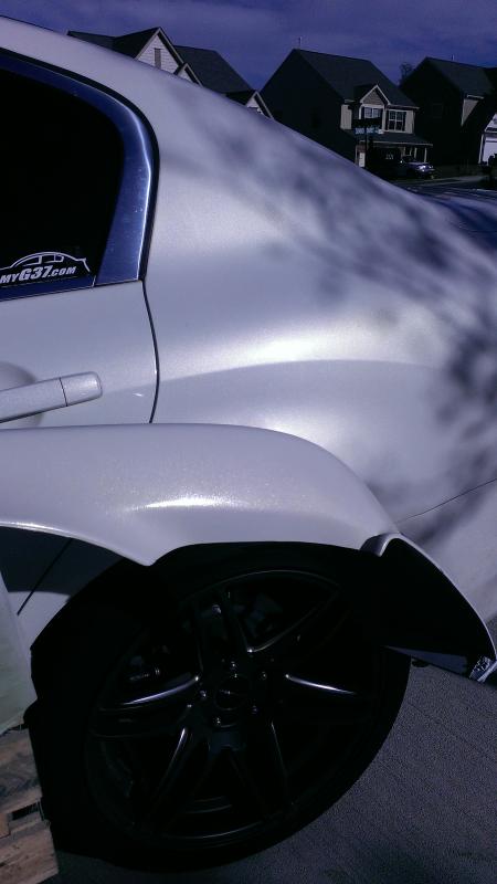

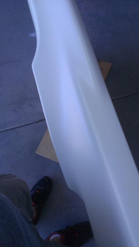

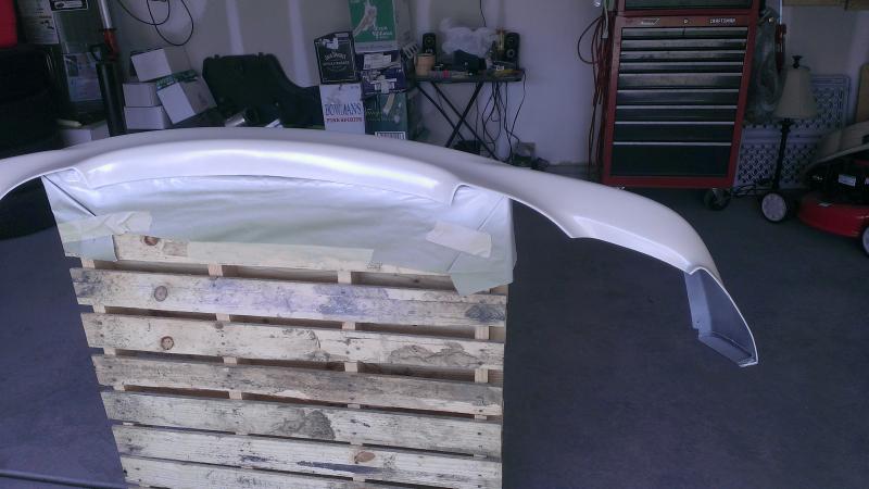

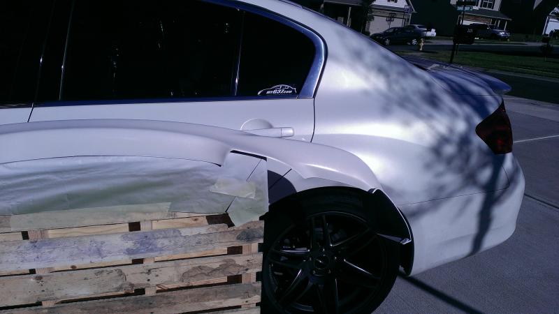

Now onto the mid coat, this is the hard part because after each coat you will need to compare to your current paint on your G. In the sunlight and in the shade for perfection.

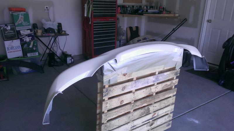

Once the pearl is where you want it, seal it up with some clearcoat, I did about 6-7 coats so that I could sand and polish later.

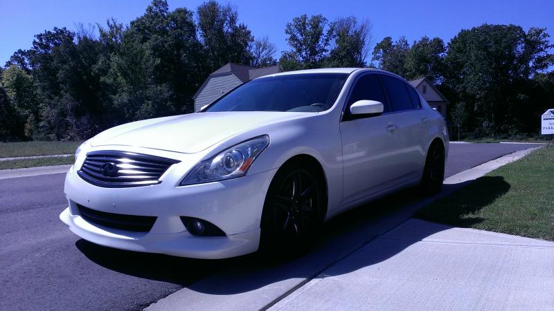

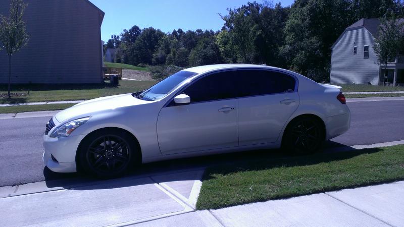

Final Product
Let me know what you guys think.

Looks good! Nice creative way to do it. I'm sure it saved you a couple hundred bucks in labor.

Nice work. It does look like it matches up pretty well from the pictures

The kit I got was barely enough to do the lip, if your doing just a grill then one can is perfect. At least you won't need that second can(pearl).
The match is about 90%. Not perfect but hey it's a garage job.

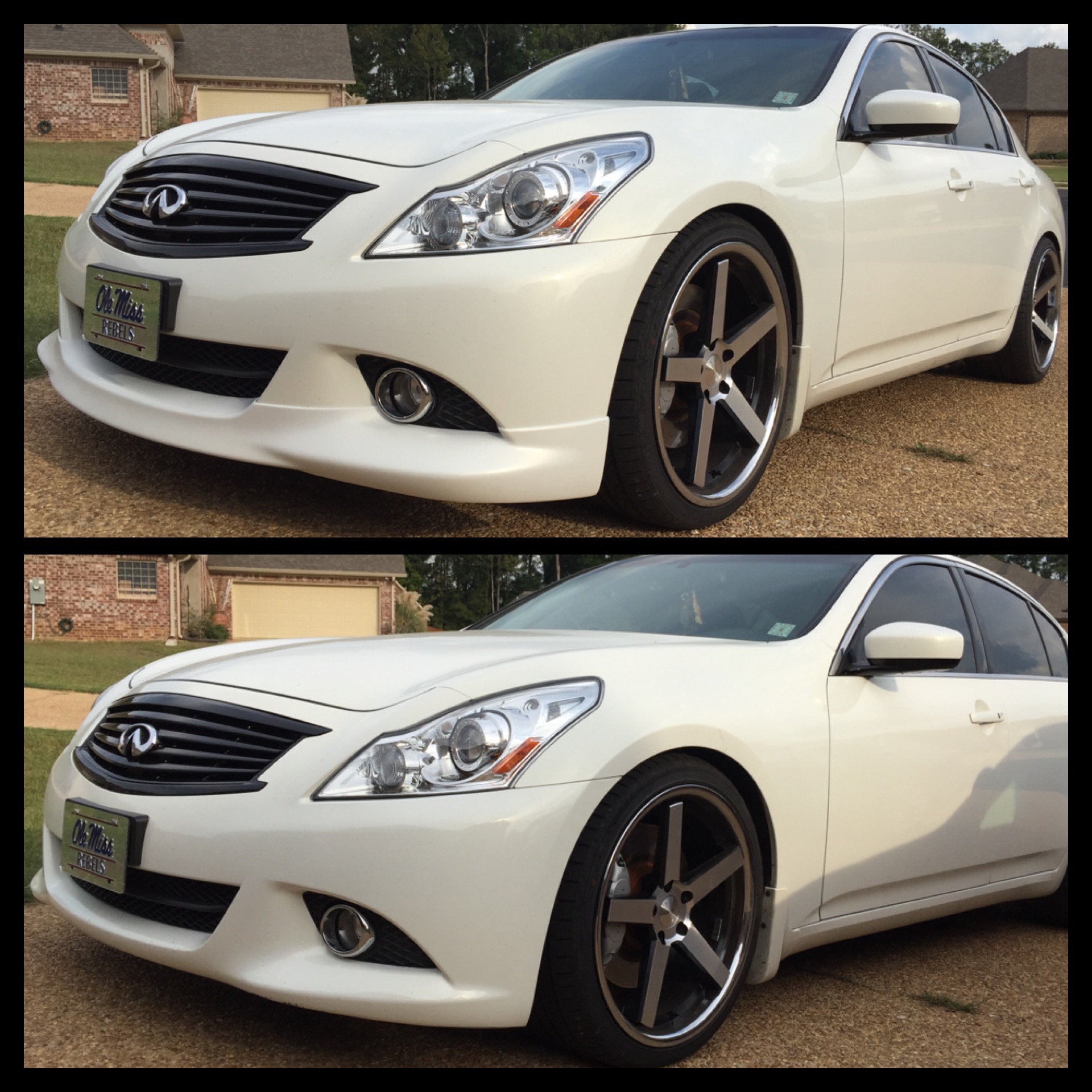

Old Oct 8, 2015 | 09:51 PM
GFTW's Avatar
GFTW
Joined: Aug 2014
Posts: 146
Thank you for the idea! I did the same thing with my car except for the paint products. I went with automotivetouchup for the base color and 2k topcoat. Ended up paying a little over $100 because I bought some other stuffs too like a respirator and sandpaper. Still cheaper than $250-350 quotes that I got from the local body shops.
As far as matching goes, I want to say it's about 80%-90% match. It's a little brighter/whiter than the factory paint but you can't really tell if you stand 5 feet away. Anyway I'm happy with the result.
