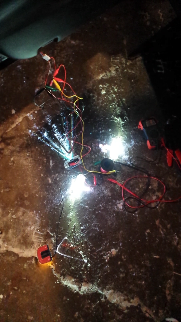

BTW mine is a 2013, i got curious and wanted to see what would happen if i plugged in more projectors... i plugged in 5 and the trunk still worked. Btw if u have a multimeter or something, check the current.

lol yea i added a door to the roof.. sorry .
serious face: No i attached 4 of the projectors to one door with wires and alligator clips.
