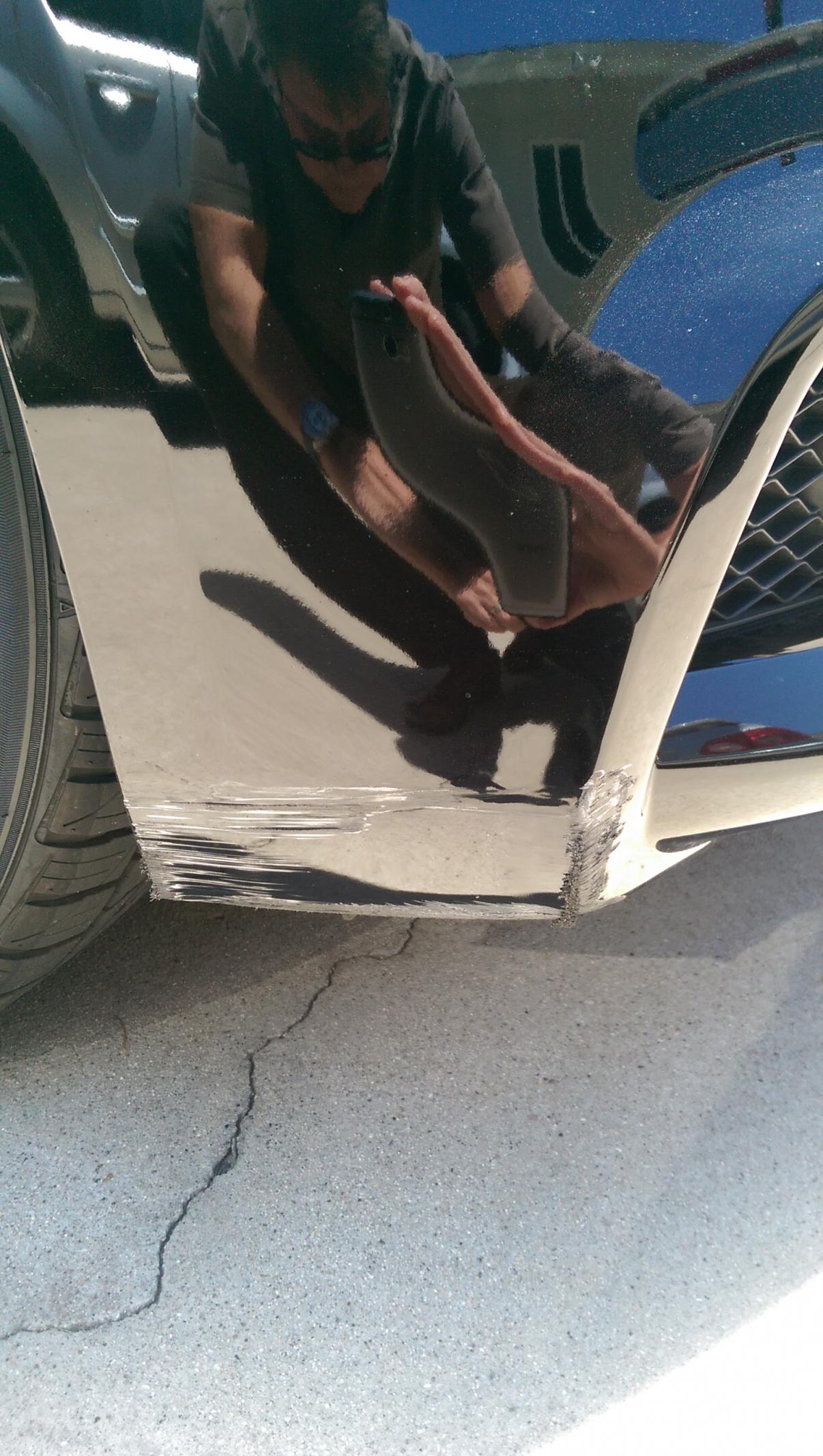

Damage to bumper

Originally Posted by GeezerB
Damage to bumper
The OEM spoiler might just cover that....
Old Jun 19, 2014 | 07:15 PM
warped ideas's Avatar
warped ideas
A quarter past stripped
Posts: 1,695
Likes: 374
From: Pembroke Pines, Florida
+1 on that idea. The OEM Sport bumper lip will run you $300-$400. It looks like that could very well just be covered up.
Can you elaborate?
Infiniti offer a factory chin spoiler accessory for sport and non-sport sedans. You can see some before and after pictures here;
https://www.myg37.com/forums/g37-sed...and-after.html
Places like Grubbs Infiniti sell them for $360 and there's nearly always a 20% coupon available bringing the price to $288 before shipping. These are factory spoilers in the correct color for your car and while it's hard to be 100% sure from your picture, it looks they would cover your scrape;

Wow, this is great! Thanks for your suggestion. I think this will work. Now to find one.

Thanks guys for steering me in this direction. I just ordered one from the dealer I bought my car from. $360. Now I have to find a place to install it. Pick it up tomorrow.
I will test fit it first & report back.

Just did a test fit. Covered the damage 100%.
Almost glad I hit the curb as I would never have known about this. Malbec is a hard color to repaint, so this factory painted spoiler is perfect.
