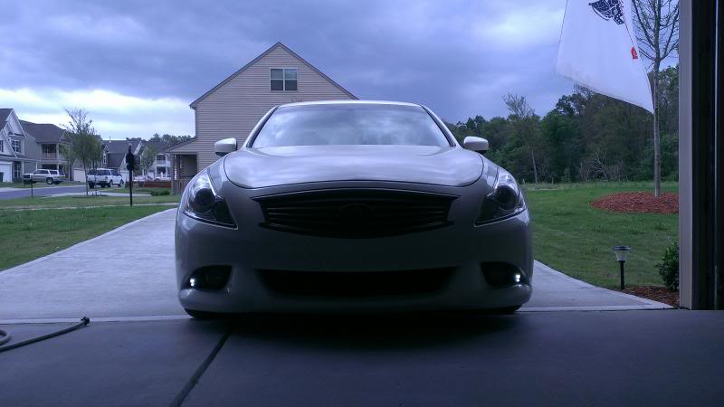

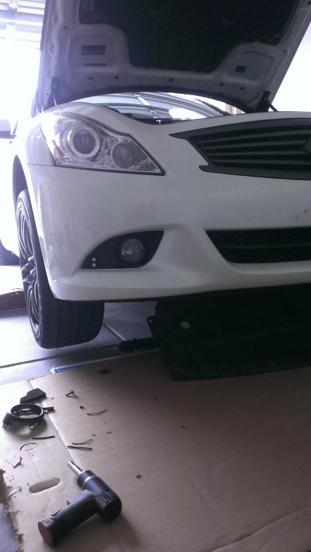

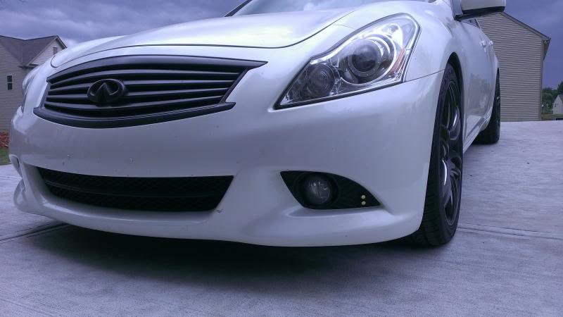

Hey whats up, I decided I would go for a custom look for DRLs. I went with 4 eagle eye 3W units, and they came from Ebay at $15. I also installed these directly to ACC surce (hot in run), so they come on automatically with the car. Anyways, here ya go!

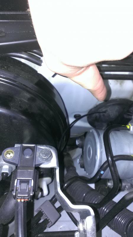

Ran a single wire through this driver side grommet, down to the interior fuse block and tapped into an acc source.

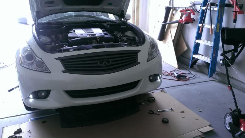

The entire install was spent laying on cardboard, wiring everything up. I grounded all wires to existing ground spots. A couple zip ties and its clean.
I like this setup because I can add an additional eagle eye 3W light if I wanted 3 bulbs.

Kudos for the clean install. Looks nice.
My .02 cents...it may be the pic or the lighting, etc.....but they look a little dim? Maybe adding a 3rd would not be a bad idea...

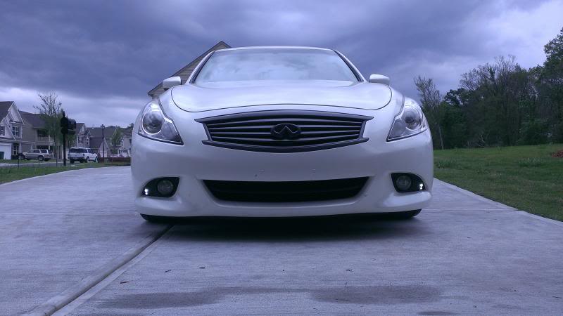

Ah damn. I put the wrong symbol. Should be <$50. Hey mods, can you edit my thread title to say less than $50??? I spent $15 on a set of 4 lights, and a few bucks on some wire and connectors.
I may add additional ones not sure yet. They are pretty bright though, the second pic is with them off. Will update later with a night pic.

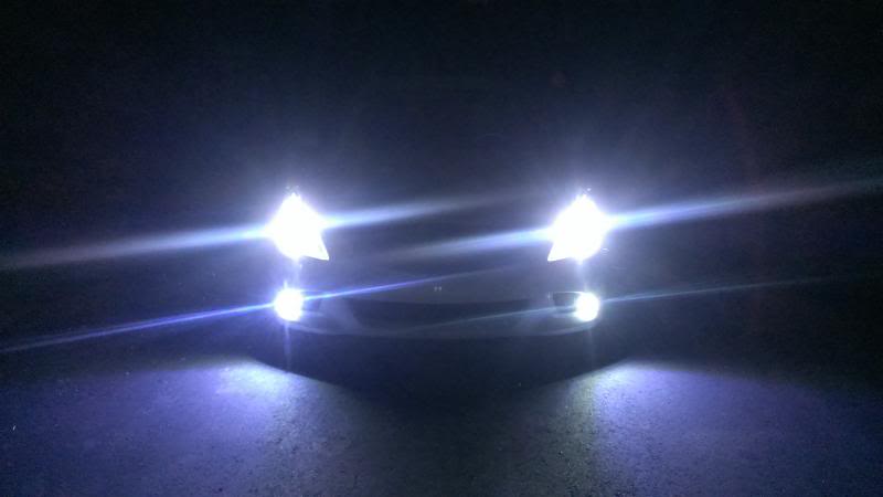

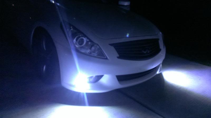

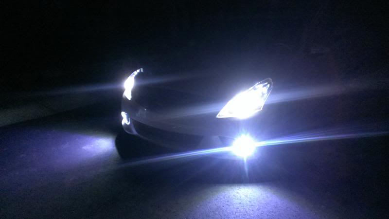

Night shots

Looks plenty bright from those pics, pretty impressive. Oh and I changed the title again switching the > for <, lol.
