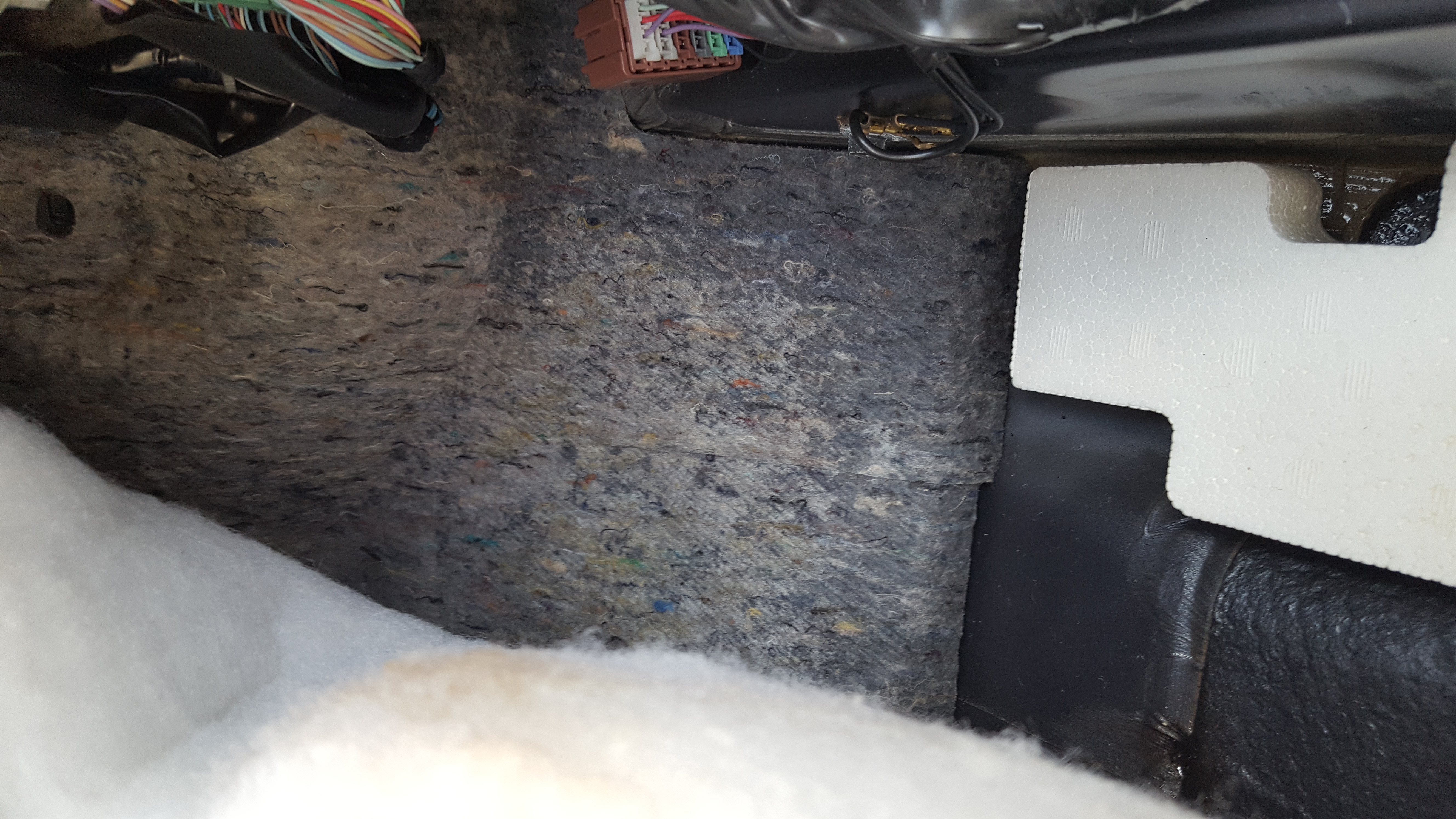

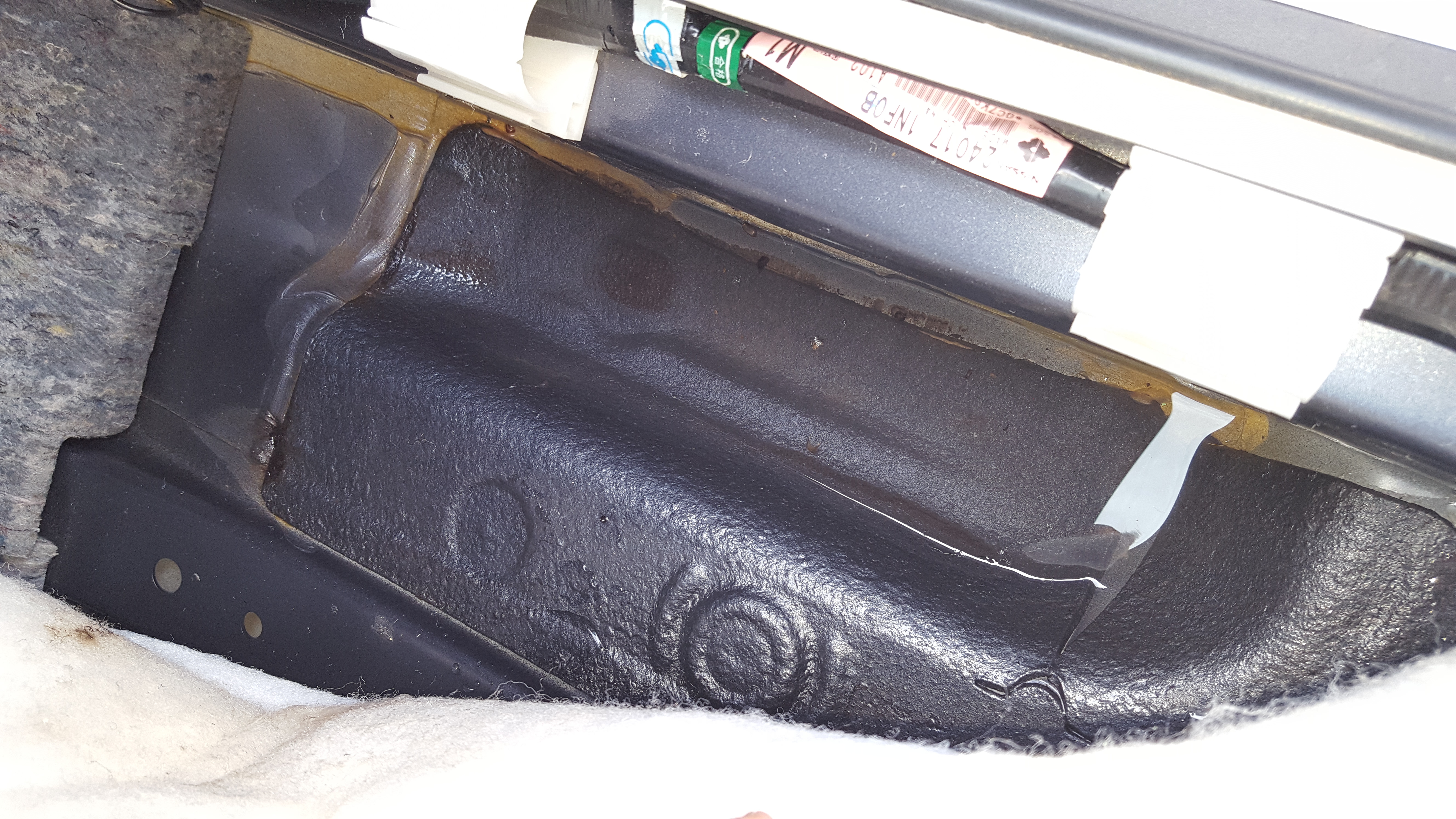

Alright friends, I've fixed drain tube some time ago and was waiting for the heavy rain to check my work results. Yesterday was that day. I opened the door and saw the same picture as always after the rain. Water was on the passenger floor mat but I thought I fixed that. That's mean that the problem is in something else but I don't have any ideas. Maybe someone knows what's the problem?
