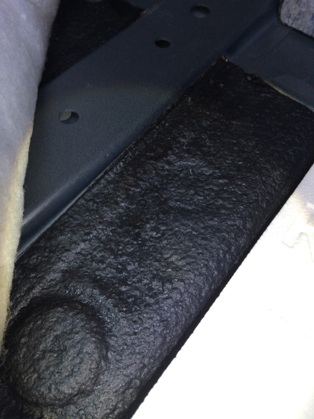

Originally Posted by JohnnyD
I have not checked the AC drain but there was a puddle under the passenger side of the car. Wouldn't this mean it's draining correctly?

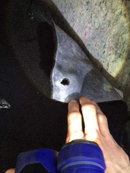

It could be clogged. I read a couple of posts from the 350z forums where people had puddles in their passenger footwell and it was due to a clogged AC drain. They had to pull the carpet up to unclog it though.

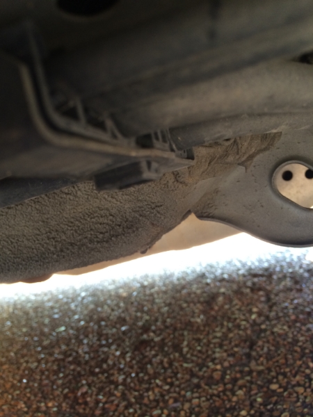

It was Saturday when I made my leak post, today is Monday. It did not rain yesterday nor today. I haven't driven the car since last night.

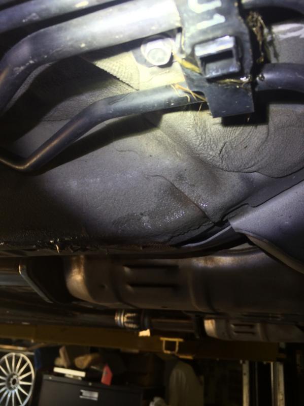

With that being said, I jacked it up looking for the drain, and it caused water to trip out of the same location as '11G37S, the rails. I didn't find the actual drain itself as I didn't want to crawl under the car without jack stands.
drips (out of focus)

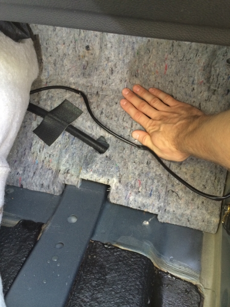

So I dove into the interior and pull a bunch of stuff a part.
This is pretty high up on the carpet and felt damp.

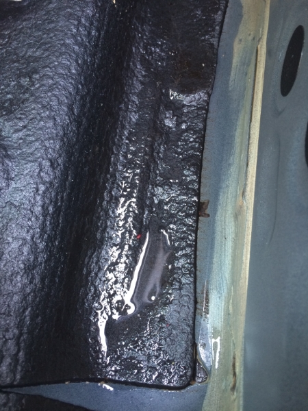

Then I remove the white foam piece to the right and see this.

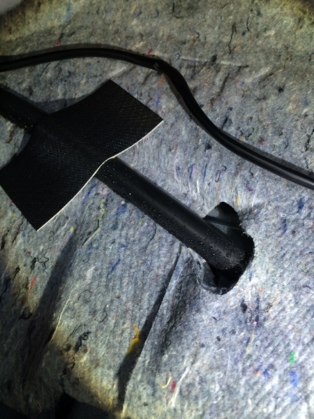

I'm guessing this is the infamous AC drain, it's wet. Could be condensation? Hasn't been used since last night.

Because nothing seems to be wrong with it. Also the area above it is damp, where my hand is.
I found the drain to be in front of the rail that it drips down to and towards the right hand side a little bit. There was a hole a little bit bigger than a quarter and if you shine a flash light up there you can see it offset a little to the left hand side of the hole. It wouldn't have cost Infiniti/Nissan anything to make the tube a little longer to have it actually drain out of the hole in stead of it dripping down into the rails.

Ah, Ok I think I know right where you're talking about. Yeah what a horrible design. But, I do not think this is causing my leak? Was that in fact the AC drain hose under the carpet I pointed out or is that some other drain? If that area was leaking under the carpet how would my side panels and top of my rubber mat having sitting water?

Yes, I believe that is the AC drain hose. I'll have to take a closer look at the pictures when I get home, since it's difficult to see on my phone.
