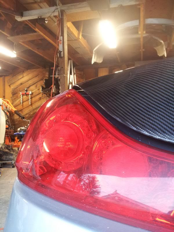

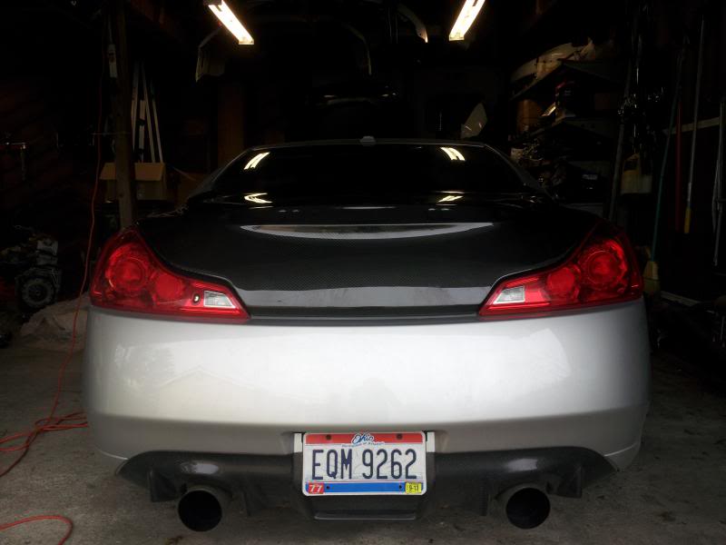

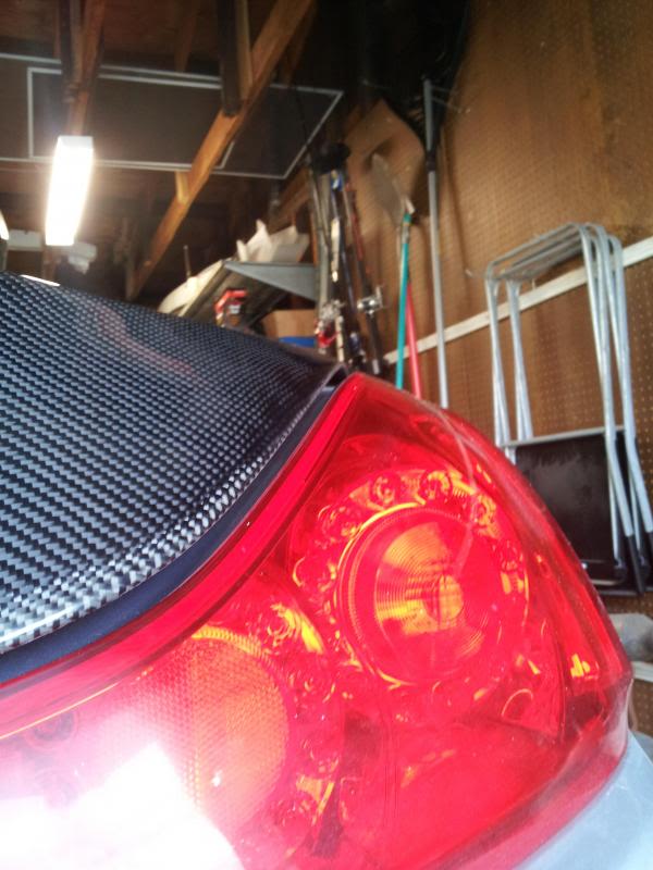

i recently procured a carbon fiber trunk and upon trying to install it i noticed the passenger side fit like a glove, however the drivers side......not so much.
Passenger side....
Driver side....

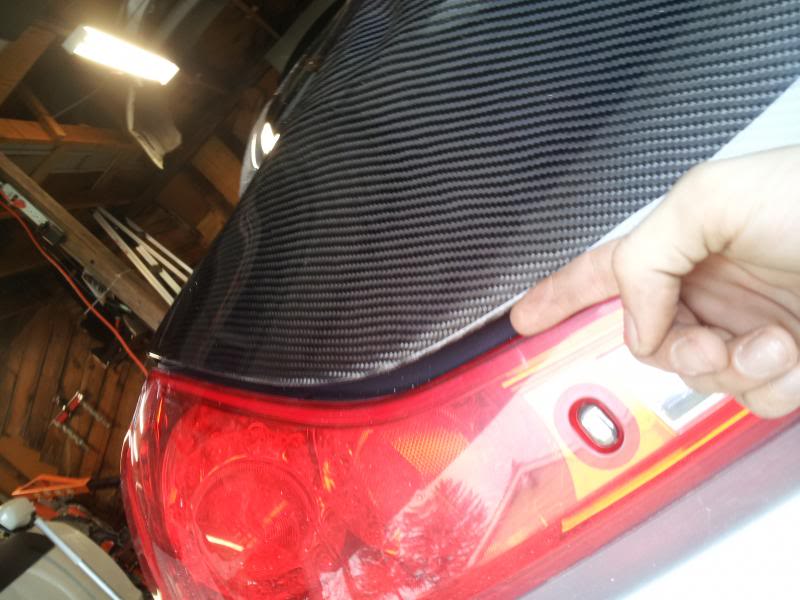

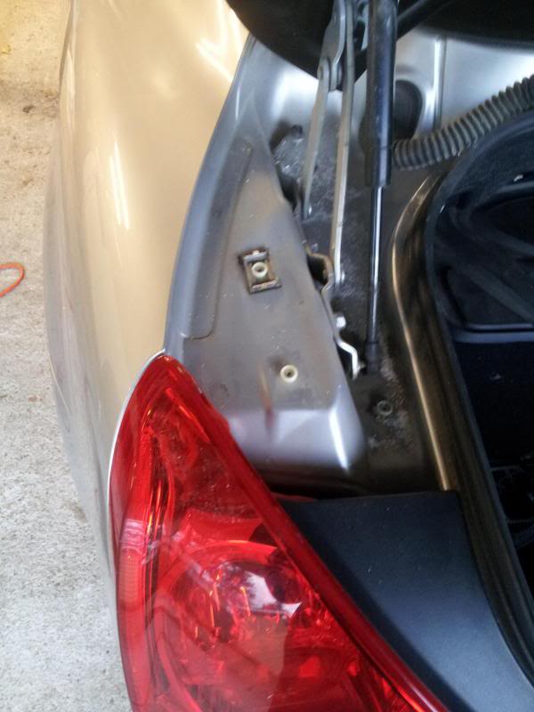

My idea is this...
drill into there for pins and crank down the drivers side, it looks about right when i put pressure on that side. i contacted the seller for an exchange so we will see what happens before i go drilling anything...
input welcome

Not that this will make you feel any better but I've seen this kind of difference in panel gaps on my friend's brand new Jag.
Old Apr 24, 2013 | 10:04 AM
Presto's Avatar
Presto
Joined: Sep 2009
Posts: 1,112
Likes: 73
It's the traditional seibon gap.
Old Apr 24, 2013 | 12:08 PM
Fico's Avatar
Fico
Posts: 171
any known fixes? they are telling me to put weight on it and let it bake in the sun for a day or two....

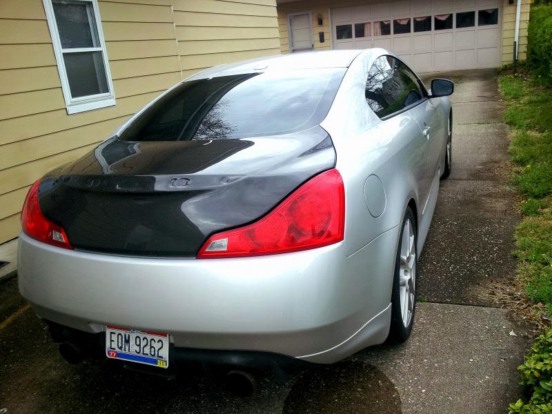

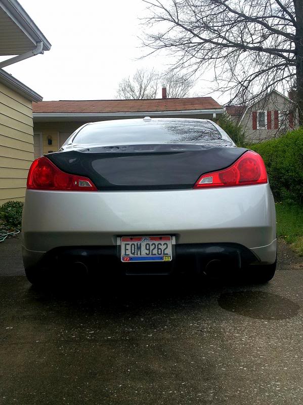

Old Apr 29, 2013 | 03:37 PM
Fico's Avatar
Fico
Posts: 171
So this is what i was able to get out of it. maybe with some warmer days i can put some pressure and smooth it out a little more...

remove the gas shock on the left side. it's a cf trunk.. you don't need both.
fitment is fine if you just do that. Also, adjust trunk latch and move it lower. That way the trunk will have to sit lower in order to latch/lock itself.
Old Aug 15, 2013 | 12:46 PM
Fico's Avatar
Fico
Posts: 171
I have tried both off, one off, both on. nothing makes it how it should be unfortunately. I have the latch adjusted as low as it will go.
I may have to modify the latch with larger holes which is my next step.
putting weight right on the corner above the tail makes it sit right so I was thinking trunk pins "IF" it comes to that...
