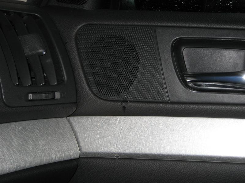

I was just looking at the car and I wonder if the problem is the rubber that is around the tweeter which actually presses against the rubber molding that runs the length of the door.
Because when its leaking it looks like water is under the bottom of the tweeter and it is coming out from there. Just a thought.

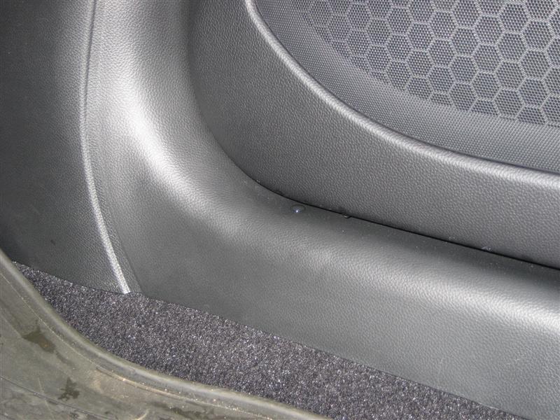

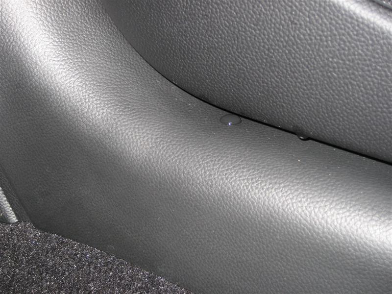

had the seal replaced and dealer said they fixed it. yeah looks like it. this was only a short time sitting out in the light rain and had not been driven. hey cnagy65 if they find a solution for your leak let me know and maybe i can point the dealership in the right direction!!! thanks

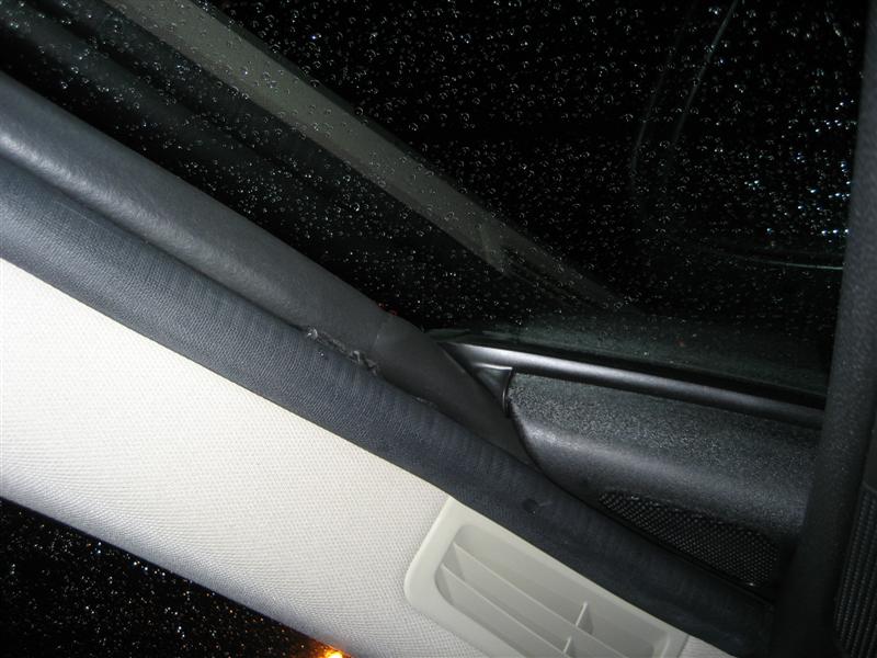

The dealer took off the a-pillar and they noticed that Safelite broke the clips and tried using adhesive to fix it. It was also missing a couple of screws that hold the drip rail in place. Also the replacement windshield had a dip in it.
I had to go back to safelite. They needed to order both a pillars and molding and all new clips, and I am making them replace the windshield also. Just waiting for the parts to come in.
I am hoping with all the new parts the leak will stop.

Well its been raining for a couple of days now and the car is not leaking.
Don't know if it was the new window or the new A-pillars and having all the screws holding the drip rail in.
Seems like I'm getting more noise now with the new window, (could also be coming from the rubber molding around the door, can't really tell and they didn't replace them.) or it could be just my imagination.
As long as the car is dry inside, thats the most important thing. Plus I don't think I want Safe-lite to touch it again.

Well it leaked again in the pouring rain and it was very windy. Its not that bad this time. Not dripping down the door, Just water at the base of the tweeter where it meets the top of the door sill.
