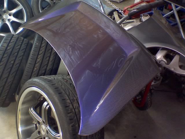

Here is a G35 guy who did a chameleon coat on the cf. He said it was 3 very light coats, clear, 1000 grit flat sand, clear, buff.

I am pretty sure it is a red ghost paint job.
1. I dont believe Seibon does red cf
2. Red cf gives alot more of a red look
